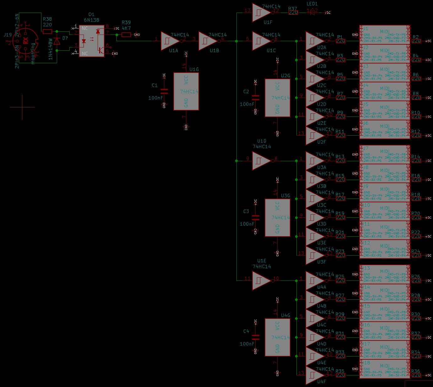

i need to handle up to 16 (MIOS32) Devices, The OUT >>> Thrubox is the simple thing (i think), is that Shematic correct? (ignore the boxes on the rightside, these are Shroudet Pinheaders to cable my devices with Ribboncables…since that is cheaper then the DIN-Thing)

Except that I pretty sure you can remove some of the schmitt inverter buffers, you can do this. :wink:
If the target MIDI devices have different MIDI channels they will receive separated Voices messages.
If the target MIDI devices are some midibox cores then just change their ID, as they can receive different SYSEX too.

Ah… i thought they have to be inverted back, thinking of the signal is 180° “inverted” and has to be “inverted again”…
(yes Midibox cores…) Good to know that the ID will manage the Sysex “Channel”!

One buffer can support 12 input buffers, without too much capacitive load. Almost if it’s on the same board, I’m pretty sure.
