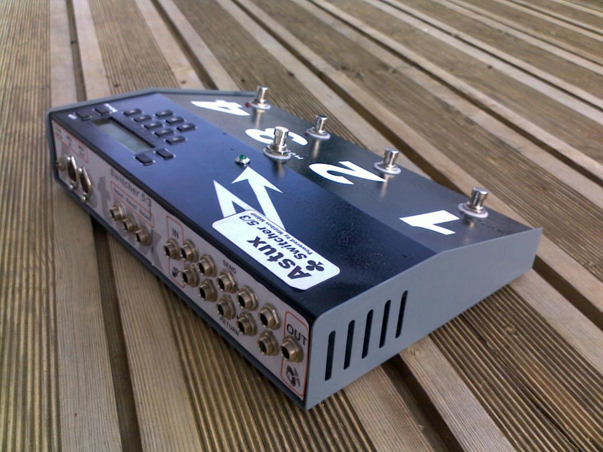

Hello,
I’ve almost finished a guitar fx looper (which would need a major wiki update…), and i’m wondering if i could add a tuner to this box. As i’m not using any AIN, i have all the analog pins free to use. I think that the 10bits conversion is enough to have the guitar signal.
