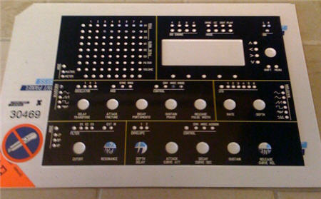

Yellow sounds nice. Pictures?  :smiley:
POIDH
POIDH
x2
Not much to show since I haven’t built the control surface yet, but here’s an image of the front panel.
The plan is for yellow LEDs, yellow display, gray Albs knobs.  For some reason the gray + yellow makes me think of a neoprene wet suit, but hopefully it will look good on my MB-6582. :slight_smile:

Gah!!!  I spent an extra $5.98 by going with the medium option instead of the cheap option?!  Argh!  :slight_smile:
It took me a while to pick through the three files so I’m surprised I didn’t notice that the cheaper one would have worked.  At any rate, the panel came out perfect, so I have no complaints.
