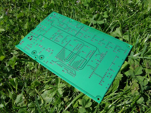

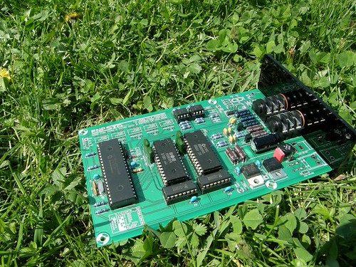

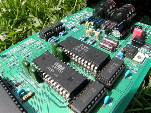

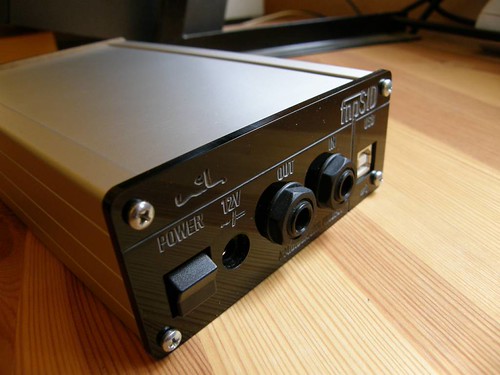

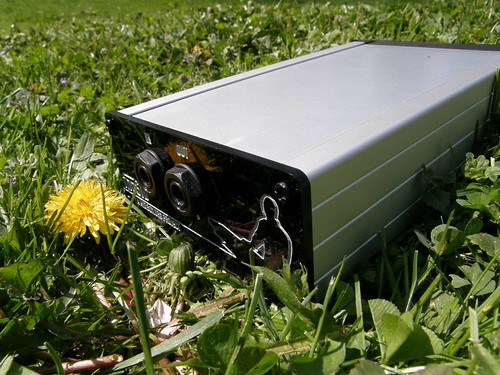

Flexinoodle and I recently finished our collab: the fnpSID. It’s a stereo mbSID v2 with added gm5 support for easy PC<->SID connection.
  • The pcb is basically comprised of a core module , a gm5 module and two sid modules and 5 banksticks.
  • It runs off a single 9V-12V AC/DC wallwart.
  • Since the gm5 gives us 5 IO ports, you can hook upto 4 other MIDI devices up to it.
  • It has the option of linking together multiple of the fnpSID PCBs to allow for either multiple stereo synths each as their own MIDI port, or linking the PCBs via CANbus.
  • Up to 2 of the PCBs can be fit into a single case , turning it into either a 2x stereo SID or a Quad SID setup :wink:
  • To keep it as simple as possible the pcb does not have headers for anything else than needed - producing SID sweetness.
  • In the beginning we were a bit worried about the SNR with the usb and single supply PSU, and I went a bit overboard with bypass caps. But the result speaks for itself:
    Wilba : f*ck man that snr is sick
    nILS:“puking baby”-sick or “phat maaaan!”-sick?
    Wilba: like pretty f*cking good
    Wilba: is like my mb6582 without the cs :slight_smile:
Working on this little beast was a lot of fun and Flexi and I really like the results :wink: We would like to thank TK for this incredibly nice project, Wilba for being a third pair of eyes with major pcb OCD and building one of the 3 prototypes and everyone else who made this little toy possible!

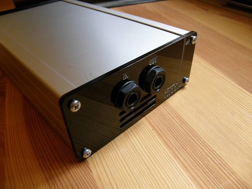

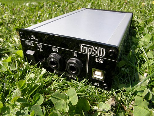

Very nice! I really like the compact design and the enclosure.
How much did Gold Phoenix charge to do those 8 PCB’s? How did you get the front and back panel’s cut?
The panels were made by http://www.ponoko.com/. The PCBs were the regular “special” pricing deal from http://www.goldphoenixpcb.biz/

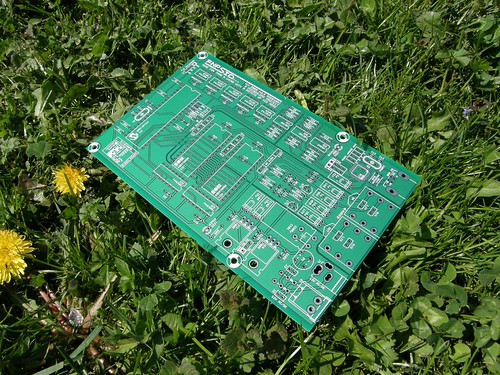

Do those capacitor footprints allow caps with 2.5mm or 5mm lead spacing? Brilliant idea! *cough*
Hehe, yes. And the filter cap positions match the filter caps on the mb6582 and the filter switcher pcb :wink:
