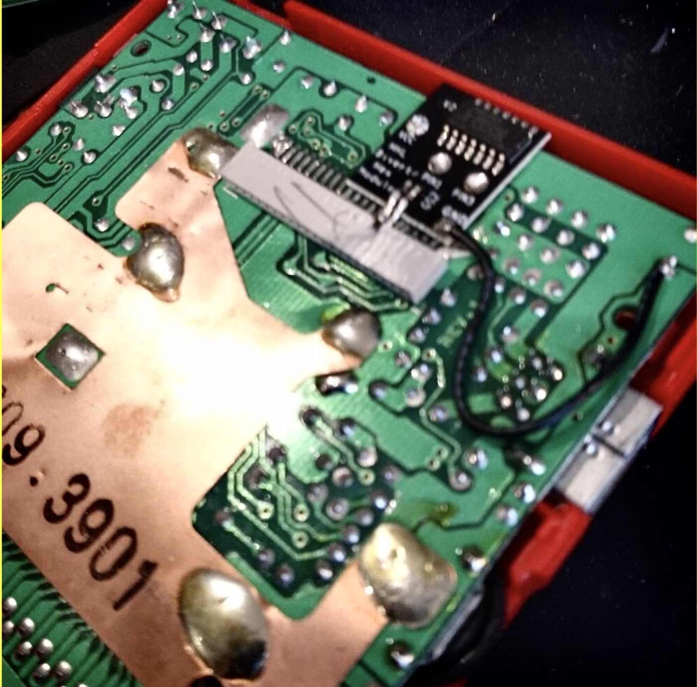

I bought the gameboy amp, too and wanted to built in but it is just for amplifying the speaker, not the phone output, right?

Re: The Gameboy, the pic you linked is a bivert board (to increase contrast on the backlit screen by flipping the pixel polarity)
You can get a replacement headphone amp for the old nintendo one (which is really noisy), but if you have a mixer it is just as easy to cut a hole in the case and put in a new headphone jack, and take the signal from before the headphone amp - the “prosound” mod.
Makes the signal much clearer if you want to record it into a DAW or use it live.
that’s what I’ve done in this image:
(there are actually some even better earlier points to solder to that are before the volume wheel as well (that’s quite often a bit crackly as well, plus it means you can turn the speaker down whilst still having the gameboy come out of the mixer.)

Yeah, you’re right, I did the bivert mod, too but mistaked this with the amp ; /
Thanks for the Info about the headphone mod.
