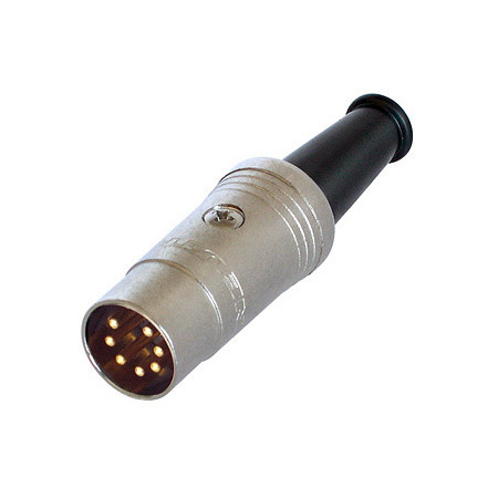

In terms of the PCB mounted power connector, that option is really up to you, but to keep the retro spirit alive, many have chosen the 7-Pin circular DIN, which is what the original C64 used.
https://www.aliexpress.com/item/32981543684.html?spm=a2g0o.productlist.0.0.140c60d5kCwIHg&algo_pvid=feec72e8-76ab-4f5b-b02b-a65975ddf4f1&algo_expid=feec72e8-76ab-4f5b-b02b-a65975ddf4f1-2&btsid=0bb0623316152126363434357e0c5f&ws_ab_test=searchweb0_0,searchweb201602_,searchweb201603_
If you go this route, you’ll also need to swap the tip on your power brick with a 7-PIN male DIN receptacle. Rean makes a good quality one that’s readily available.
https://www.mouser.com/ProductDetail/REAN-Neutrik/NYS323G-U?qs=%2B86TLfaev2%2FQ5iVm8npeOw%3D%3D
