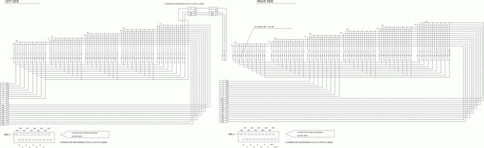

I’ve got a fatar TP40W right in front of me and I hoped, to get it running, by using the adapter-schematics on the ucapps_kb website.
But it seems, that the TP40W has another pinout than the other TP40s. I attached a schematic of the TP40GH.
As you can see, on the left side the connector is not fully assigned. There are two pins, which are not connected to the keyboard. On my keyboard it seems, that every pin goes somewhere. I attached two pictures of the left and right 20pin-connector.
