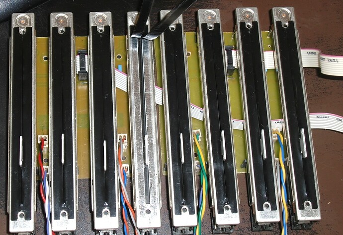

So here I am, with a new core, DIN, etc and yesterday I solder everything back for the motorfader. But they are not working very well at all. I have to put a “very” high voltage with the LM317 (between 10 and 12v) to get all the fader to move properly. With 7.5v, some can’t reach their target position at all.

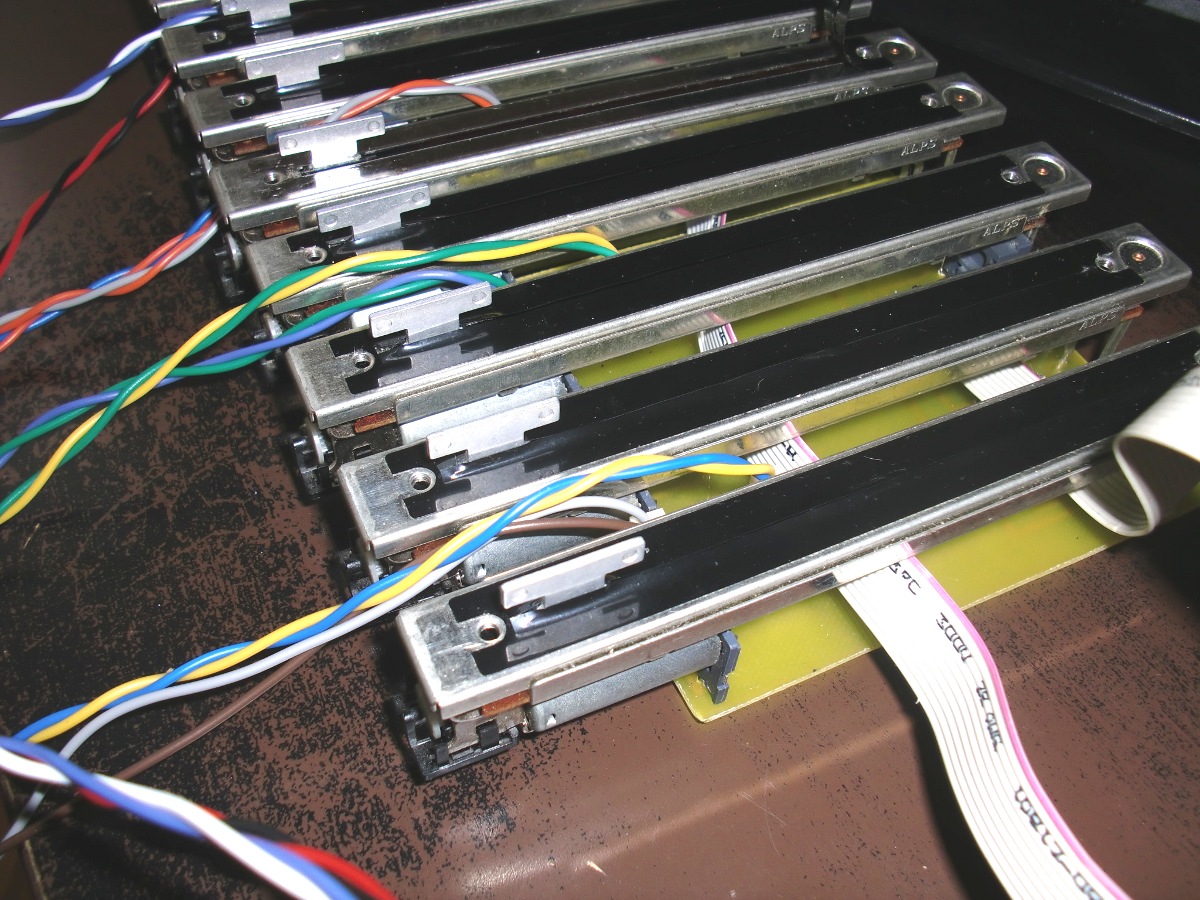

One behave very poorly, and I notice that the dust cover seems to block it (during my old test, I tried different setup, building a frontpanel from cardboard to hold the fader, and maybe this has made the plastic film to go inside the fader slot). So I tried to remove it (the dust protection) to see if it makes things work a little better. And that’s what happened. The worst fader, without protection, moves really well compare to the other.
So here’s my question : do you think I can remove this black plastic on every faders without decreasing their life? (Yes, I smoke…).

Here’s some pics of those faders
That should actually not be a big deal. If in doubt, place a dust cover over the unit whenever it is not used and you’re as good as with these plastic things.
