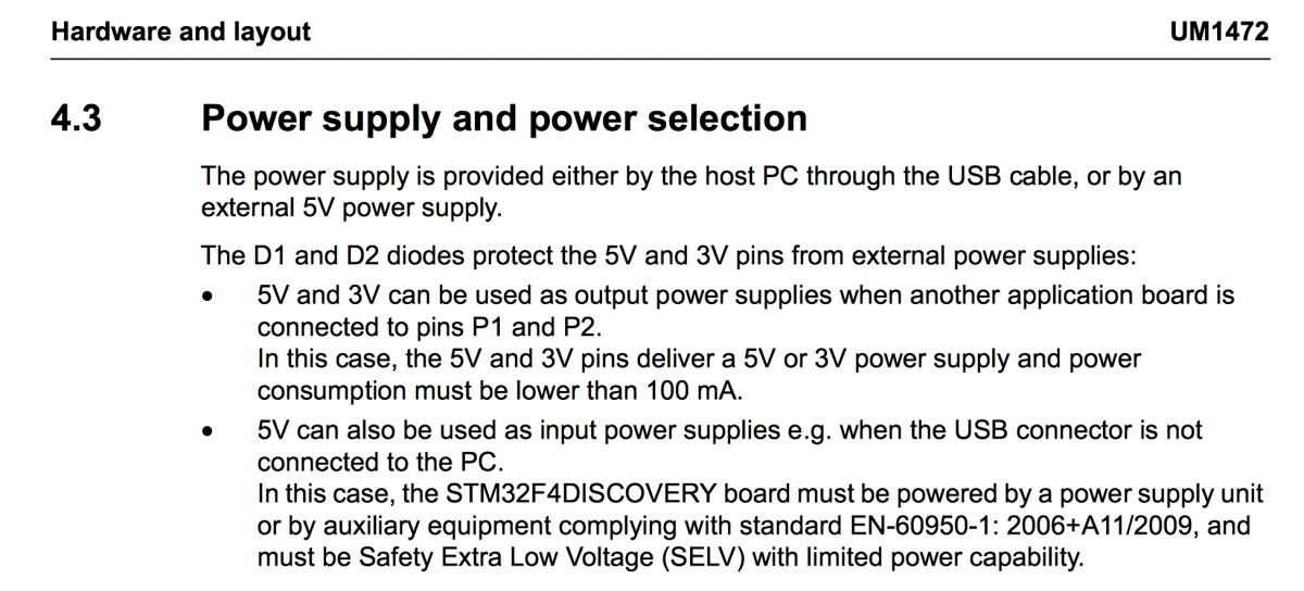

second question is about STM32 supplly
I plane to use external 3.3v, 5v, and +/-15v (for AOUT and my motor driver)
I’m fine with the STM32 J2 description for 5v supply, but i don’t understand where I plug 3.3v ?
and last… i can’t find any specification for all J connector regarding pin n° and function, the GND usually use pin 1 and 2 or 9 and 10?

Hi Zam
The 3.3V is generated automatically inside a STM32F4Disco if you use that. The Chip it self doesn’t do that.
from this document: http://www.st.com/st-web-ui/static/active/en/resource/technical/document/user_manual/DM00039084.pdf
not sure if i understand you right…
The Core PCB related J Connectors are described here: http://ucapps.de/mbhp_core_stm32f4.html
In the schematic of the core you can find the Pin assignment.
best regards
novski

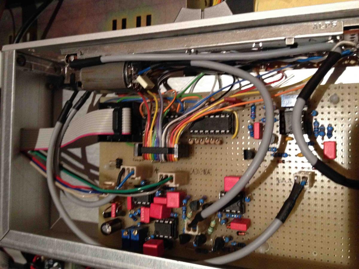

Hey
some update
The analog PI driver work !!!
I have little hard time, with some error, and burning part, but i’m close to have a perfectly tuned motor driver and safe design
IT’S F…ING SILENT at acoustic side I mean, I don’t plug it in the desk so I can’t tell for the crosstalk at the audio analog side
I will add pic soon :slight_smile:
Zam
