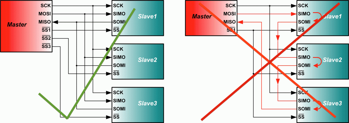

Both of these devices are connected to the core with SPI. While I have been try to get them both to work at the same time I have learnt that SPI can be connected in two ways, “Star” and “Chain”. The SD card socket and ethernet module need to connected in a “Star” configuration in order to work.
Basically the two devices share Serial In (MOSI) , Serial Out (MISO) and Serial Clock (SCK) signals but each have individual Slave Select (SS) signals. The attached picture illustrates this pretty well.
Thanks for pointing this out!
It could make sense to document this in the Wiki as well.
