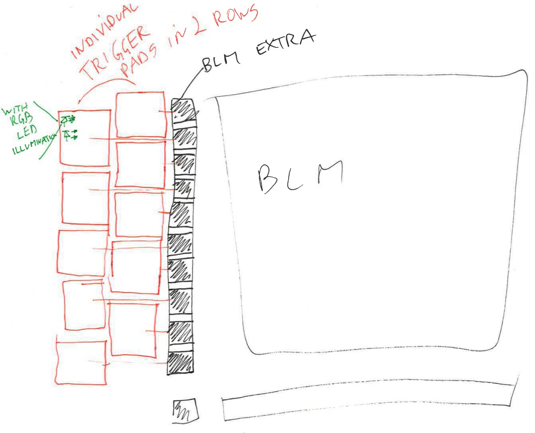

Drum-Trigger-Finger-Pads (beside BLM)
since my Steinberg PD is not working in HOST-Mode… i need some other way of sensors for my sequencer…
since i programmed the sequencer in a logical “Matrix” way - it would be finde, if the triggers for the tracks are in a line to the tracks.
would be nice if they are some kind of transparent to indicate drum trigger. but that is no must, the BLM Pads itself are already indicateing 3 Step Velocity (<=45 blue, >45&&<90 green, >90cyan)
They must be velocity sensitive - and placed seperately (so i can choose the space between it)
any idea?
i know the Akai MPC replacement parts, but what i see the availables are 4x4s on a singel foil… — only to know >  how can they be connected to a MIOS32 Core?.

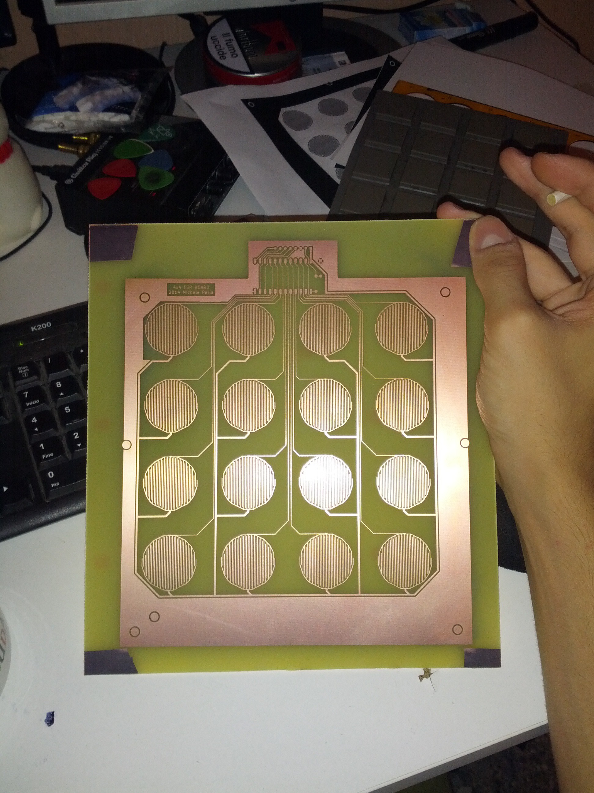

I remember a drum pad controller with piezo elements fixed to the back. I think it was 2*8 pads with only 3 disks to get the general area (obviously sampling in tandem with a drum hit).
Could it work with a scaling circuit and a good/good enough ADC? Even 8/16 levels might be enough. Quick google shows MPCs use a kind of force sensing resistor directly on the pads.
force sensing resistor…
He
.https://hackaday.io/project/1601-diy-usb-midi-controller-mpc-style
is talking about a copper Grid like this: (kicad files aviable)
then a Layer ungluable “VELOSTAT”
then the Physical PAD that transport the Force from Finger to Velostat…
The project looks good documented…and i could design the Triggerpads exact the size to fit well next to the BLM…without those expensive MPC PAds.
