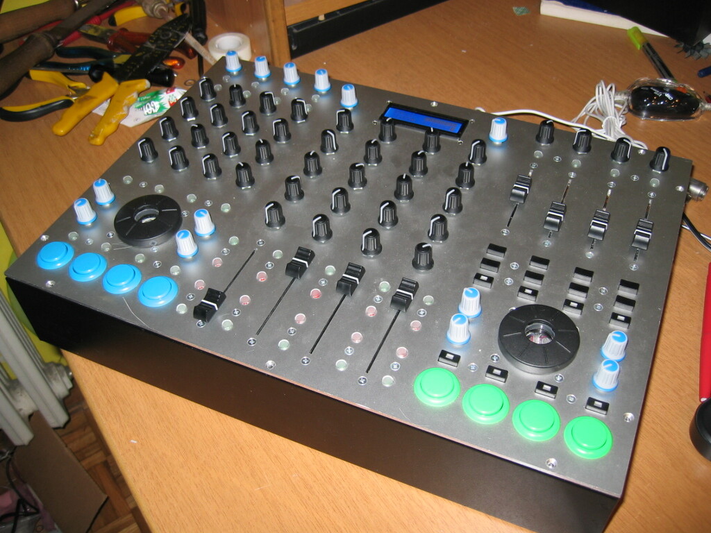

I built a midibox64E with 64 button, 48 pot, 14 encoders.

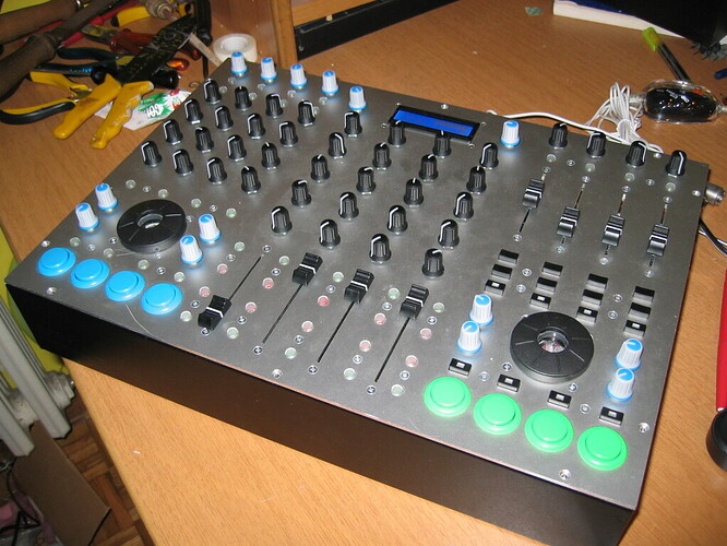

Ok I solved!
I used vmidibox64e sarge editor. in the led option i put the midi status rec.
WOW my box is finishedddd :)))
