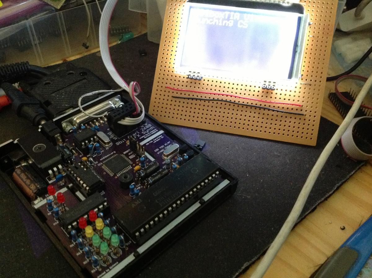

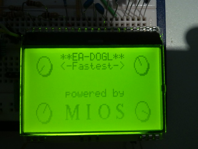

I use the EA DOGM 128-6, it’s a little smaller than the DOGL
do I need to change anything?
It looks to me as the icons and characters are a bit “squashed”
No that looks fine to me, it’s still 128x64. The large GLCD font is a bit squashed anyway, it looks just like my DOG-L displays!

I looked in the papers from EA, and the DOGM pixels are 0,42x0,36 mm, DOGL 0,50x0,46 mm
I made some custom icons, and a square icon that’s 24 pixels high, needs to be 28 pixels wide to look square
Thanks for the driver Phil, these displays are great :slight_smile:
