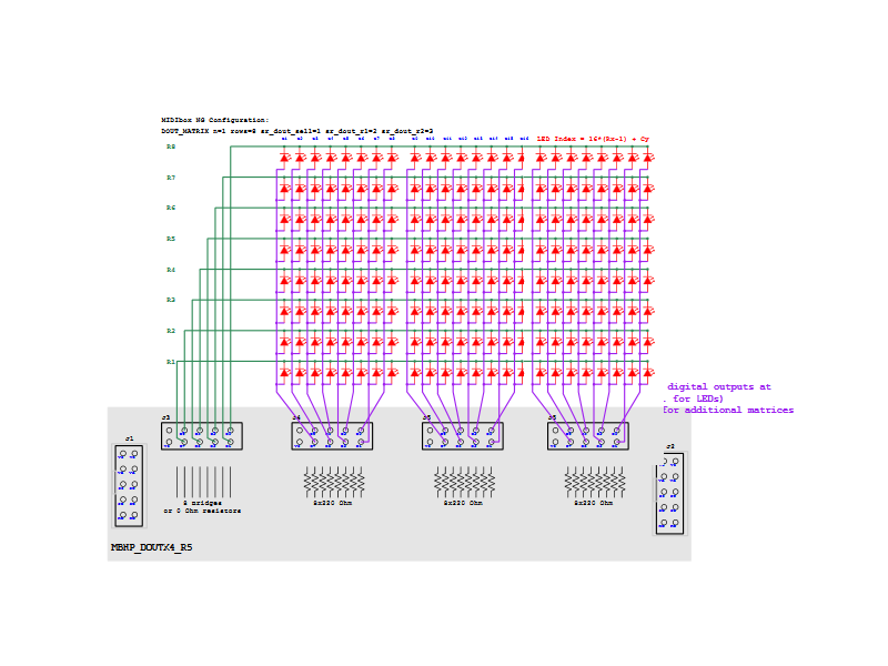

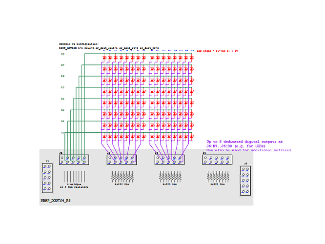

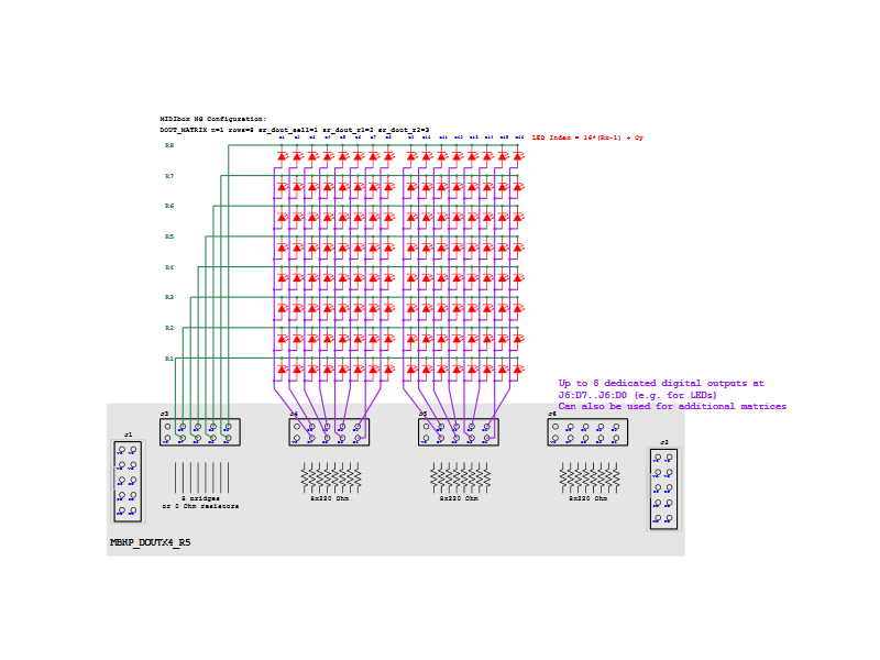

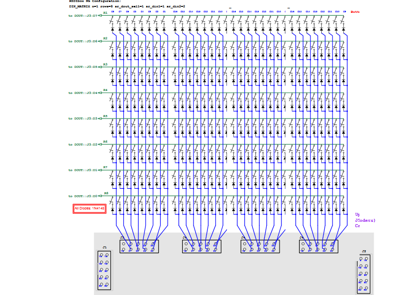

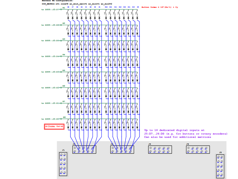

Does this works as the pictur shows:
Just copy/paste not redraw..
You can chain DIN/DOUT no problem.
