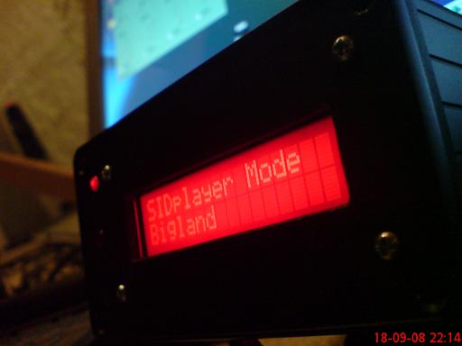

Hi there i’m Jay, finished building my MidiboxSid a few weeks ago :slight_smile: So excited when it arrived i had it built and working! in just a few hours!

Nice lookin midibox! MBOTW? Got better pix?
Seconded

Thanks for the compliments on my box, i shall post some better pictures when i am back at home on monday.

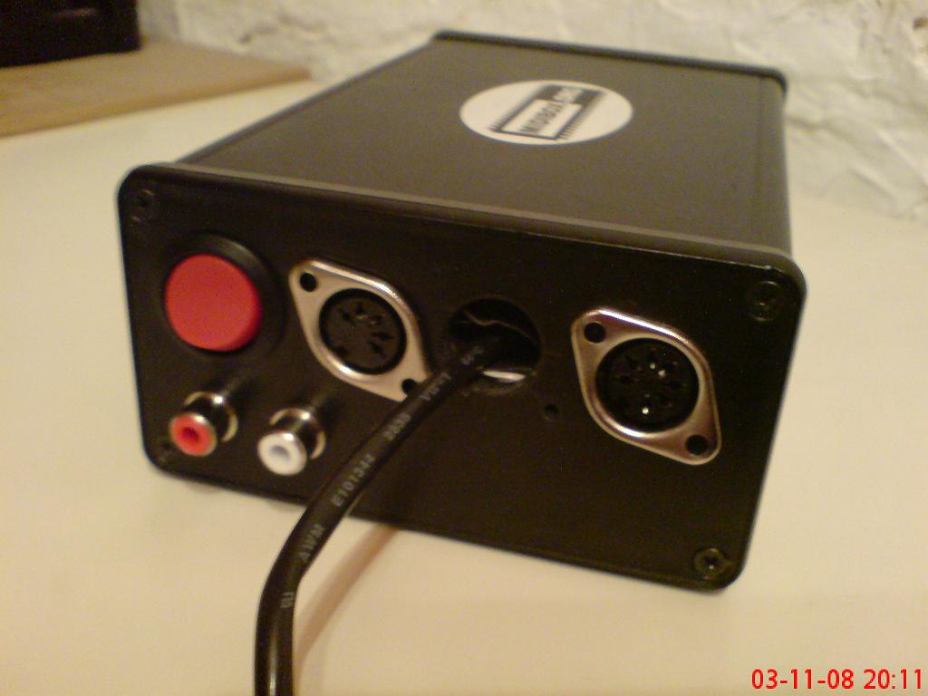

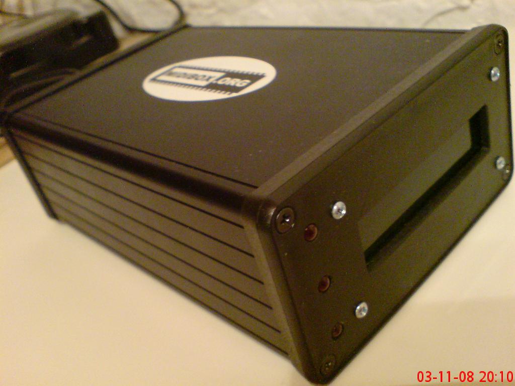

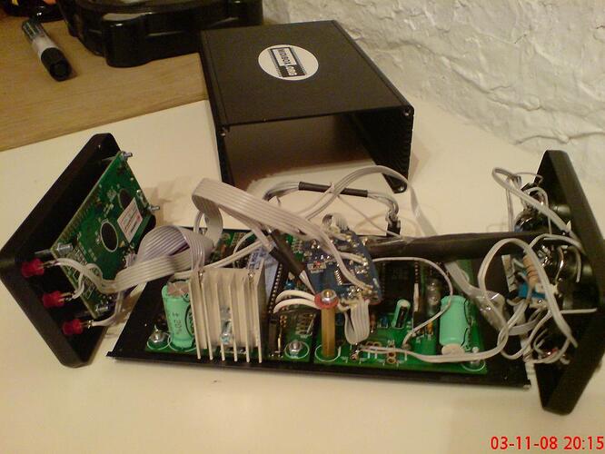

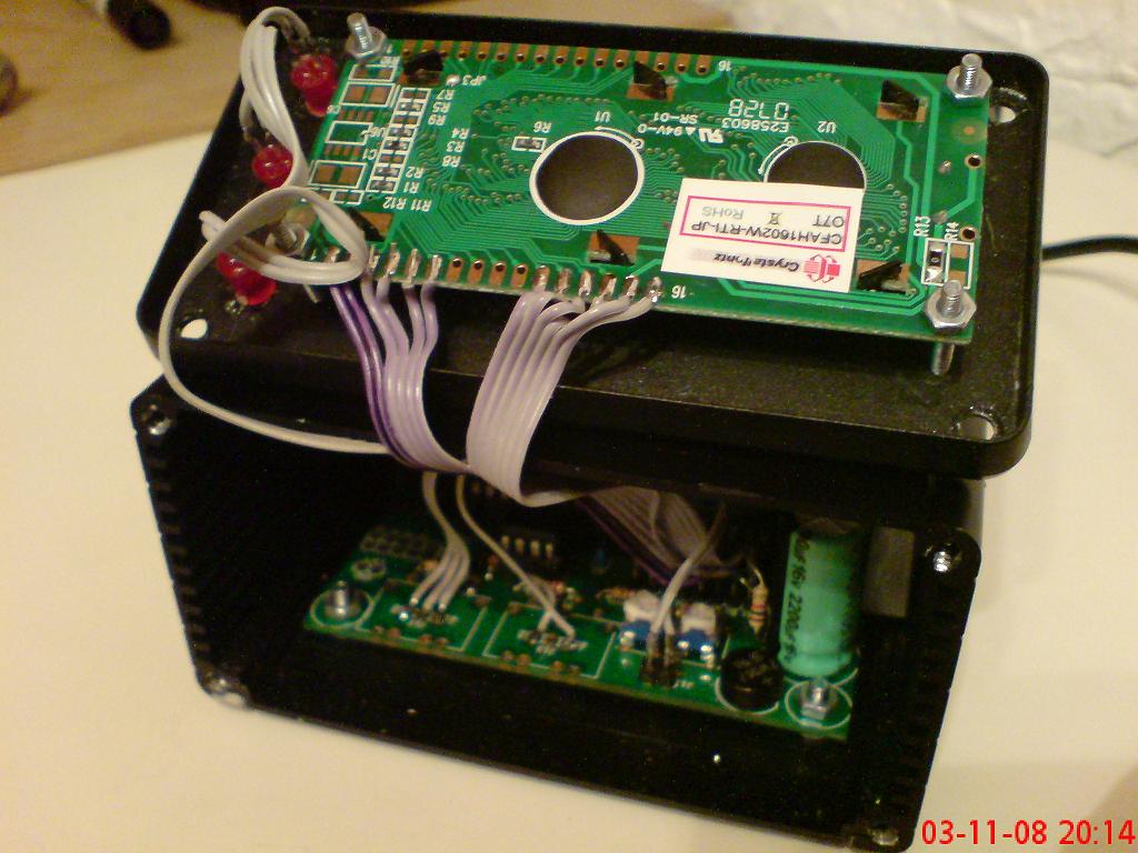

Heres a few more Pics of the box (and the birds nest that lies within :-[), the back is not quite finished yet.
