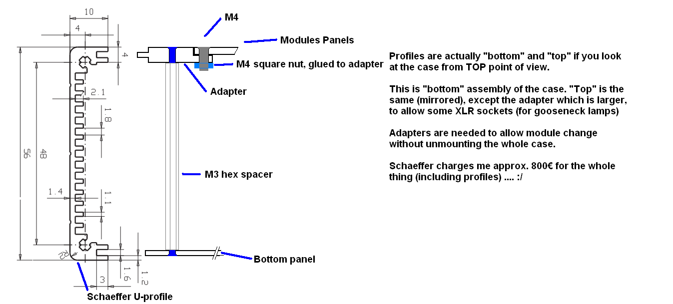

Hi there,
I’m designing an enclosure for a modular project, after having read Schaeffer’s “Manual for housing assembly”
What they call “Top cover panel” will actually be used as my main area (top).
2 x 65cm Schaeffer side profiles
5 x front panels (13cm x 26xm each, 2mm thick) = total surface 65cm width x 26cm height (Each front panel has 4 M4 mounting holes)
2 x 4mm / 10mm / any thickness side panels (with radius angles)
2 x “Adaptation panels”
Adaptation panels are 65cm x 4cm, 4mm thick, with cavities to fit Profiles on one side, and Module panels on the other.
Below is an illustration (made with paint, sorry) to explain how I plan assembly.
The problem is the price of the whole thing: 800€…
It’s my first enclosure design, so I might miss the point about how to build it without selling my organs.
I already mailed all my files to Julian F, he told me I could save some money.
Do you guys have tips to make such a case, cheaper ?
Bended metal ?
Thanks.
