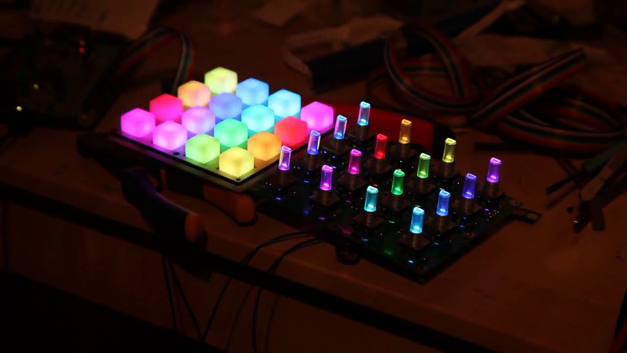

While not LED rings, I have some 4*4 encoder boards that use WS2812 LEDs. The simplest MIOS implementation fixes the colour (as RGB or hsv (better)) and uses the level/brightness to indicate the CC value from 0-127.
I have two types available; a simple one with just encoders, and a more complex one that uses the 45 degree displays (as part of MBProgramma v2). For buttons, there’s a 4*4 matrix using the same programmable LEDs and Sparkfun button pads.
Feel free to shoot a PM if you’re interested in getting some or you want more info.

Most of the discrete SMT is for touch sensors (here they are single metal plates), so if you just want the displays + illuminated encoders, the assembly is very straightforward – shift register chain and some 2*5 headers.
