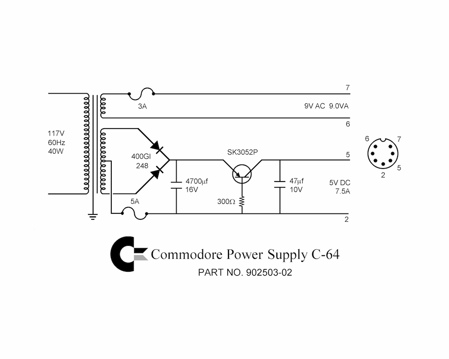

I did run across this schematic of the inside of the C64 supply, although we don’t need that much amperage.

That psu schematic you link to i havent seen before, but it will not be good enough as a full featured custom psu for the mb6582 i think. It has no 12v wich is required for 6581 sids. You will also have to depend on more circuits inside the synth to work. Also i cant see its regulated in any way and as far as i can see it has no other overcurrent protection than regular fuses. I guess if this actually is a real diagram for the c64 psu some protecting circuit is designed into the c64 itself.
This design differs a lot from my design and cant be used for what i plan, but it may very well work for some boxes. I havent studied thw different psu options for the synth well enough to say if this is good enough…
