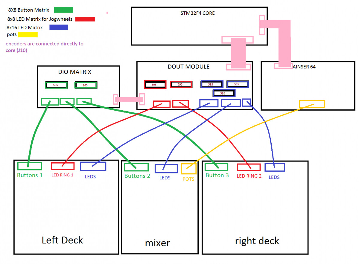

Ok, just going to bump this post to post a diagram of my connections to make sure I havn’t made any mistakes as getting my head round this was a bit confusing:
(I apologize if this is too big)
I’ve drawed a diagram to show what is going on, essentially I have now:
-one 8x8 button matrix
-one 8x8 led matrix for 64 jogwheel leds (32 on left and right deck)
-one 8x16 led matrix for panel illimination leds (so about 128)
-encoders connected direct to core:
The connection diagram is not detailed enough for a confirmation.

Best Regards, Thorsten.
Ah perfect, I’ve been looking all over for examples!
Will have a look at these then draw up a new digram
