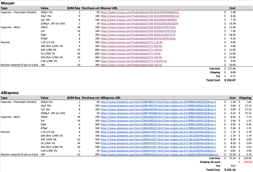

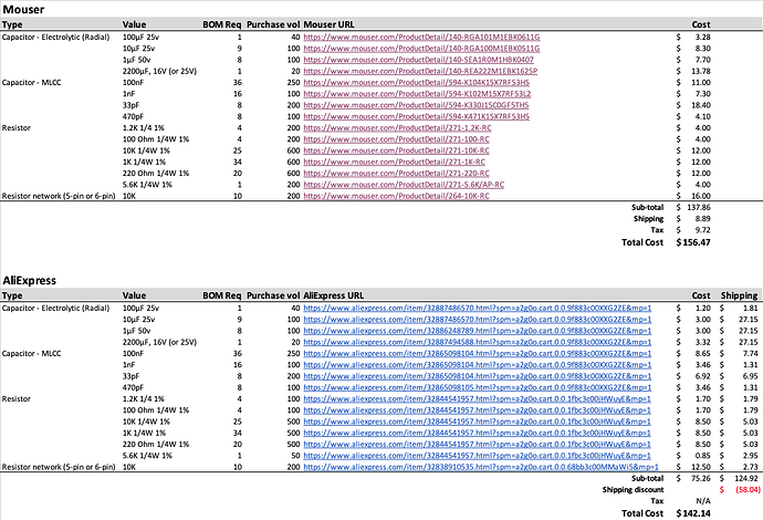

For the most part, I’ve been sourcing my components from either Mouser and or Digikey, but lately I’ve started placing one-off bulk orders with AliExpress.
You can typically find what appear to be great prices on larger quantities of discreet component, but then there’s always that large shipping fee (at least to the US) and the significant wait time for deliveries (which typically take 4-12 weeks in my experience).
So, I decided to take a look at some of the components I need for a particular BOM and compare the actual costs, side-by-side:
In each case, I tried to source the cheapest components from reputable suppliers with the most positive reviews and feedback.
You’ll notice that the volume and quantities aren’t exactly the same for all items, since Mouser required some minimum qty. for certain items.
But in the end, the cost delta worked out to only be  around 9%, so I decided to stick with Mouser for most of this order and benefit from the trusted quality and faster shipping time.
Apologies if this is stating the obvious, but the exercise was helpful for me, so I thought it was worth sharing.

For me here in the UK the pricing and MOQ meant that i had to get a lot of things either from ebay or ali express as the pricing in the UK was far too much. For example i wanted some 6mmx6mm square led tact switches, in the UK they were almost $5 each equivalent. I got them from Ali express for $10 for 20 of them. same with the mini 7 segments, encoders and components. In the UK its V.A.T on everything, then customs etc and forwaring postage costs with VAT added.
I just got a quote in for one of my pcbs, its a 4 layer pcb 250mmx250mm it was £90 for the pcb and then a further £140 for the processing, jlcpcb in china quoted me under £100 for 5 of the pcbs with shipping etc. I rarely get anything from the UK side anymore.
Yeah, it requires a bit of extra legwork with each and every purchase to find the best deal.
I’m not always willing to price compare for the smaller one-offs, but for larger BOMs in the ~$100+ USD range, the saves you can find are usually worth the extra effort.
