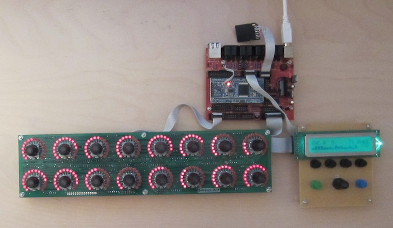

I got the ā€œLow-Cost LEDsā€ from Reichelt today, and the outcome was very good!
The brightness is perfect, especially against spotlight! :smile:
So: LED 3MM RT is the recommended LED
For the US guys: can you recommend a similar part from Mouser? The mcd value should be at least 10 (than higher, than better)

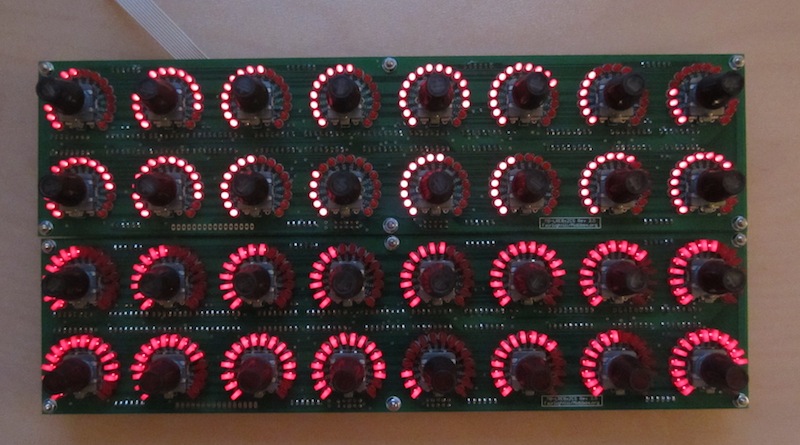

Here a direct comparison new vs. old LEDs:
Best Regards, Thorsten.
Is that the result with or without the ULNs installed?
With ULNs installed.
I haven’t tested it without (because I’ve no bridges ready), but I checked if it makes a difference if the resistors are replaced.
Outcome: 220 Ohm resistors are a good value, 47 Ohm resistors don’t make a big visual difference, but increase the power consumption.
