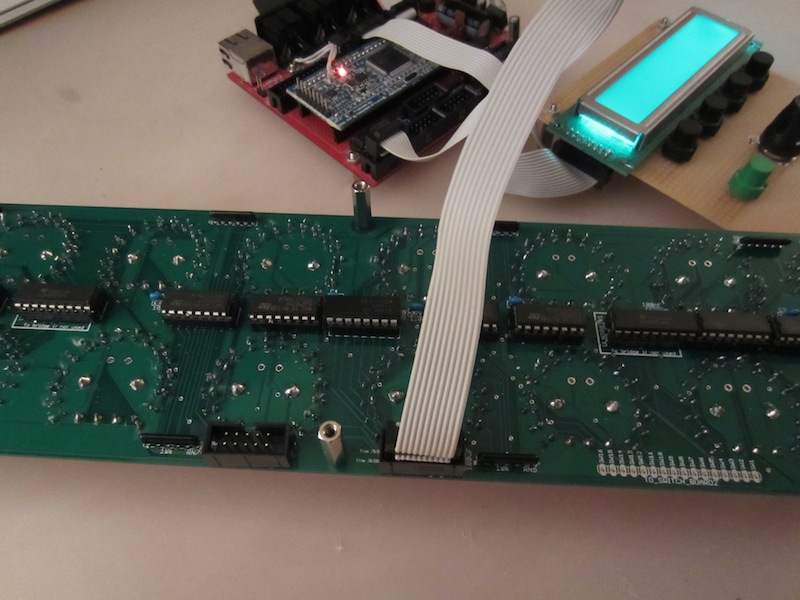

I got my boards as well, and the first one is already stuffed!  :smile:

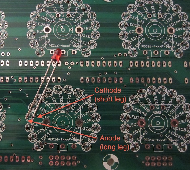

You might miss following details in the documentation:
The LED polarity for newbies: the cathode (short leg) has to show to the center of the LED ring:

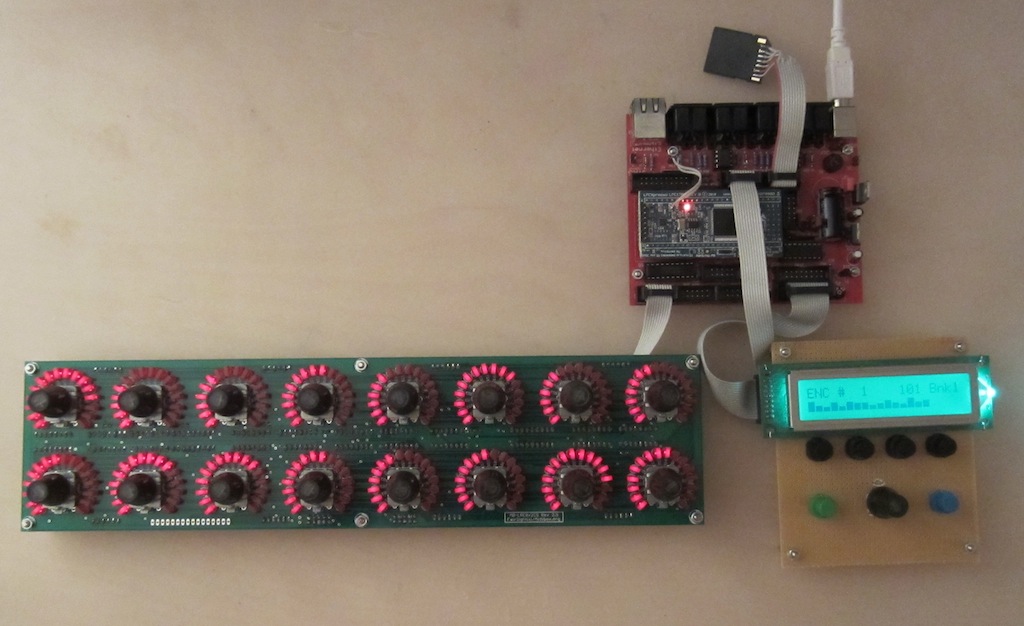

Last but not least: the LED brightness topic:
By the way, what is the recommended brightness in mcd of the leds? Perticularly diffused vs non-diffused?
A very good question, because it seems that this topic is more important than expected.
I used the same “rectangular” LEDs like Jerome, and noticed that the brightness of the LEDs is not acceptable (from my point of view).
The LED rings are looking nice on the pictures, but in reality you won’t see anything in a bright environment (e.g. if a lamp directly spotlights the board)
The reason for this is the time-multiplexed handling.
With a 16x16 LED matrix each LED ring will only be active for 6.25% of the normal time.
This is fact by construction, software can’t fixed this (e.g. I tried a higher scan frequency… but for obvious reasons the LED is still only active for 6.25% ;-))
Also the transistor array or lower resistor values won’t help for these rectangular LEDs.
The results are much better on my initial MB16E construction, and as far as I remember I just used the low-cost red LEDs, which are diffused and have a higher mcd than the standard LEDs.
I will order these ones from Reichelt, and should be able to test (and confirm) them this weekend.
