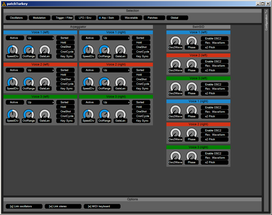

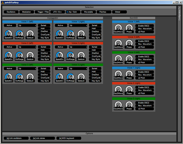

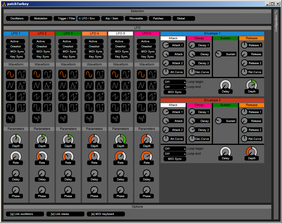

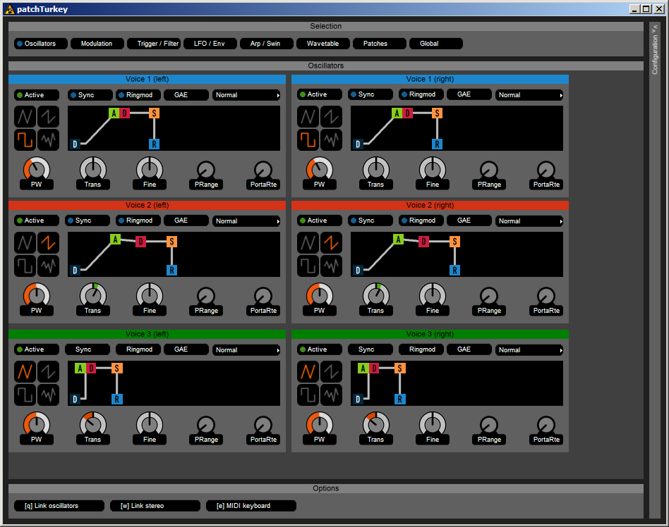

Just to illustrate my point about the amount of knobs needed, I attached some screenshots of a SID patch editor, which will give you a rough estimate about the vast amount of parameters
