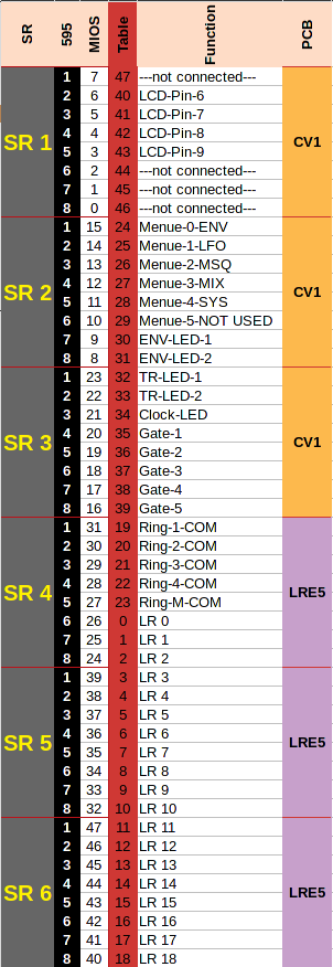

i forget that i already made that Circuit-Desigin-Reverse-Failure! DAM²
for my LRE5LCD2 PCB i choose this method (and its working )
i like it because, so i can set the LED-Matrix to be from 0-19 instead of beeing 23-whatever… so a for(x=0;x<19;x++ …) is more simple
in the top of the program i made:
// DOUT-TABLE 0 1 2 3 4 5 6 7 8 9 10 11 12 13 14 15 16 17 18 19 20 21 22 23 24 25 26 27 28 29 30 31 32 33 34 35 36 37 38 39 40 41 42 43 44 45 46 47 const u8 led[64] = {26,25,24,39,38,37,36,35,34,33,32,47,46,45,44,43,42,41,40,31,30,29,28,27,15,14,13,12,11,10,9, 8, 23,22,21,20,19,18,17,16, 6, 5, 4, 3, 2, 1, 0, 7,48,49,50,51,52,53,54,55,56,57,58,59,60,61,62,63};
i use it for example like this:
// 1.b Deactivate Anodes for (x=0; x\<19; x++) {MIOS32\_DOUT\_PinSet( led[x], 1); }
and made a doku like this:
and there is the libre calc tab:
[DOUT-Table.ods](< base_url >/applications/core/interface/file/attachment.php?id=15468)
