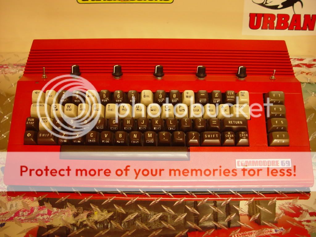

I’m still modding commodores to raise funds for my midibox projects.
Finished this one last weekend:
Now on Ebay:
