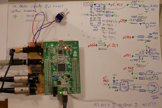

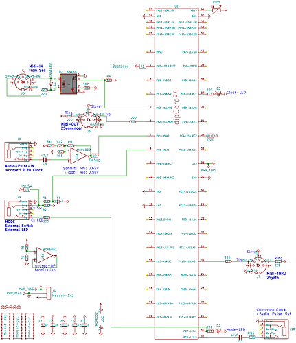

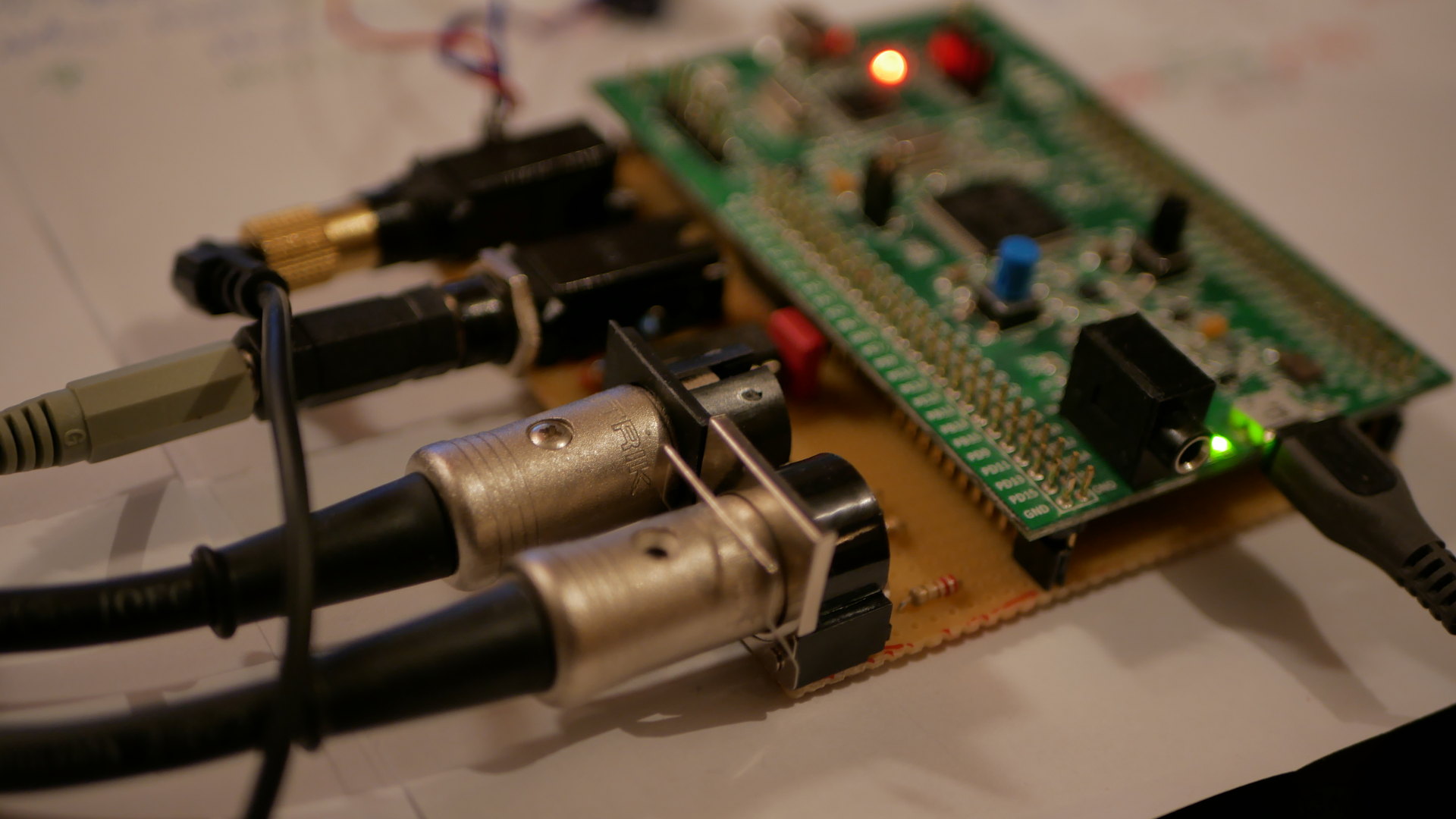

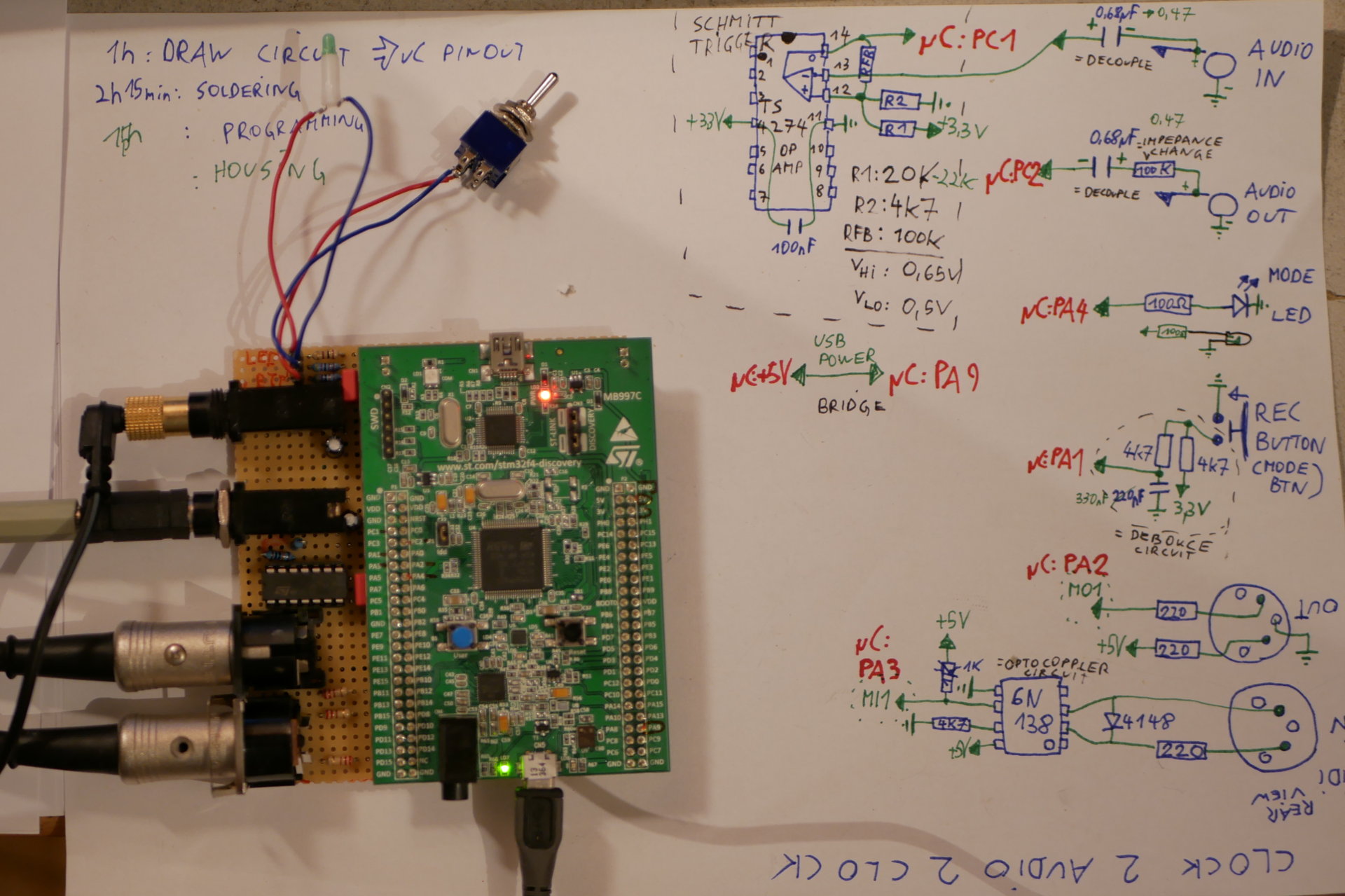

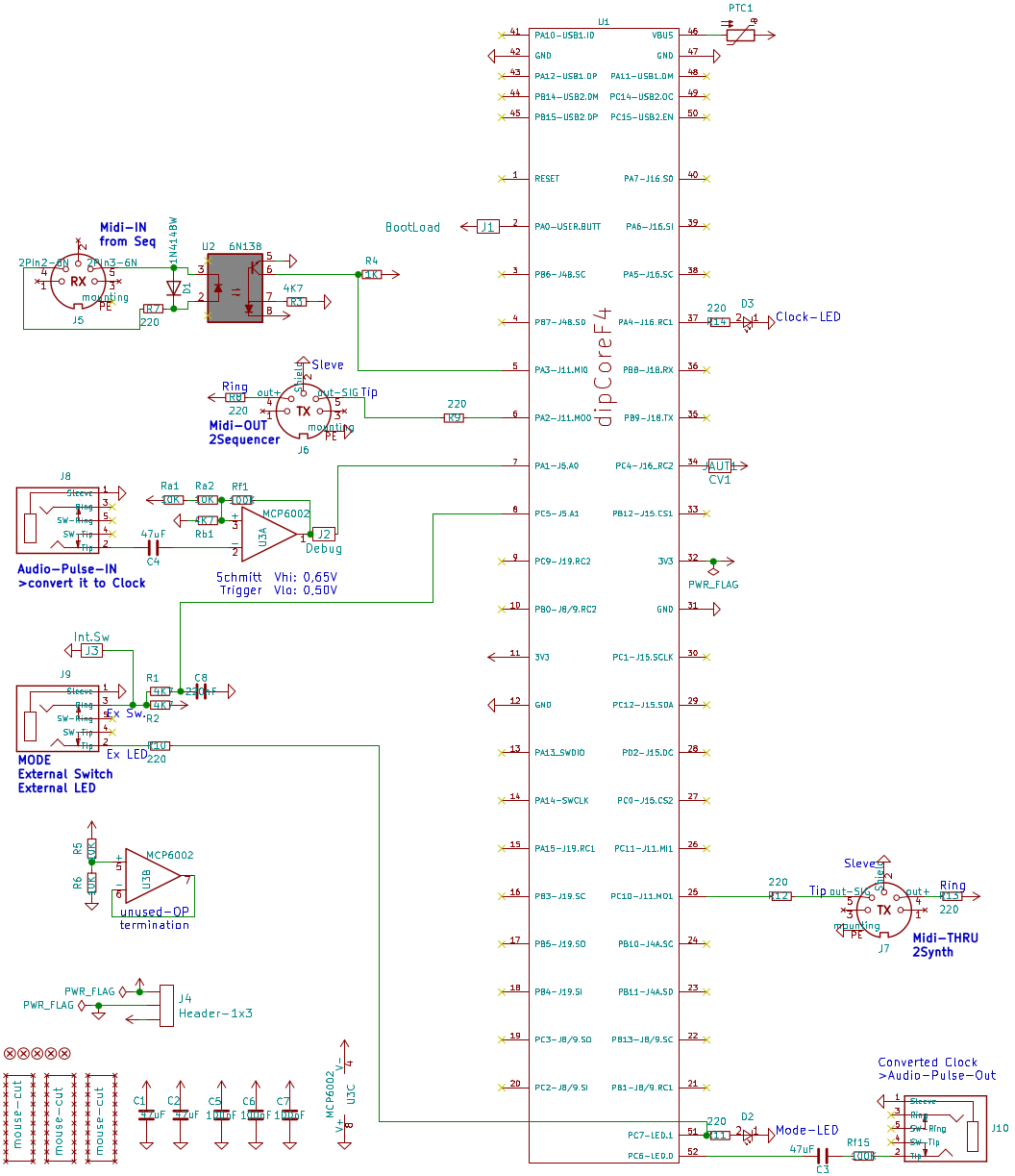

na directly recording midi wasnt the way, but first convert it to audio pulses on a DOUT-Pin, and then record it, when playback it go thru a Schmitt Trigger into a DIN-Pin, the strip down mios-functions and code, it is running thight, HURRAAY
i solved it this way:

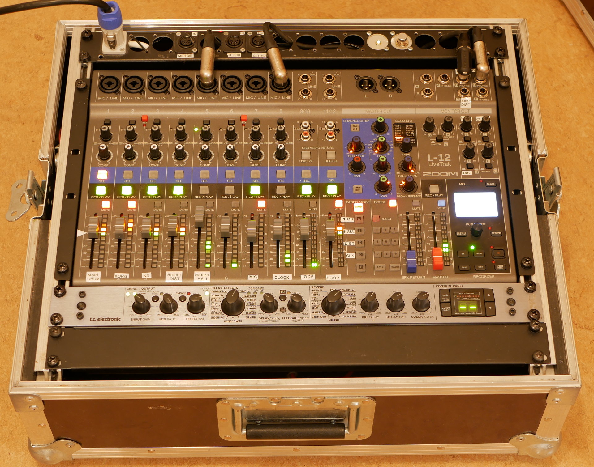

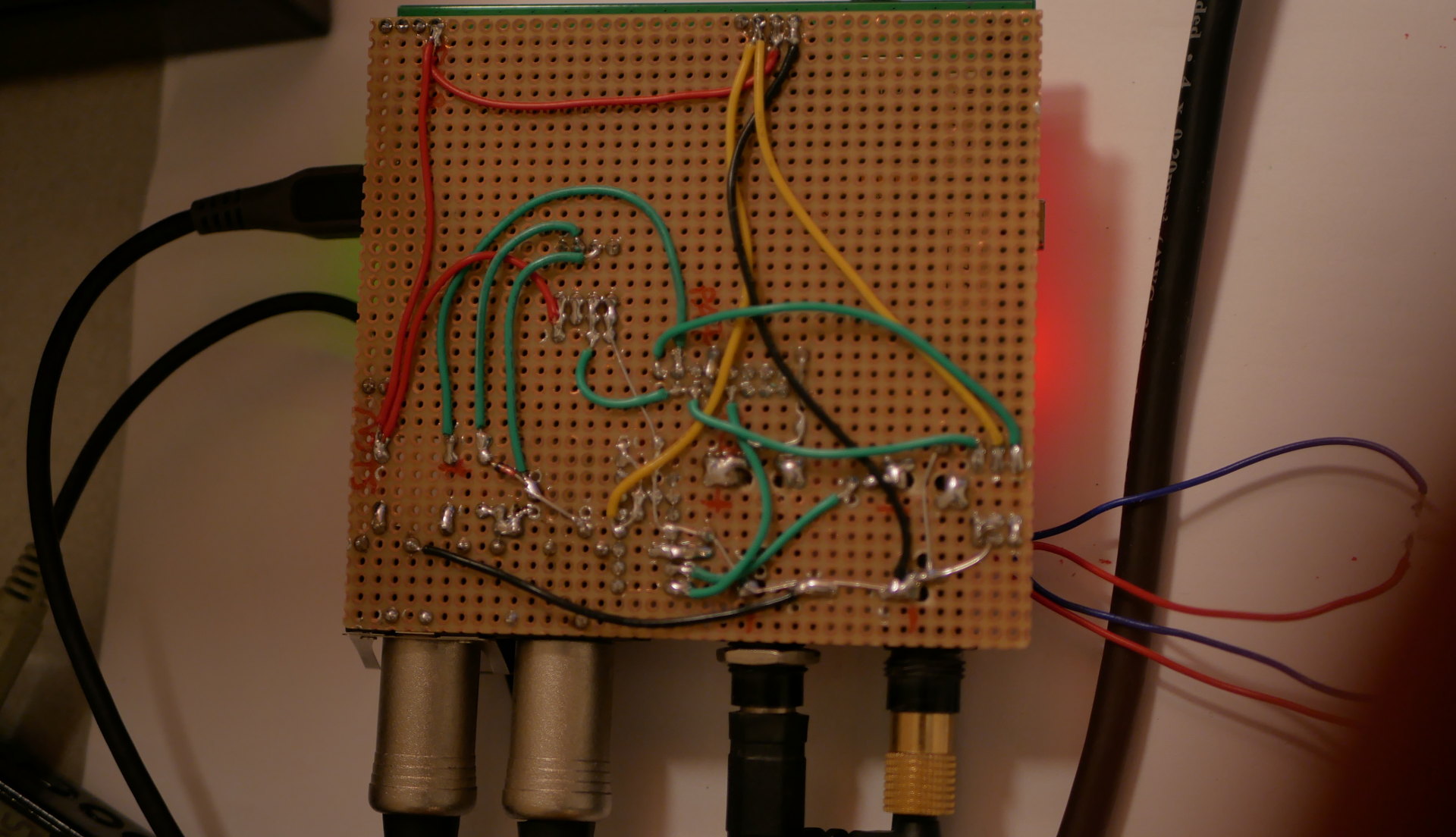

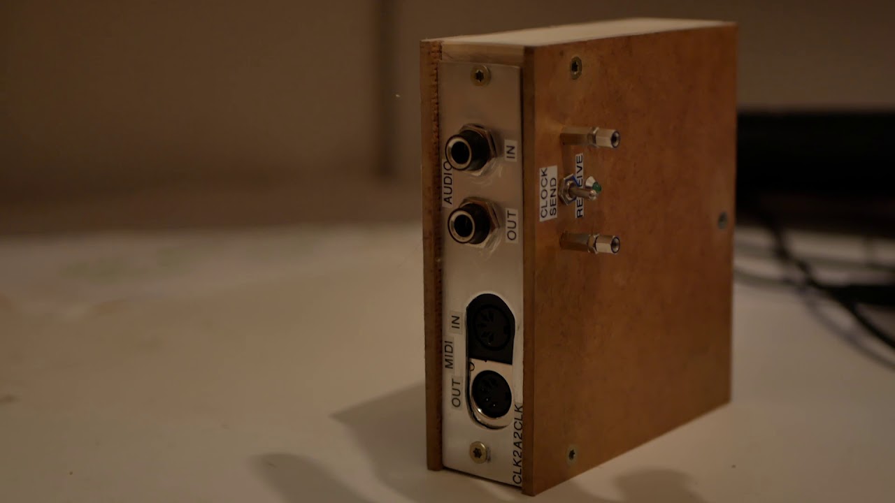

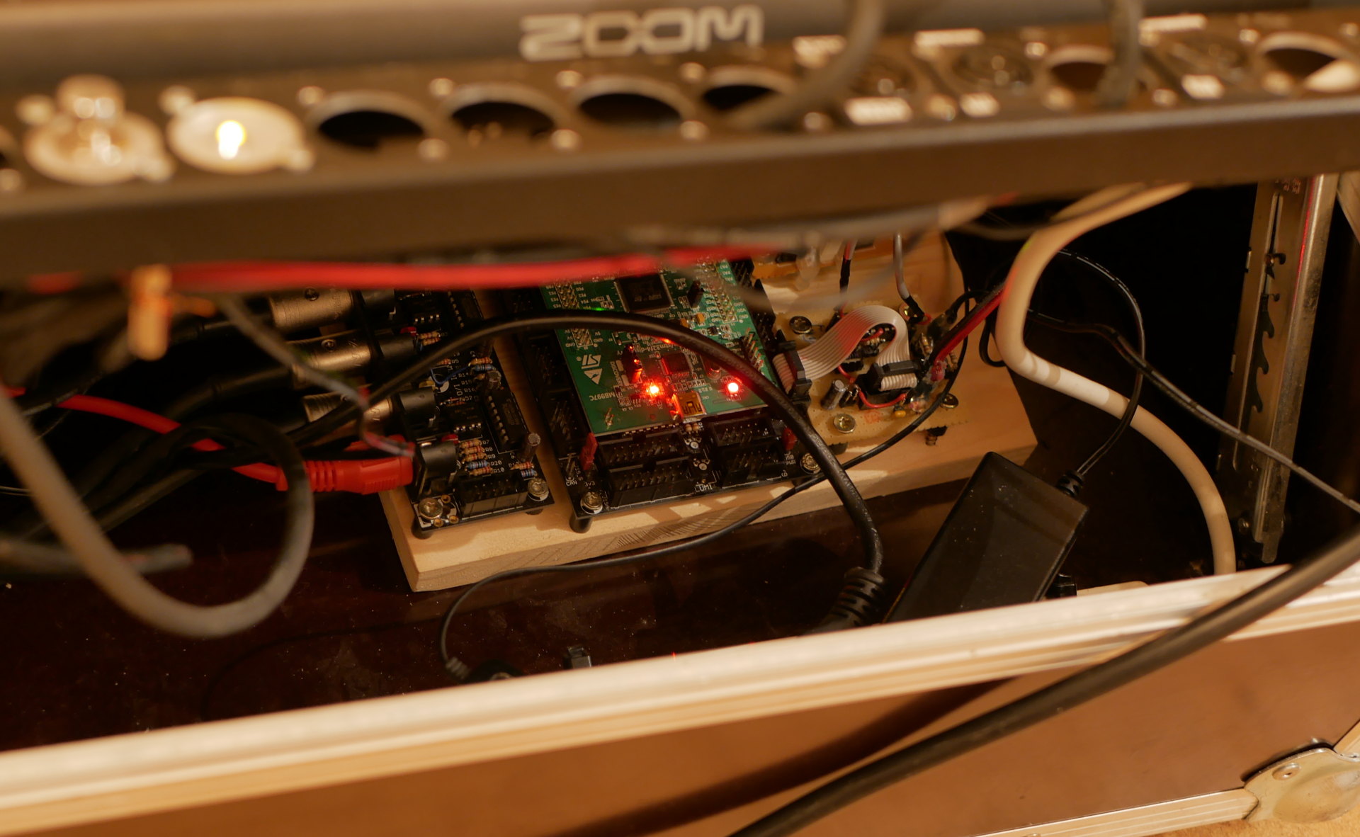

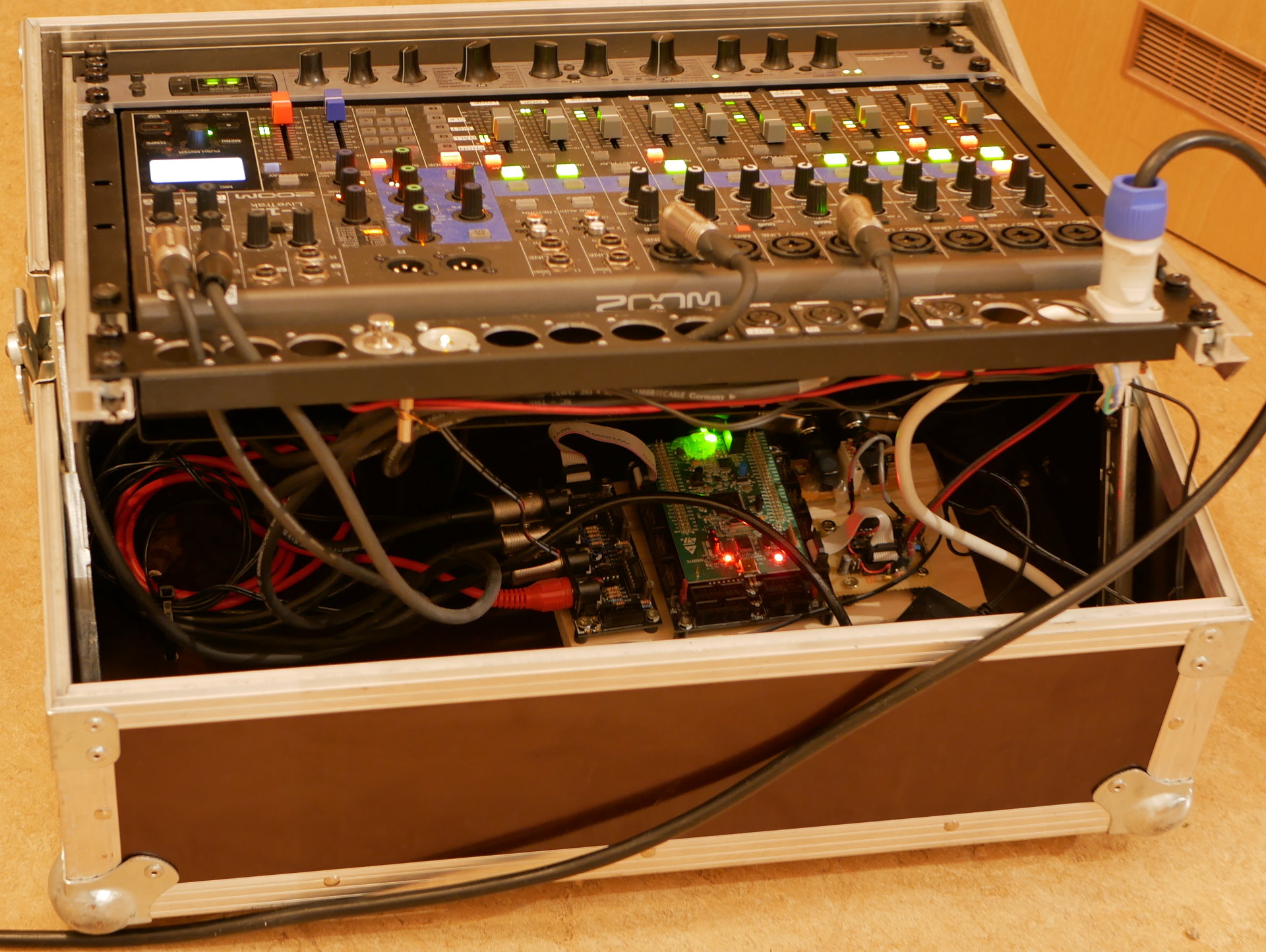

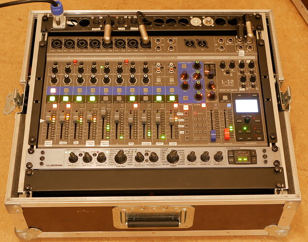

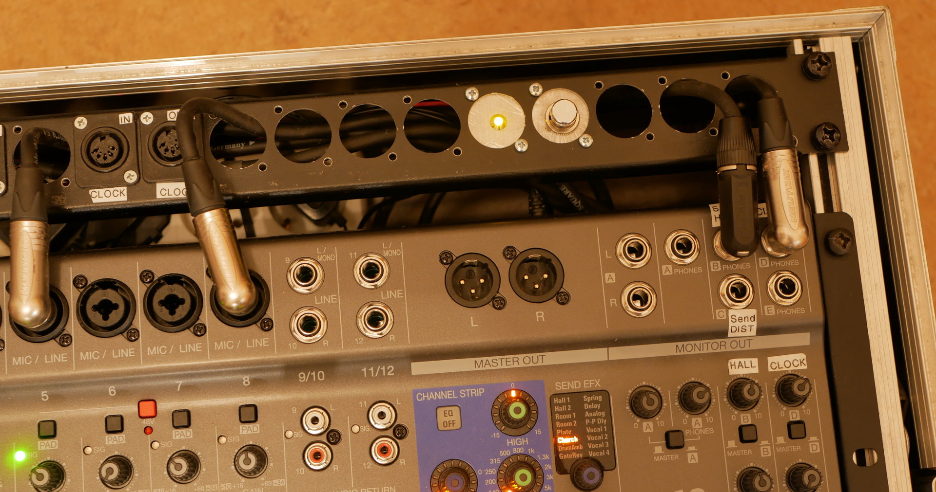

updatet the wiki, and the first post, i finally built it into a Rack with the Multirecorder:
http://wiki.midibox.org/doku.php?id=clock2audio2clock#how_i_use_it_-_built_in_rack
here completely on protoboard (except discovery)
i made a video with a demo song - to see its practicable use - and some explaination - and talk (englisch)

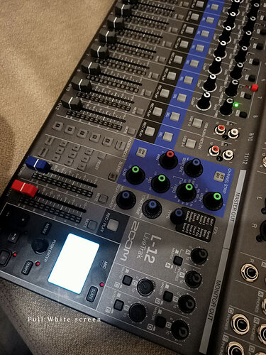

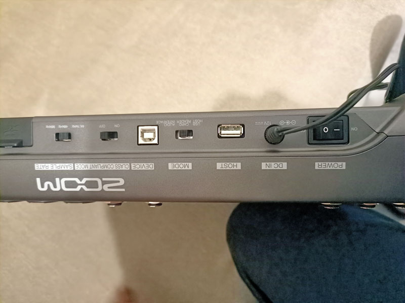

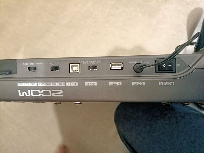

I am facing a problem with Zoom LiveTrak L-12. Maybe you may help me.
I have bought Zoom LiveTrak L-12 from Thomann online.
I have not used it actively. Just checked if it is working at home a few times and without SD card. It was working.
I bought SD card and I put it in. When I open the unit I saw just empty white light on pad screen on right.. The unit doesn’t started up. It stucked like that.
And there was nothing. I pull out SD card and I tried to make the unit on. But it also didn’t worked.
I have shocked. Not possible. Because this machine never used or carried somewhere, or dropped, hitted.
Than after a few times I test it to work with SD card and without. But nothing happened.
The unit is not working with or without SD card.
When I plugged and turn on what I see is just this recording Pad digital LED light is white. You may see from the photos.
When I turn of the unit it still shows these lights. No matter on or off. This is also strange.
I am sending photos of the unit situation with this post.
If you have any idea what it can be please help. Unit is not working now.
Thank You

Hi, uygroove
  1. This is not a Tascam Support Forum! I just wrote a tool, to handle Midi-sync with any Analog or Digital Mixer that have not a Midi-Port.
  2. You may turn that “Mode”-Switch from “Card-Reader” to any of the other Modes, and restart. (Helps?)
  3. You may turn off Class Compliant Modes
  4. You may put a new Firmware-Update-File on the Root of your SD-Card - Root (already extractet when downloadet as zip file, of course). And read the manual about firmwareupdate-process.
have a nice day.

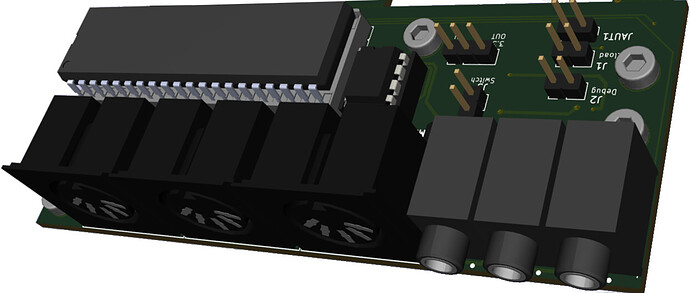

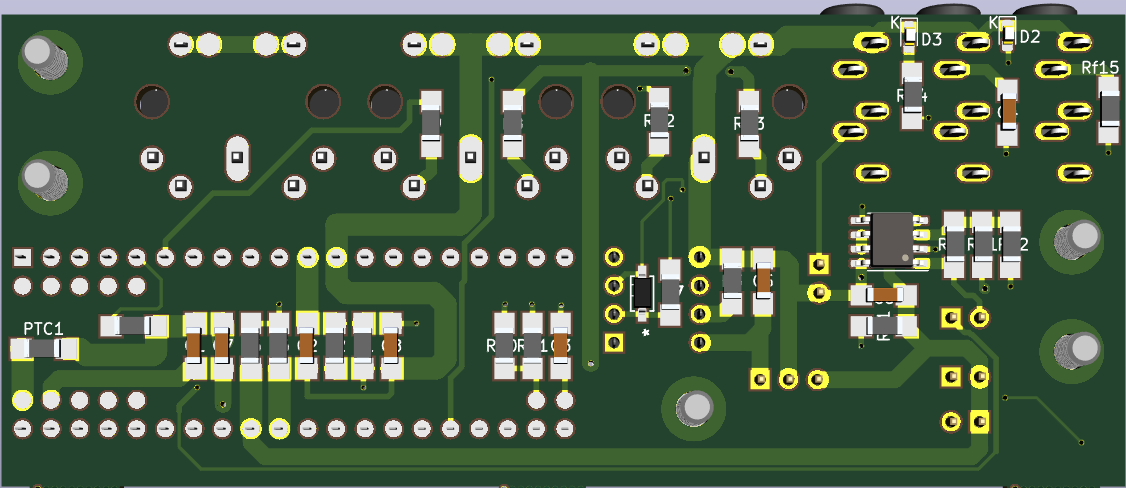

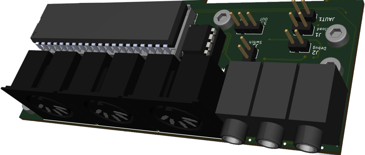

i made PCB for Pick and Place Service… and updatet the Wiki: (now waiting for the boards to come)
clock2audio2clock
