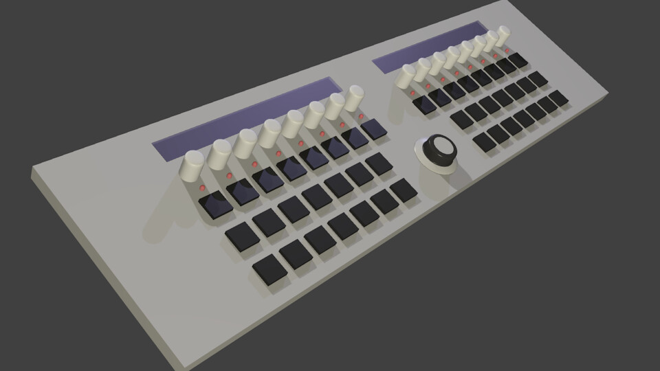

My first idea on how to layout my MBSEQ

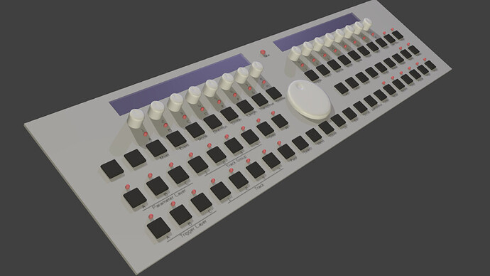

First key layout
But accidentally it was for a SEQ v2/V3 and missing the V4 buttons..

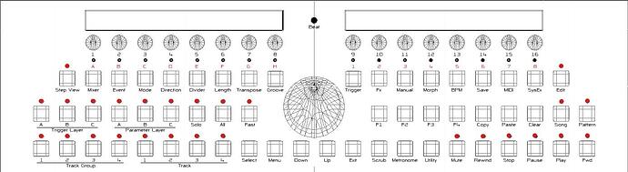

The last design
Now with all keys included, but still doubting about the layout of the layer/layer group keys.

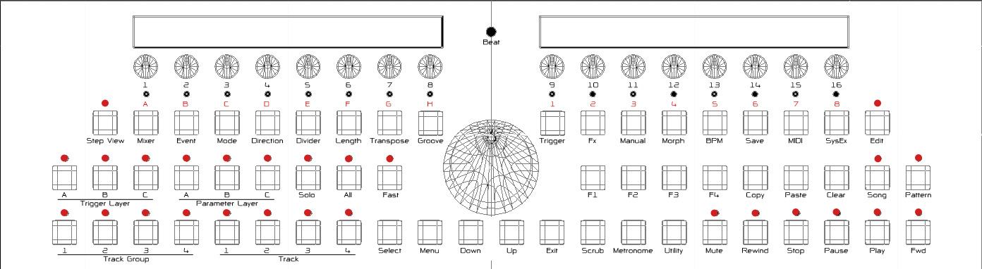

A few modifications later..
The 2D layout, with the two ‘unused’ keys removed and some layout changes.

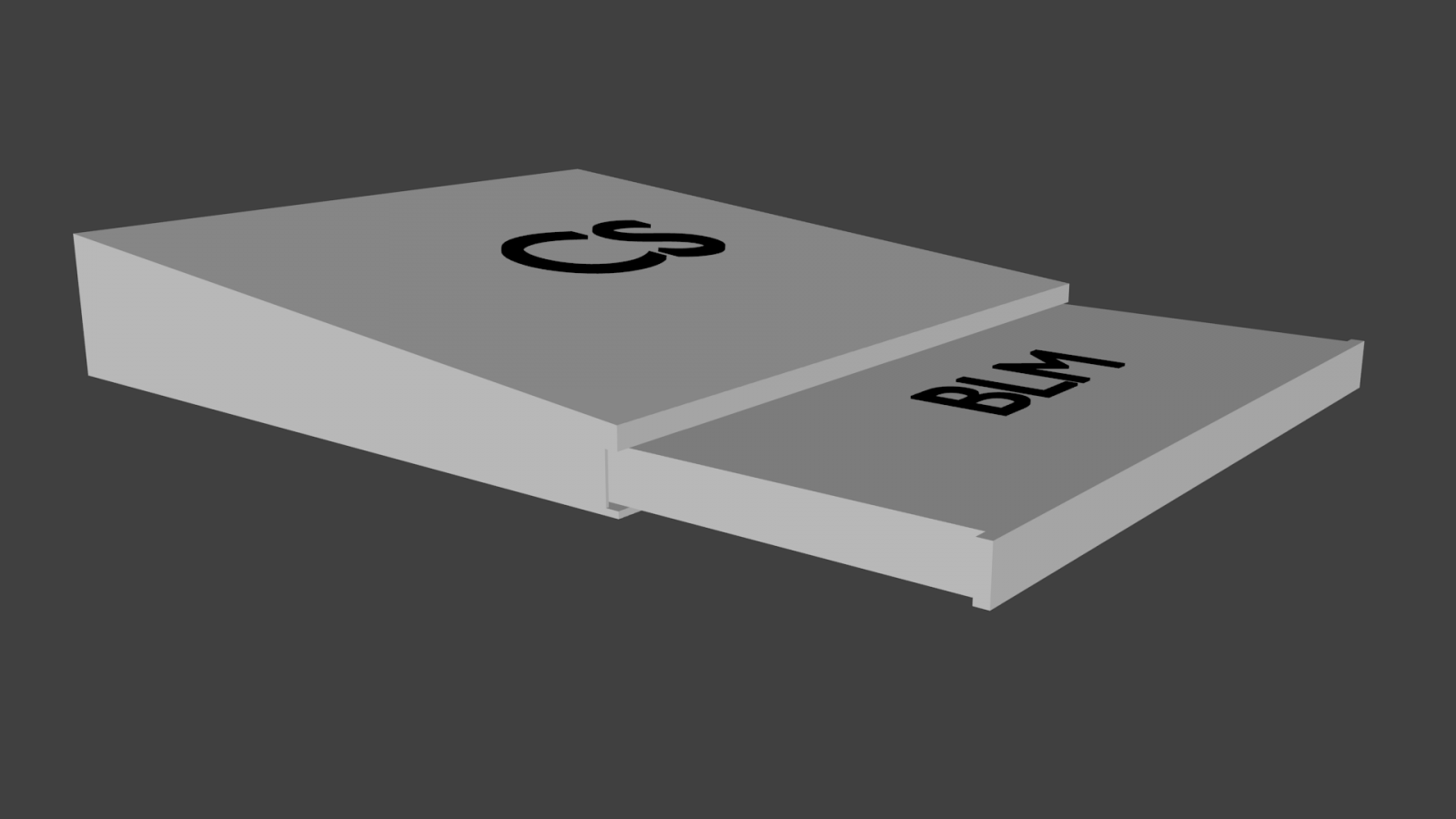

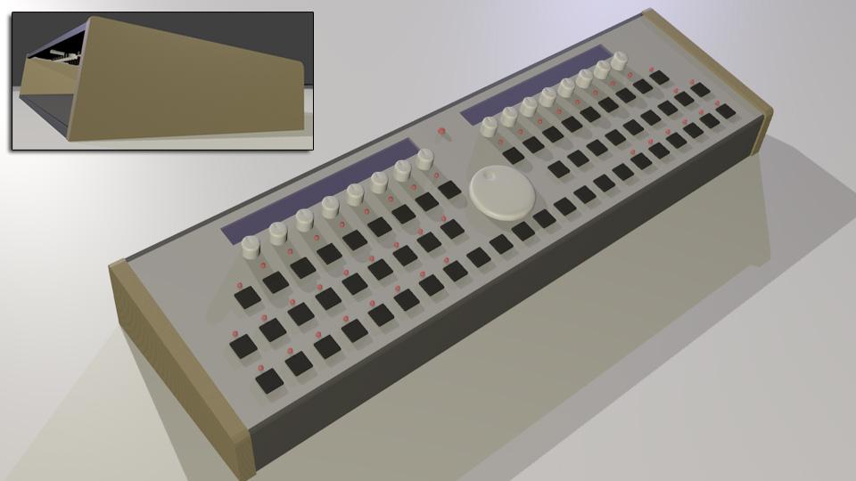

First case design
Wooden sides, front & bottom & back pieces MDF(?).
Top is angled 10 degrees towards the front, back panel likewise(see detail).

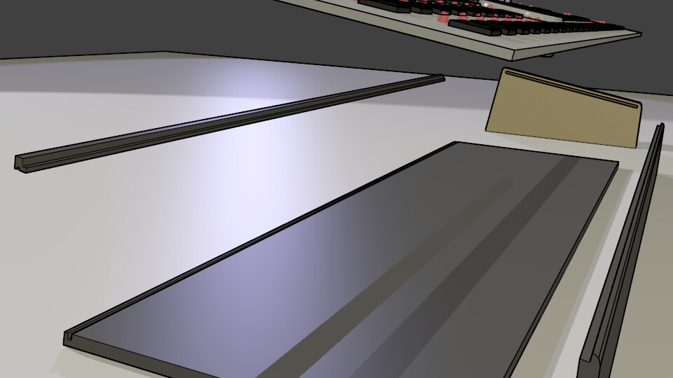

Exploded case
An exploded view with toony borders for viewing pleasure : ) And for detail of course.
Re: My first idea on how to layout my MBSEQ
Hmm, shouldn’t CS and BLM be the other way around? Or I don’t understand it at all :wink:
The idea was to make the BLM in a ‘drawer’ so both it and the CS are reachable. I think the other way around would mean that ‘playing’ using the BLM would be some hell of a lot harder.
Interesting idea to put BLM in a drawer. I’m still not sure how I’m going to approach this problem. I think there’ll be a lot of wasted space on your top section there if it’s just the control surface on top.
Re: A few modifications later..
this is really cool !!! i love it
