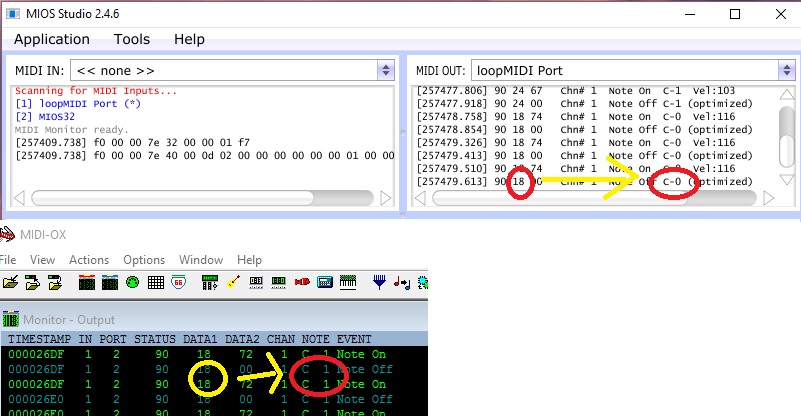

Hi TK,
In midi-ox, it shows me C-1 with value 0x18 and in MIOS-Studio it shows me C-0 with a value of 0X18. Traktor C-1 has a value of 0X18. See attached photo.
Marco.

The octave enumeration isn’t standardized.
E.g. in Logic Studio 0x18 is C0, and as far as I remember, you can configure MIDI-Ox to print the same.
No need to change (or to add an option) at my side.
Best Regards, Thorsten.

I was having difficulty mapping the Traktor (Dj program), I had to test who would turn on the LEDs one by one, until I found C-1 instead of C-0.
