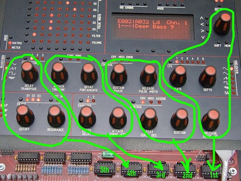

There’s no wiring diagram for the encoders, as I didn’t think it would ever be required.
However, what you are describing suggests that there is something wrong in the DIN modules.
At the bottom of the base PCB are 5 DIN modules aka. 74HC165 shift registers.
http://www.mb6582.org/plans/MB-6582_Base_PCB_R2_Color.pdf
The “chain” starts at the right, near the master PIC. The first four on the chain (right to left) are for encoders, the fifth is for switches. So if only some encoders work and no switches, I think something is wrong in this chain.
http://www.mb6582.org/plans/MB-6582_CS_PCB_R2_Color.pdf
If you follow the tracks on the CS PCB, you’ll notice the encoders that do not work all are connected to the 3rd and 4th (right to left) shift registers and the switches are connected to the 5th (right to left).
So… either the 3rd IC is not working, or there’s a short or break in the track around this IC. A break in the chain causes all controls further down the chain to not work.
I suggest marking each IC with a pencil so you know where you have them placed now… ie. 1st to 5th. Then you can swap them to prove if they are all working (i.e. test each one in the 1st slot, far right, and test menu encoder.)
Hopefully it is something simple like a dead IC or perhaps a bad solder joint (no power to 3rd IC, bad solder joint on the track from 3rd to 2nd IC).
Here is a picture to help explain things:

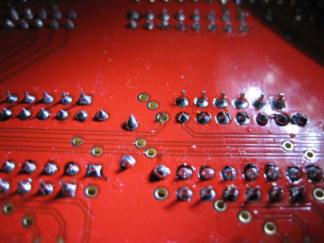

edit: Problem solved. There was one missing solder joint on 3rd 74HC165. :whistle:
