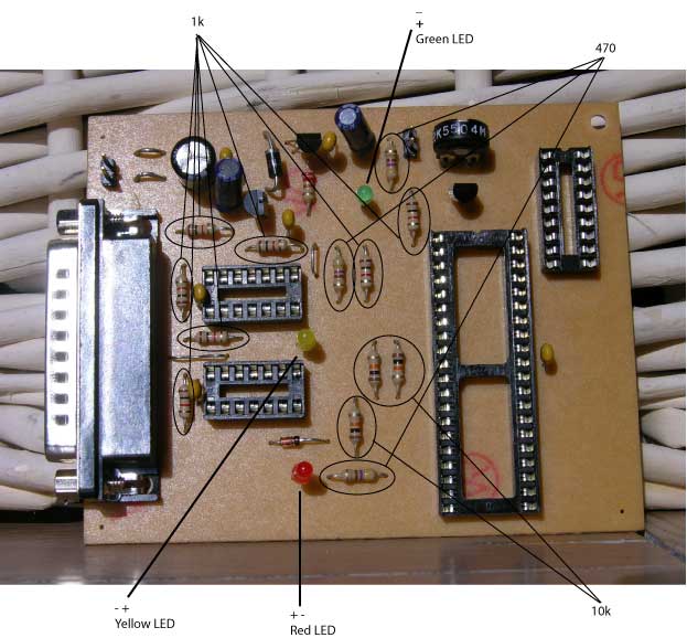

Could i possibly post pictures of my board here, so that someone could check it out for errors. Because i dont know what to do now.

Here is a picture of my board, with some additional comments. You can see how i have placed to LEDs, and if there are any problems with my setup otherwise. The little blister on the voltage regulator is because this image is from before i moved the lm317, as explained earlier in this thread.
I hope you dont get to confused by my drawings  :-\
Looks correct, I don’t know what else could be the problem. W/o the bridge rectifier you have to take care about the polarity, but I guess that you always did this?
