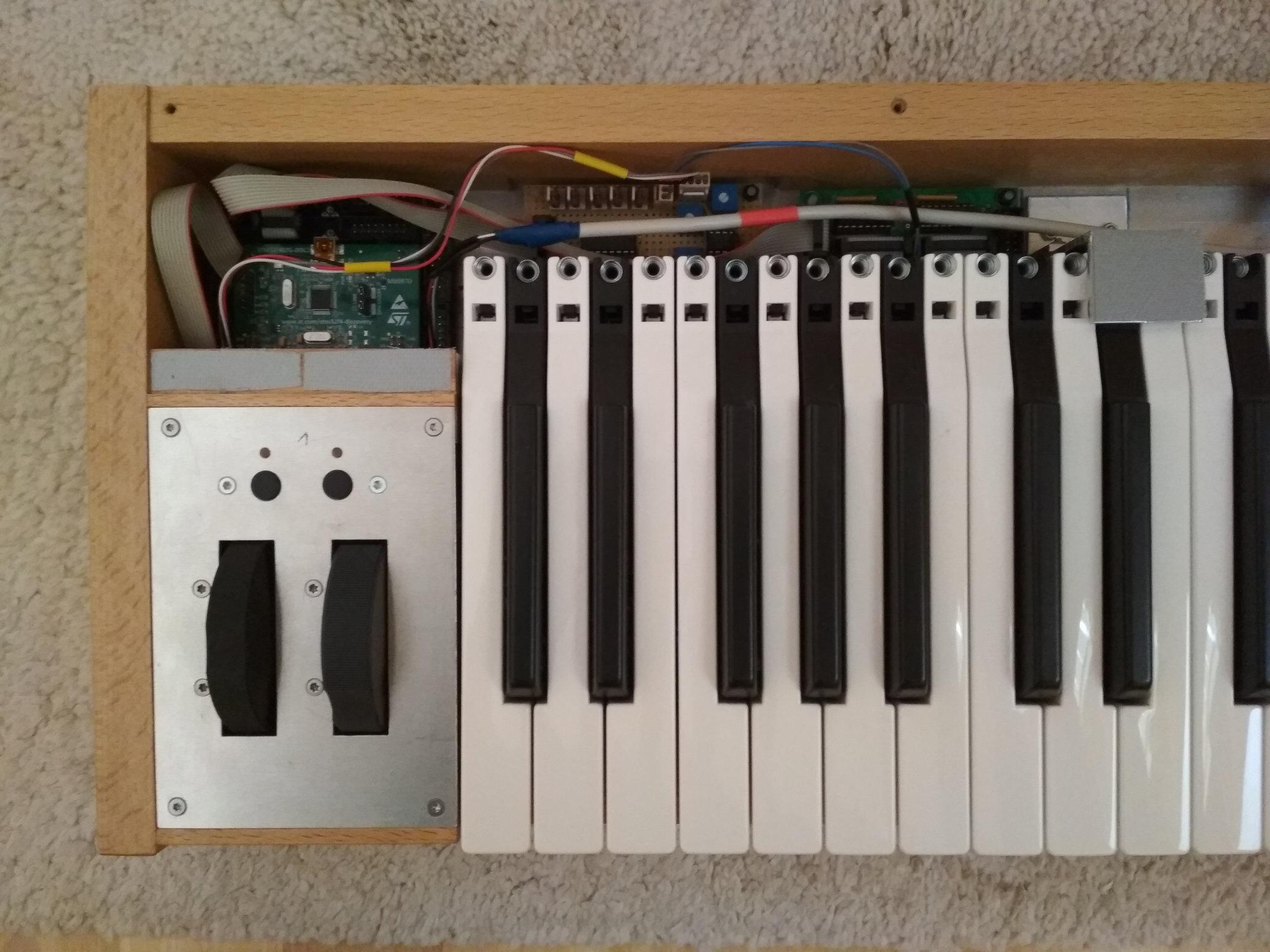

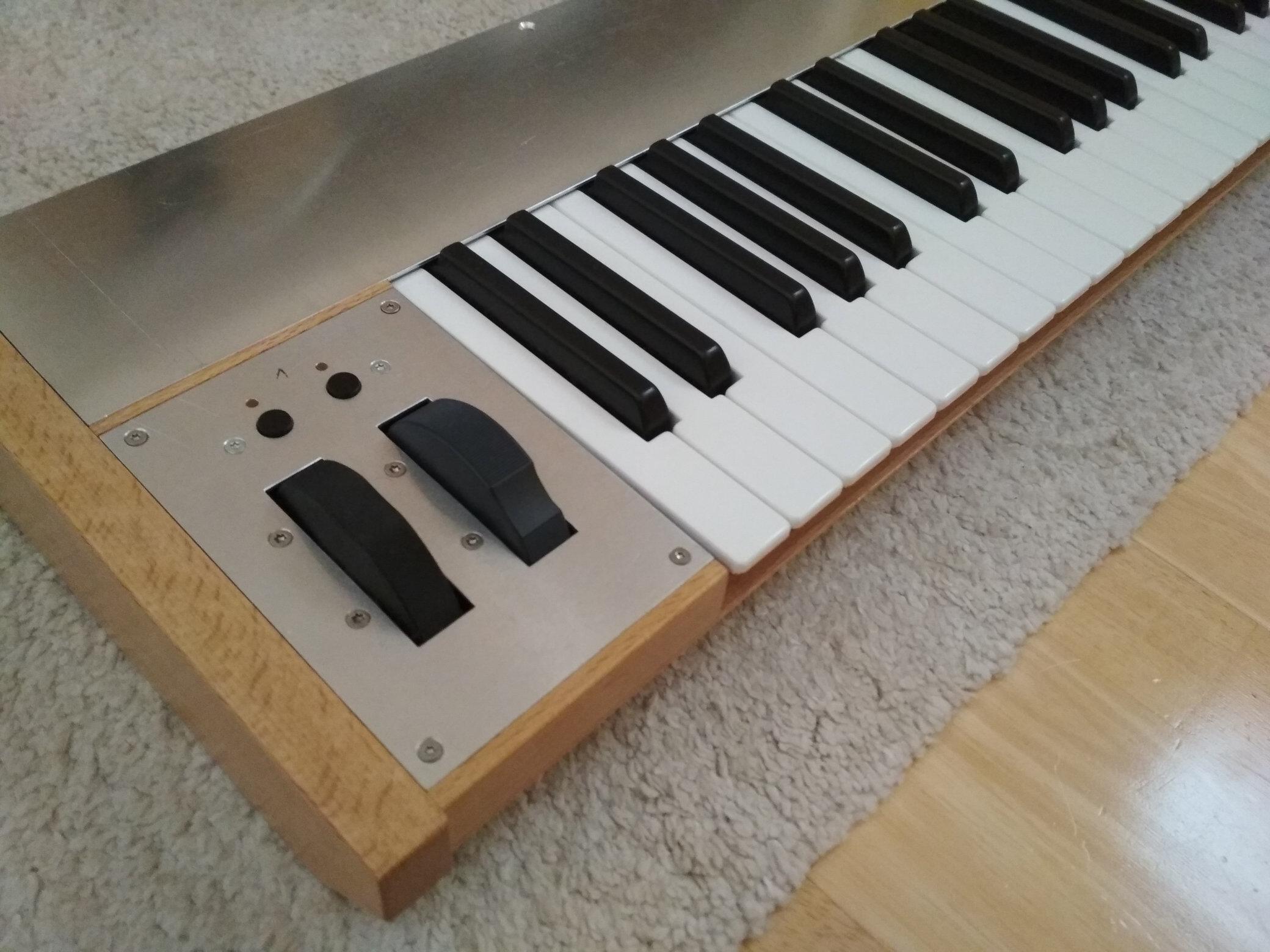

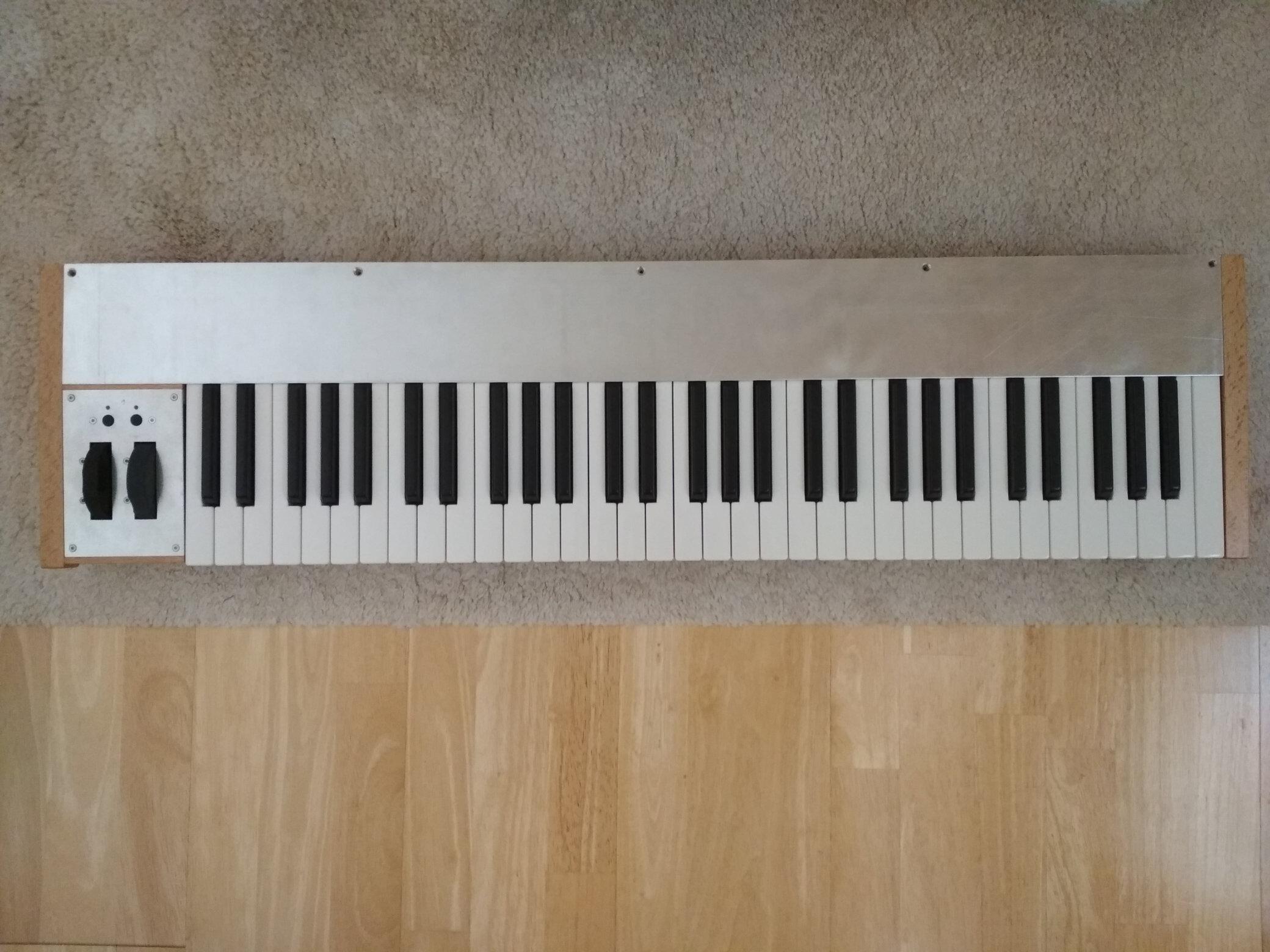

I built two identical controller keyboards using CORE_STM32F4 running MIDIbox NG. They currently feature analog ins, two wheels and octave up/down buttons. It was very hard and time consuming to build these without a proper workshop (used mainly beech wood and aluminium).

Hi Phatline, i’m using an AINSER8 module (see that perf board on the third photo). So pots aren’t directly connected to the core. Power is coming via USB.

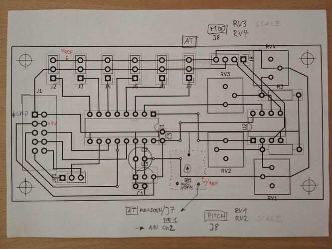

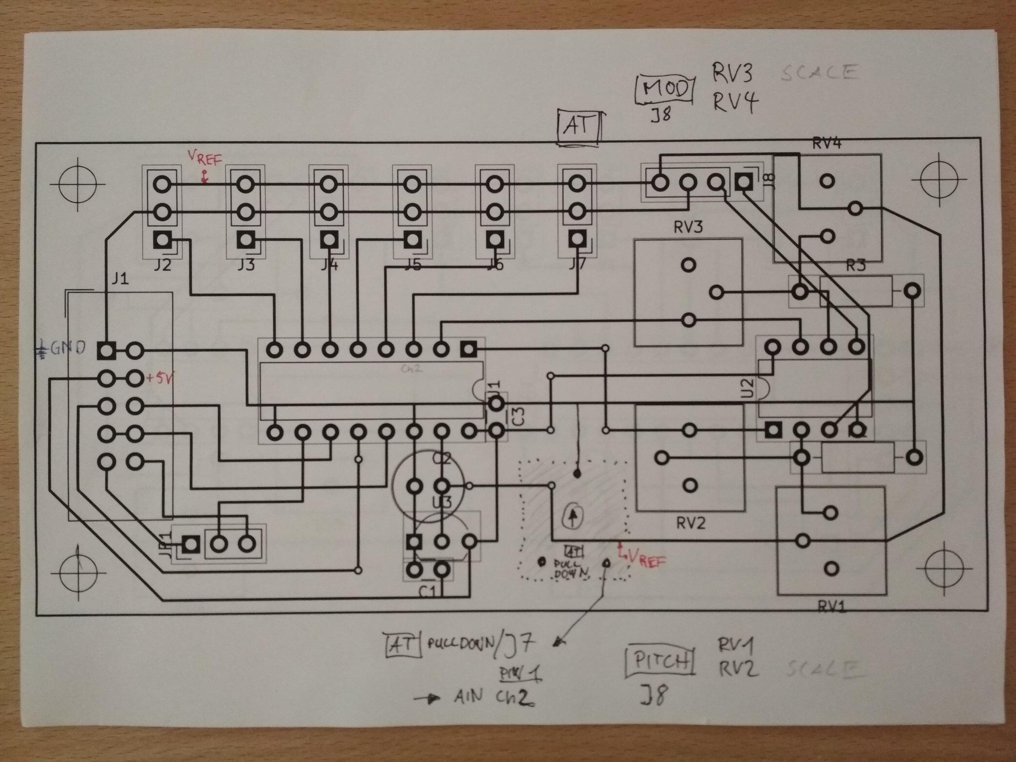

Here the pcb layout.
There is a voltage reference (U3) (center bottom - looks like a transistor) and on the right side an opamp (U2) to scale the voltage range because of the limited rotation angles of the wheel pots. I did that with the help and recommendation of and others. Can’t find the original thread at the moment.
See how the Vref (red) goes to the opamp (U2) and then to the jumper J8 where both wheels are connected to.
