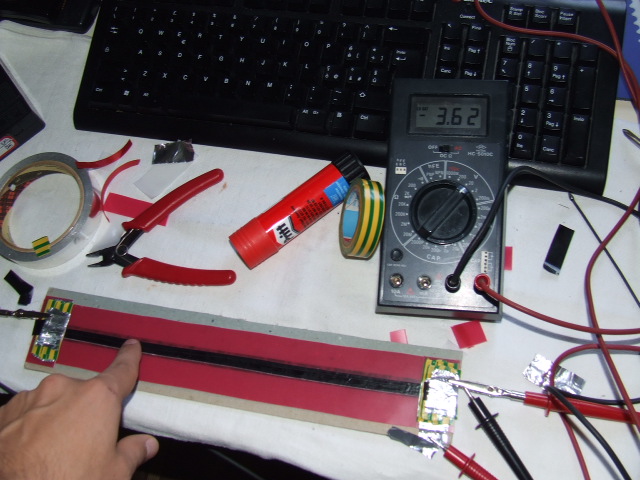

these are my first steps, after searching for thru the net…
i used a piece of a common VHS videotape to make the base of the ribbon contrller. its resistivity is a function of length. i tried different brands before finding a good one: several where not conductive on both sides. the right one had only one side conductive.
i assembled everything on a piece of hard paper, for now, and i used a “suspended” guitar string to make a contact between the finger and the VHS tape. the string doesnt touch the tape, the contact comes only when i press the finger… this is a little tricky but feasible…
the problem is the string tension which maybe will tend to loose… maybe it will be necessary some other method to fix it… for now it’s just “tied” to some hard adhesive…
i also used some “conductiver tape” to achieve contacts between all the parts.
when i apply 0-5 V at the edge of the vhs tape, press the guitar string somewhere in between, i read a varying voltage… exaclty as expected! :slight_smile:
now i have to think how to fix everything and, moreover, i have to find a way so solder wires… it’s not as strightforward as it seems… maybe i will use some little of piece of PCB boards to fix the string, the tape and the wires…

yes, i too read about SVHS tapes. mine was a common VHS for commond TV videorecorder… but i had to try several of my “collection” at home in order to find a good one (where “good” means: with the backside of the tape that show some resistivity - in the order of 100koh - most of them were totally insulating…)

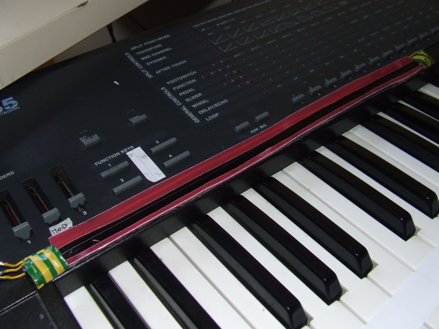

finally i completed my project.
it seems to work pretty well… but i have to find out a way to avoid flickering at minimum value when i don’t press it, the AC Sensorizer reads values between 0 and 60 (out of 127), while the minimum touch is at 30…
i think i will try to make a contact so that if i don’t press anything it stays at maximum value
