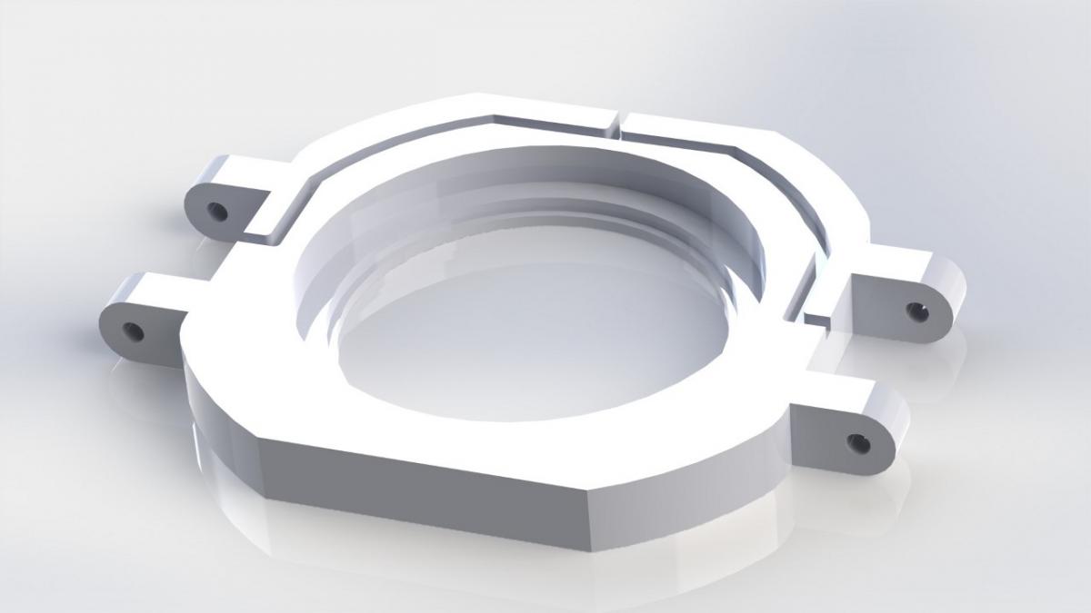

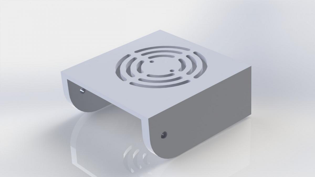

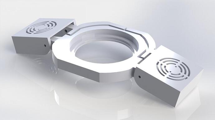

The concept was simple.. the magnifier in the middle with an LED each side, then the thought struck… why not make the angle of the LED pods adjustable??  That way I could ‘focus’ the light at the piece I’m working on, and the different angles of the lights would eliminate shadows, or I could flatten the pods out and have a larger wash of light.
Here’s some pics of the design, and the LED itself, and it’s output at minimum and maximum.
Finished the design work with the locking ring to hold the lens in place… added a ‘lens’ to the model for good measure, and given it a gloss black finish, which is how it will be painted.

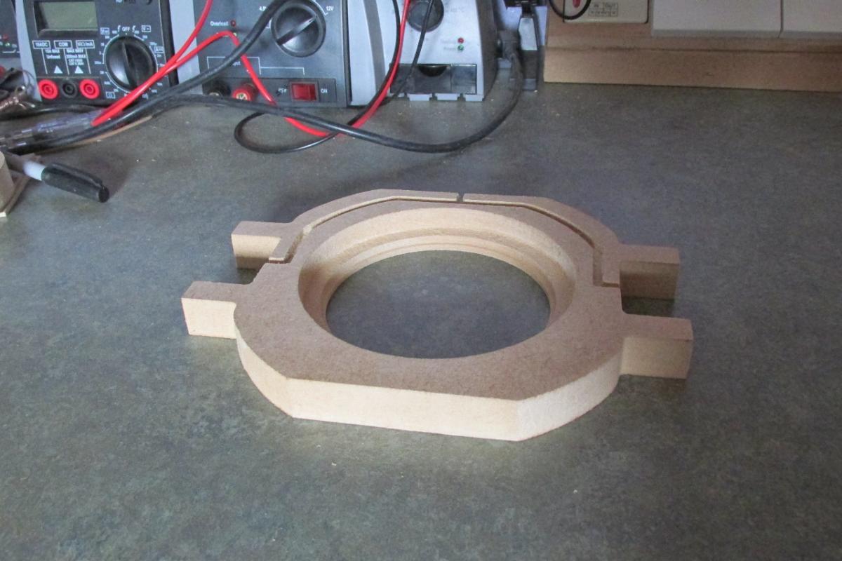

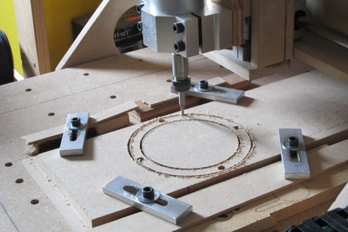

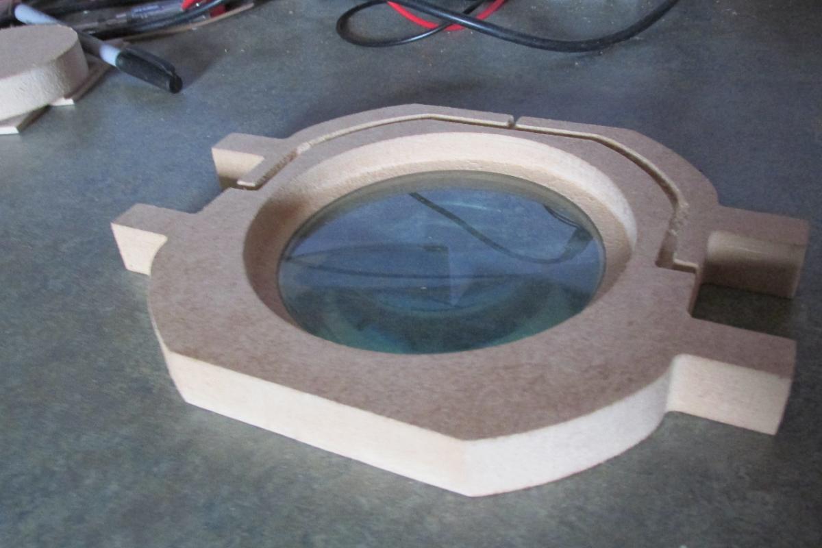

CUTTING THE MAIN BODY
First step was to cut the wiring channel with a 3mm endmill… looks good so far.

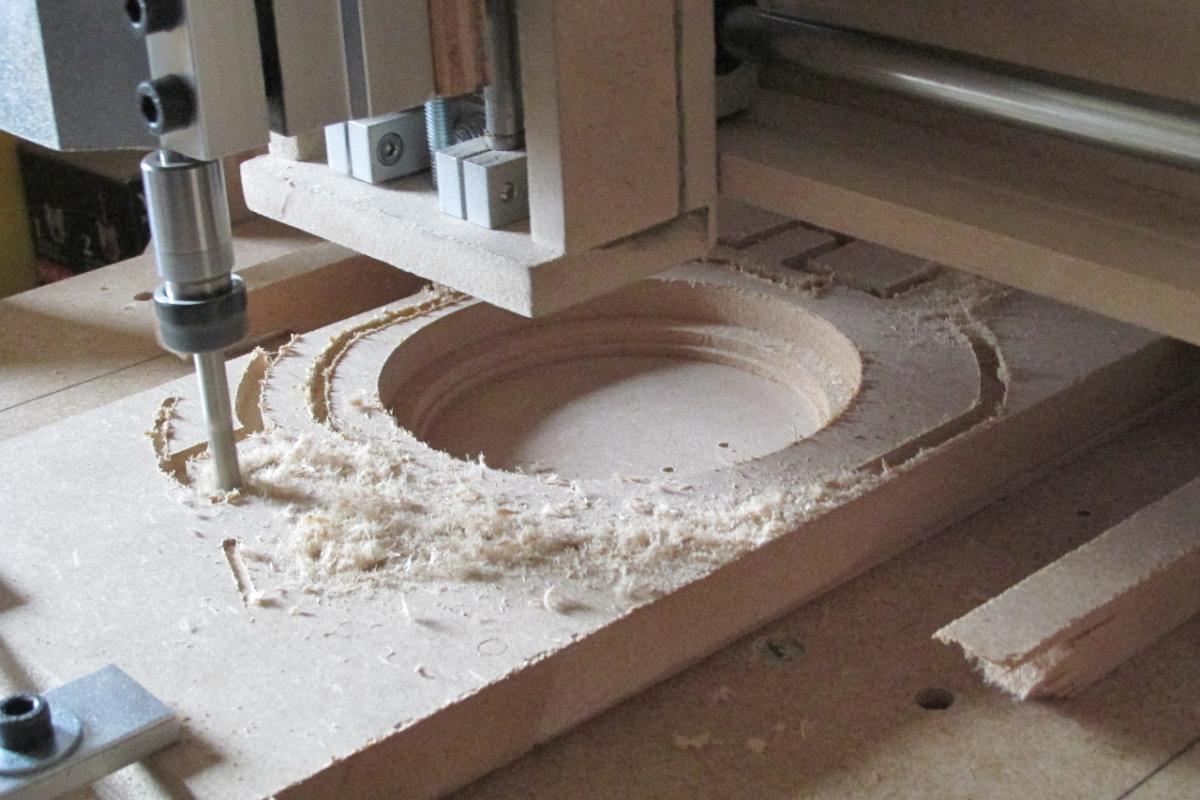

For the rest of the cutting I changed to a new 6mm endmill mainly to reduce the number of passes needed for the rebates in the centre cutout.

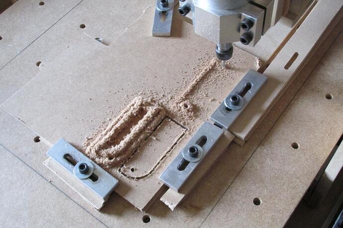

When it got to the outside profile, I saw the cutter came out of the material !!!  I had got my zero point in the wrong place!!
On closer inspection, it was only about 0.5mm clear of the workpiece. That’s not a critical edge, so I’ll live with that.
Photos show various stages in the process, and the final one with the lens test-fitted. The hole is the EXACT size and perfectly round!!! :smile: :smile: :smile: :smile:
I’ve got the CNC set up right, and it was cutting at 8mm/sec. The whole process took about 2Hrs.

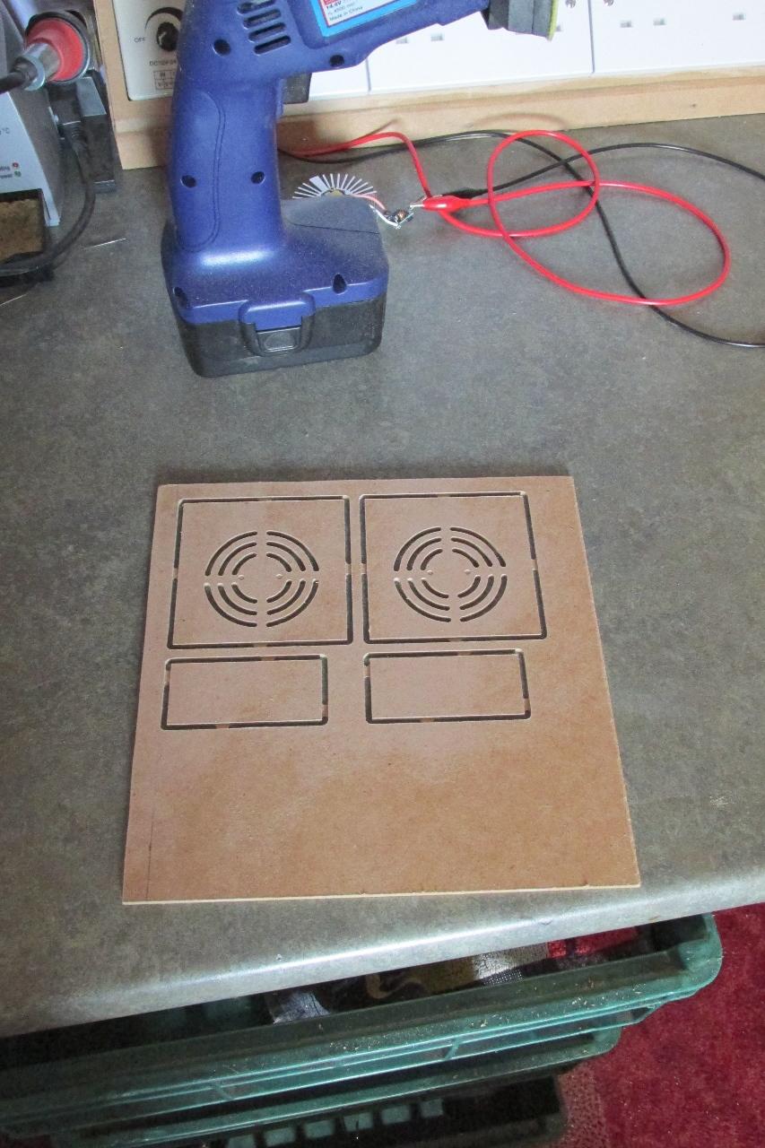

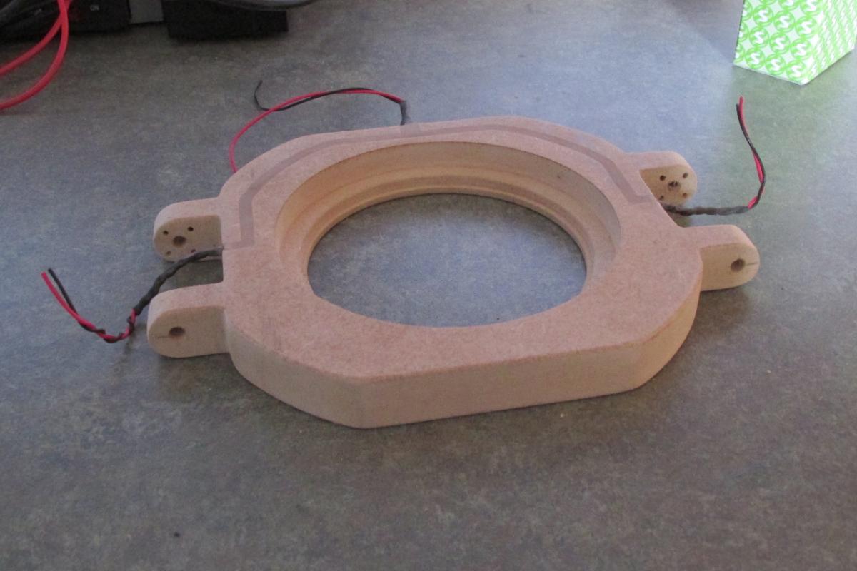

Progress continues as I embed the wiring into the main body of the lamp, and make a start on the LED pods.

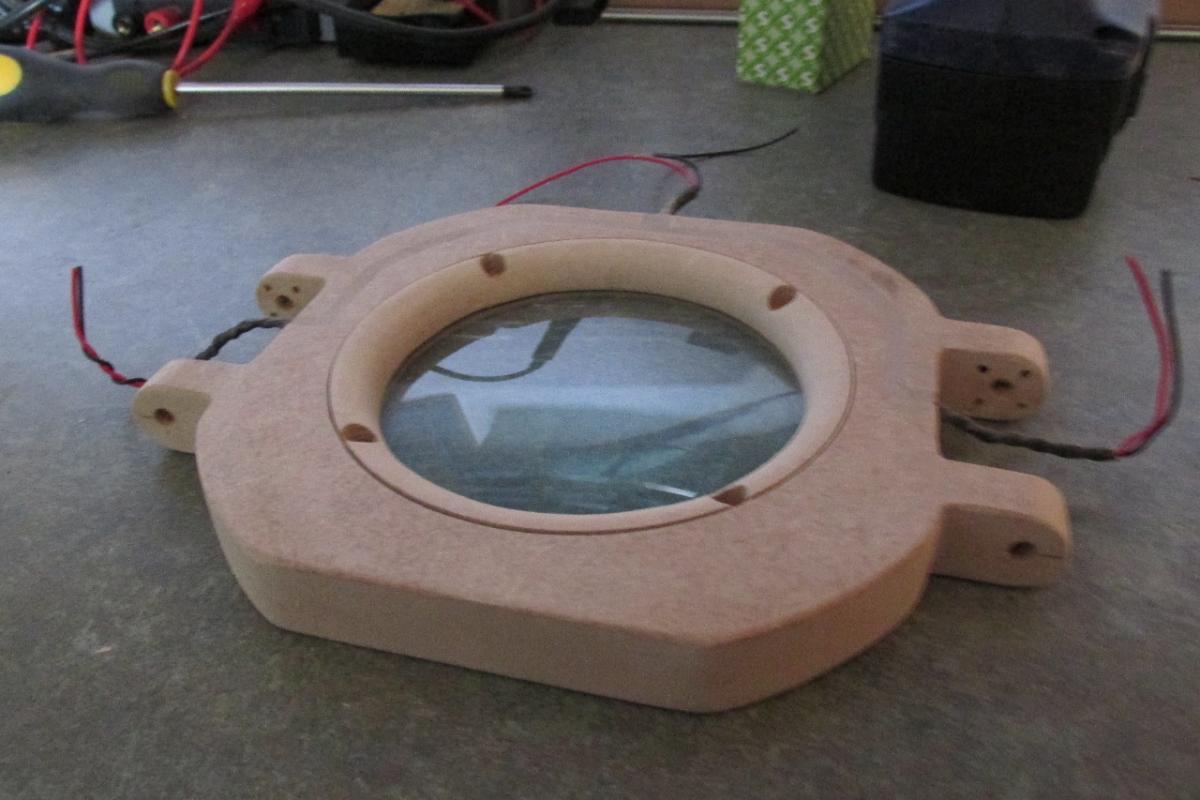

The final sculpting of the main body is now complete, with the end lugs rounded over, and all the edges softened with fine sandpaper.
The lens locking ring is now done. Putting the curve on the inside edge was… interesting to say the least… I did this on a router table with a roundover bit fitted, and the off-cuts from the CNC process to hold the piece, and keep my fingers away from the bit !!

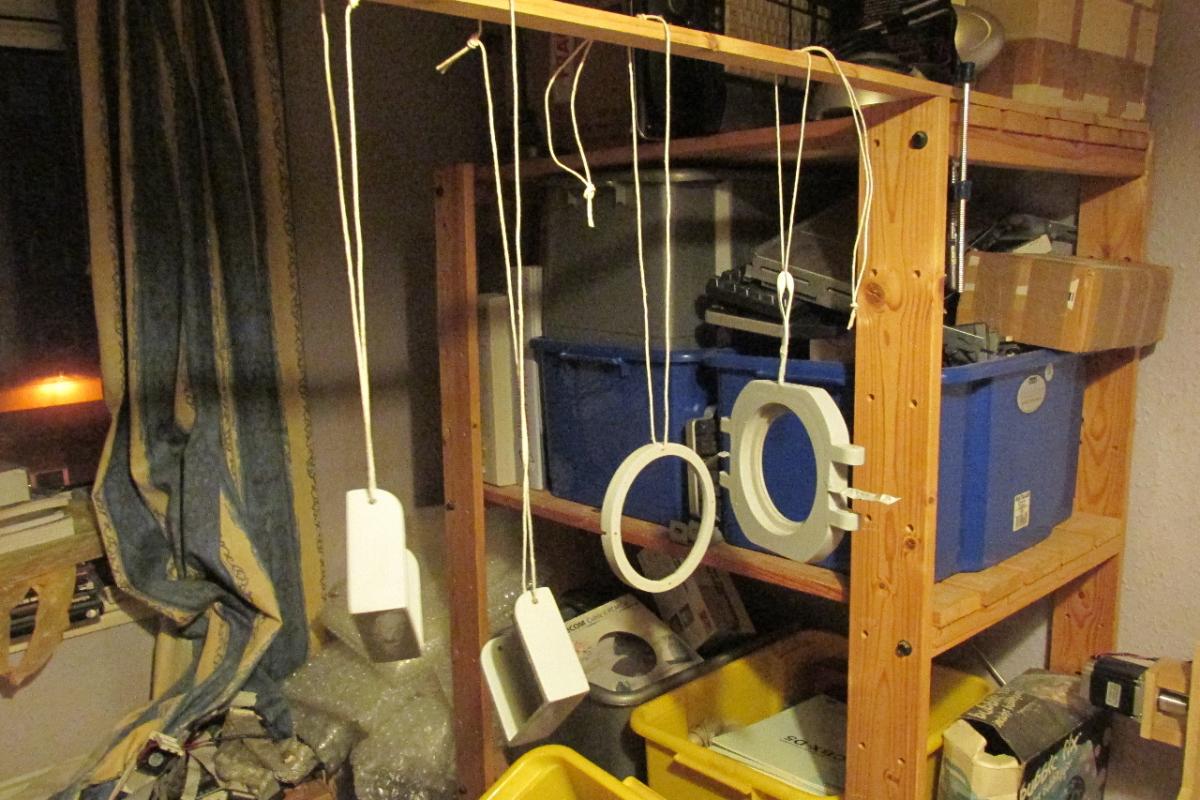

All the pieces have had a smoothing rub with fine sandpaper, and a liberal coat of thinned down wood glue to seal the MDF prior to final sanding and painting.
Parts are now primed and the 1st top coat applied.
Now comes the tedious part… waiting for paint to dry !!

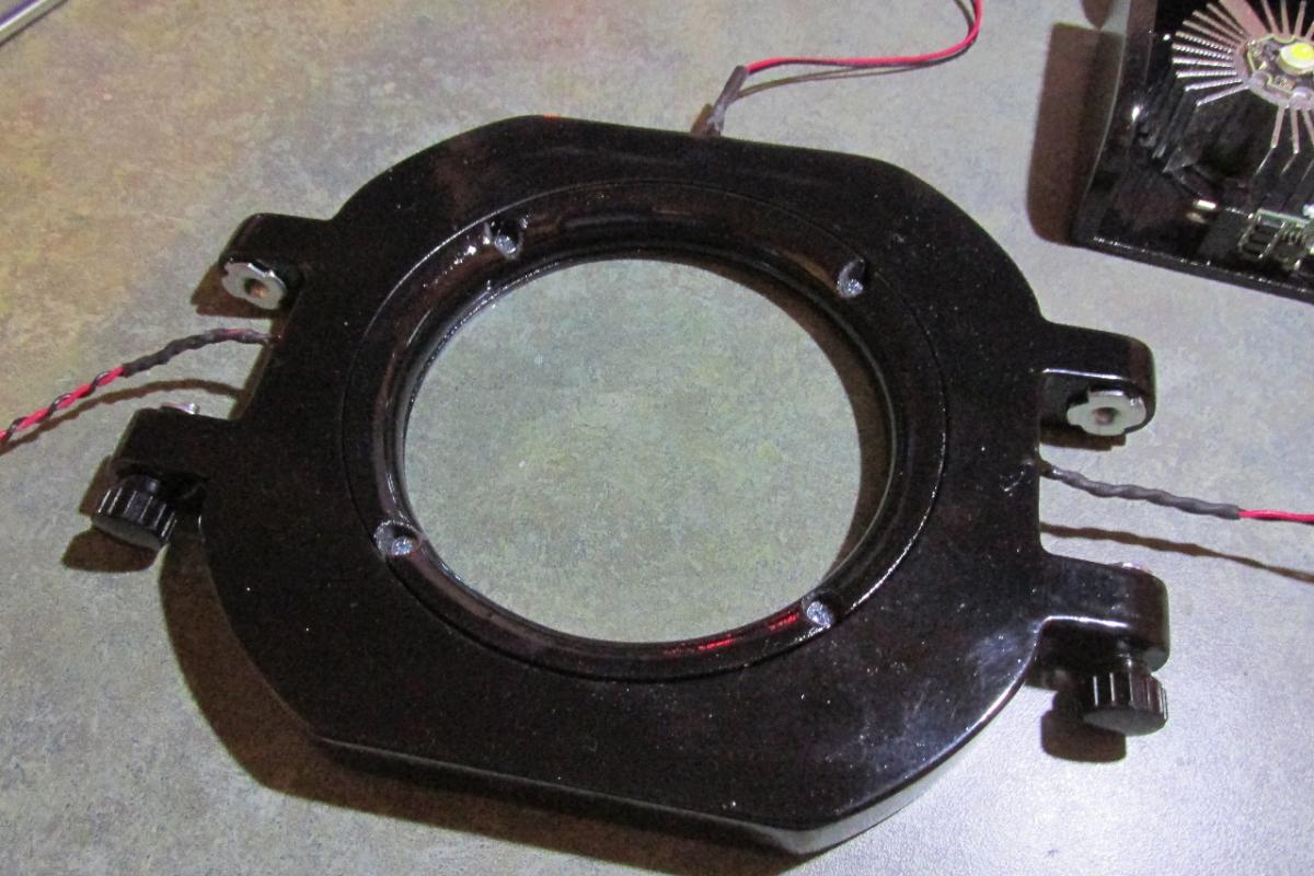

The lamp head assembly is now complete, tested and working…
and yes, it is F*****g BRIGHT !!!, the pics don’t really do it justice.
pics show:
polishing the heads of the LED mounting screws…  I do like to pay attention to detail
various stages in the wiring and assembly of the pods to the main body, and fitting the lens in place
comparison of the lamp at low and full power - even at low power it overwhelms the desk lamp beside it (that has a 1W LED in it)

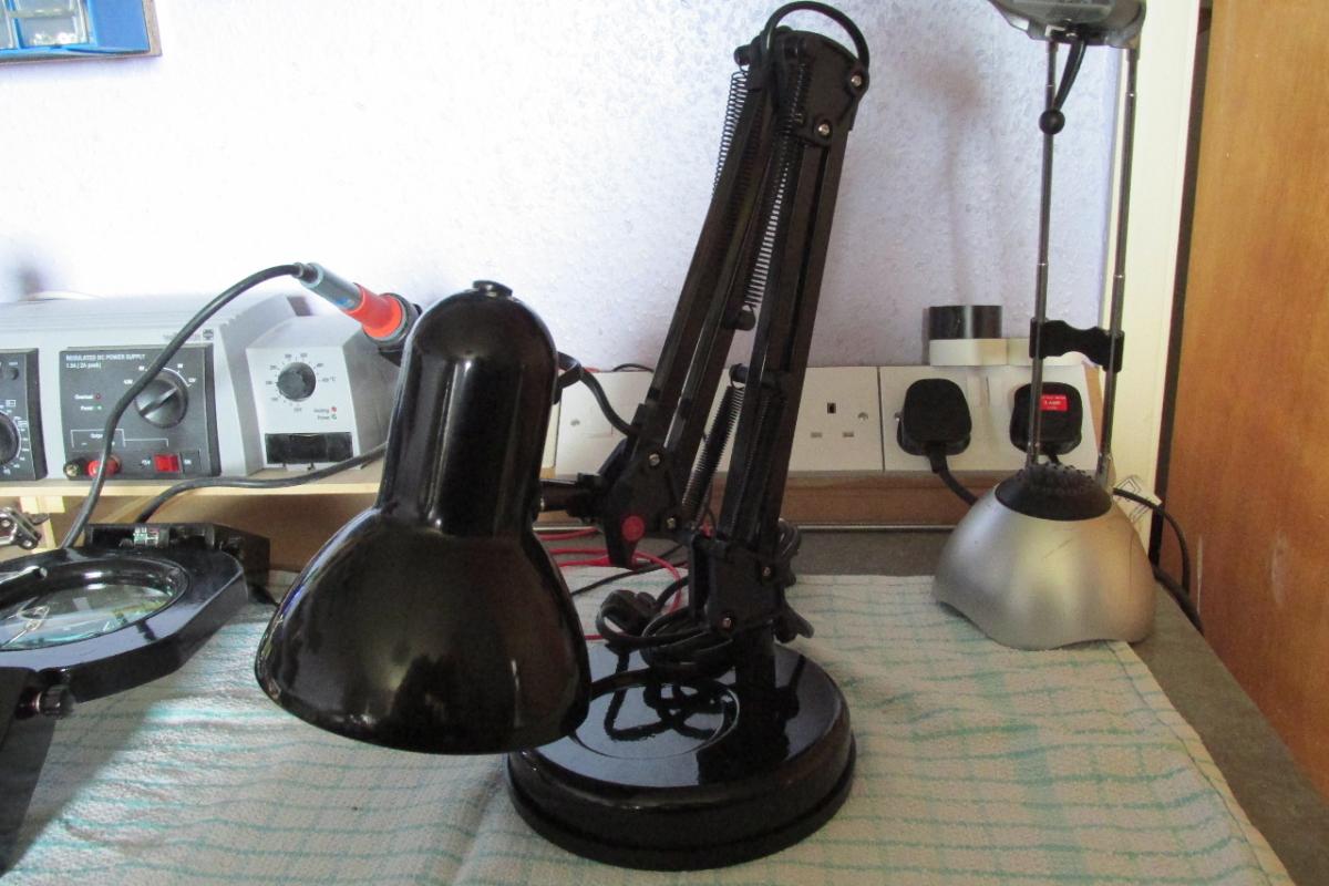

Now that the lamp head assembly is working, it’s time to mount it as a lamp.
I wanted an anglepoise type mechanism, and found on ebay a desk lamp sized one at a very reasonable price, and suitable for modification.
First step - remove the lamp head.

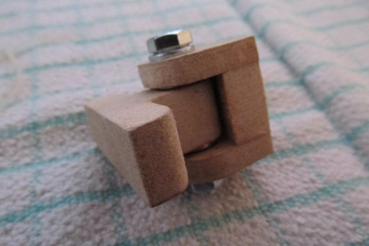

Next… I think the words “square peg” and “round hole” come to mind !!

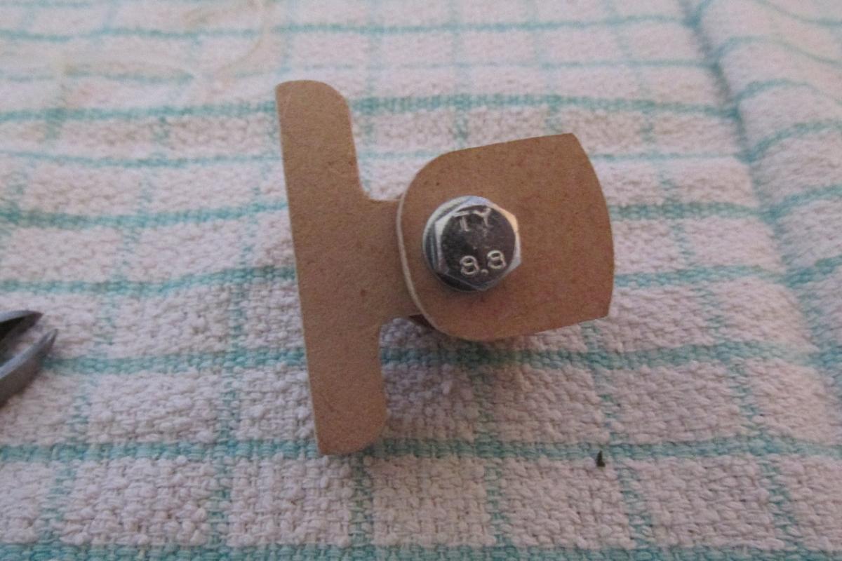

The solution was to build a linkage for that. This served two purposes… firstly to be able to attach the 2 differing surfaces together, and secondly, it provided the top pivot with a 3rd axis of rotation which it originally lacked. This enables me to be able to have the arm at virtually any angle, and still be able to align the head square to me.
The lamp is now finally finished and installed, after a lot of careful thought and experimentation to make sure the mountings at both the lamp end and the base end would be strong enough to hold the weight.
