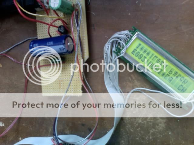

The power for the core is working fine, but the sid power is having some issues.  I’ve been using the modified c64 supply, but i think i wired something wrong because its not feeding the right voltage to the sid.  I tried running 14 volts DC from my bench supply into the sid and I hear noise and clicks when I play, but no sound.  When I tested the pins, it read that each chip was only getting 1 volt! What does that mean?  Did i stuff parts I didn’t have to when I built it or did i just muck something up?

here’s some terrible pics i took by holding up my macbook:

Is there any specific reason for you to mirror the pics?
Take all the ICs out. Don’t even think about stuffing them again until you have the correct voltages everywhere. Disconnect the pcbs from each other (this is why you shouldn’t solder cables directly to the headers).
What voltage are you feeding the SID pcb atm? AC/DC? Voltage?
i don’t know why the pics are mirrored.  thats the way my laptop took em, sorry err.
I said the voltage was 14VDC (plus the 5 volts from the core).  The cables aren’t soldered to the headers.  i used pins like a good boy.  Any advice?
The “Photobooth” application takes mirrored pics by default AFAIK.
First:  make sure you used the 7812 regulator, not the 7809.
If you remove the power, take out all the ICs, and then reapply power and test the voltages at the ICs, what do you get?
