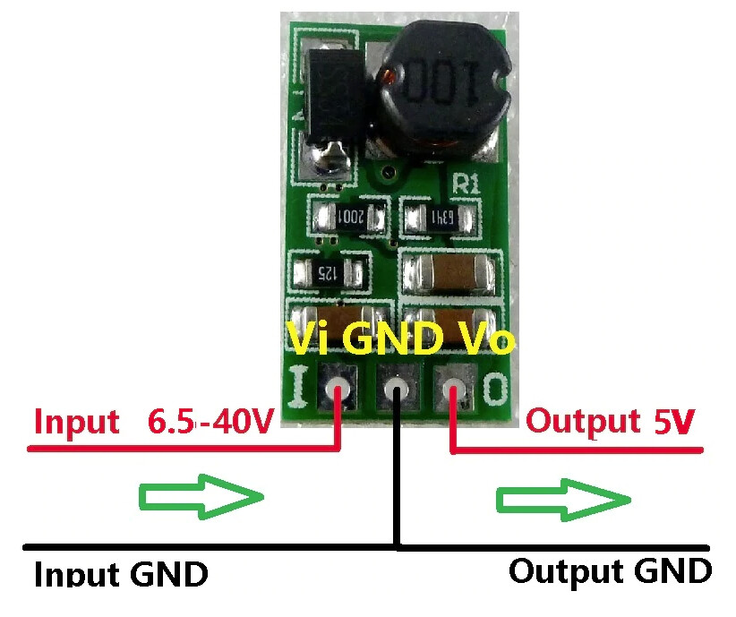

I noticed that you can find super cheap DC-DC converters on AliExpress for only a couple bucks: https://bit.ly/36LB0q9
Clearly, they’re not quite as efficient @ 76-90%, but they look like they should do the trick.
Any thoughts on these?
5V
Description:
Input voltage 6.5~40V,output 5V
Maximum output current 1A
DC-DC Step-Down Converter module working frequency 550KHz. efficiency is 76-90% .
Quiescent current: about 1.5MA
Overtemperature shutdown, input under-voltage protection, BS-voltage protection, and short circuit protection.
2.54mm pin pitch,Can directly replace the L78XX  LM78XX  TO-220 IC
I think the only thing to consider is the switching frequency, although 550KHz seems pretty high. I would expect worse filtering performance if ordering from AliExpress but I mean who knows :wink: That’s part of the fun of using AE.

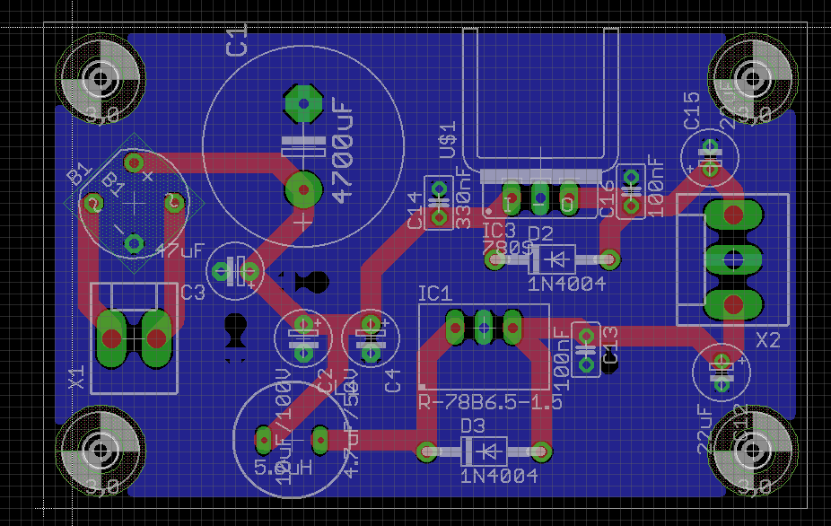

I kinda went down a bit of a rabbit hole today while looking at these. I think I still favor an external option since that’s how my MB6582 is currently setup. But I also like the idea of embracing the switchers so busted out an external board that would replacing my ugly and probably dangerous breadboard I was using previously. This would use a 12VAC transformer (might be able to get away with 9VAC perhaps - I can’t remember what I used to use). And then, much like Option E, has the Recom switcher with a linear 7809.
Since it’s external to the MB6852 mainboard I’ve got some room to add protection diodes, a choke, and some caps per the spec sheets. I thought about adding fuses too but will settle for one on the AC side I think.
I originally had a crazy 5, 9, +/- 12 design that was all linear. I still have the schematic for it but for now am not going to worry about adding any analog filters or anything. That might be better done as an MBCV project anyway where I could use the filter for other things, not just the SID.

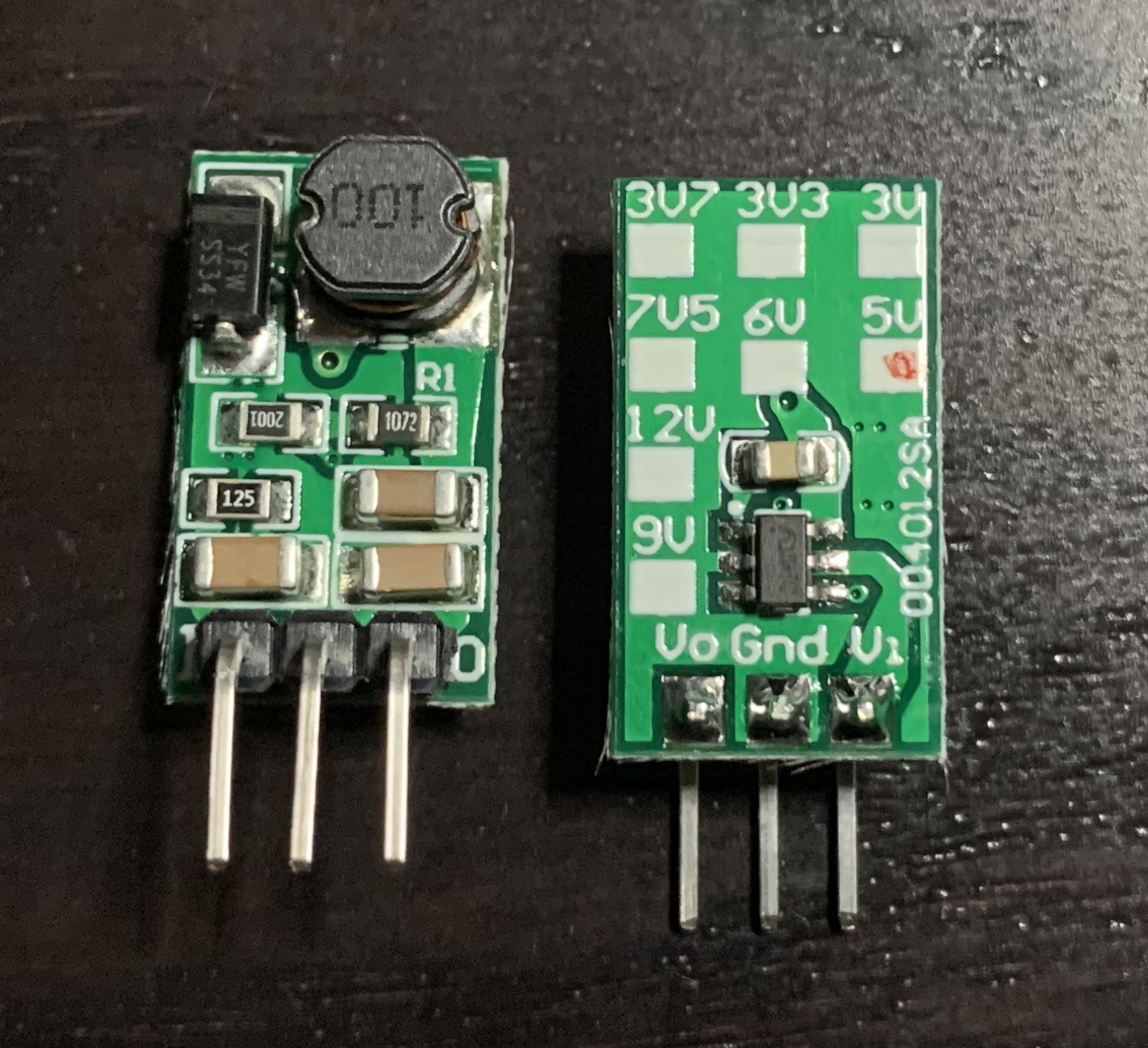

These just came in the mail… Will try to make time to test soon…
Woohoo! Excited to see what you find!
Apologies for the suspense, but I struggle to find a few free minutes sometimes…
Good news is, they test perfectly under minimal load on a breadboard.
Not sure when I’ll have a chance to test one in an actual build though.
