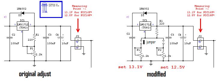

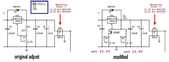

Not happy with having to readjust MCLR voltage every time I change from 18F452 to 16F84 so added attached mod.
Note: I used 4k7 presets recycled from old Sony CD drives. (My stuff is always recycled except for the PICs of course. (anyone know of a source yet?)
