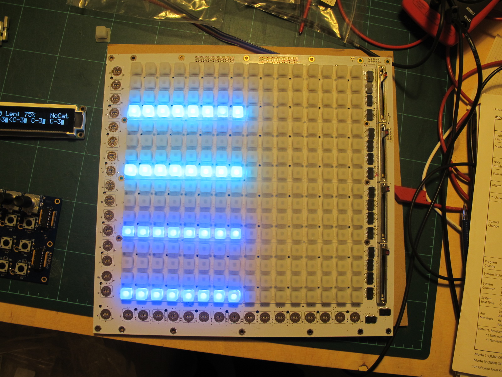

I have a strange issue with my newly built BLM:
When I start the SEQV4 and select all 16 steps in the selected Track (G1T1), then switch to the length layer and then to the velocity layer the BLM stalls with the “pattern” showed on the picture.
I have to unplug it to fix it.
Besides that everything works as supposed. In test mode I can lit all led at once.  I have the PICF184685 so I suppose the brown out reset is not the issue and I run the newest firmware (project_with_4_mapped_ains)
Before I put everything in the case I want to be sure it’s not a hardware bug.
Any ideas what my problem is?
Thanks Michael
Can you measure the main power rail voltage in this state? E.g. using the J3 jumper? Just on the weekend I was happily switching between layers (you should get a kind of VU meter display).

Everything works fine as long as I don’t activate more than 10 steps (and not choosing too many at the boarder eg. steps 1,2,3 or 14,15,16) and I get the “VU meter display”.
Like that the voltage drops down to 4.4v
if i lit all 16 steps it stalls with 4.25v
just checked my PSU: it’s a cheap cellphone usb adapter with 1A. too little?
sounds like too little! :slight_smile:
ok my bad. at least it’s easy to fix!
One trick might be to disconnect the SEQ’s LCDs to do the test, perhaps that way you can determine if the PSU is strong enough or if the problem is present on the BLM side with the low voltage.

I just powered my SEQ with my Lab PSU and everything works perfect!
thanks and sorry for the noise. still in the early beginning with electronics…
