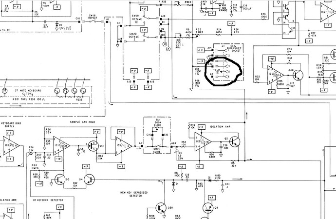

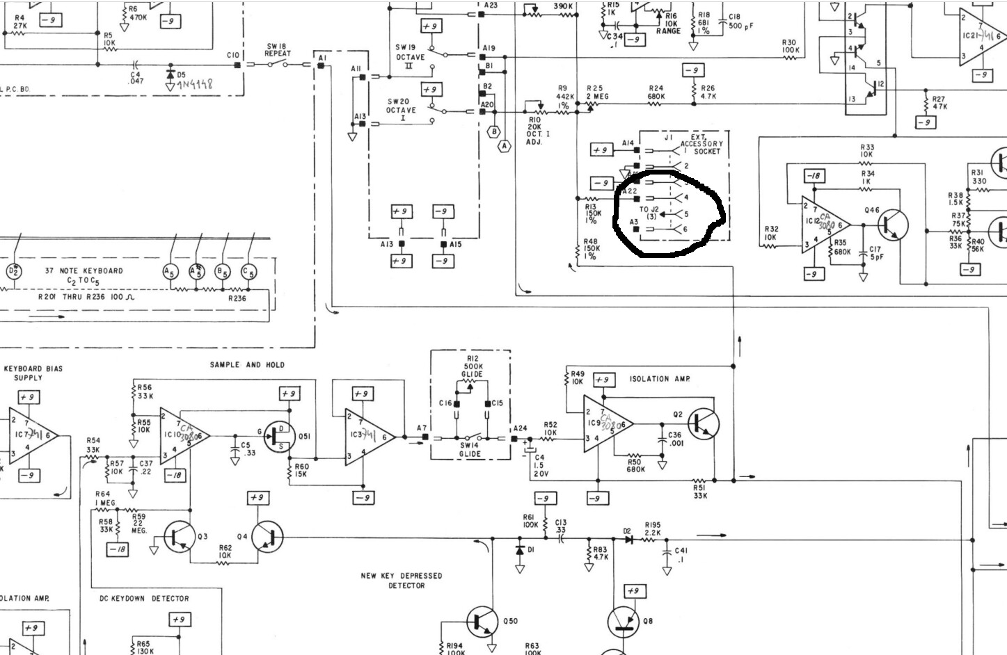

Here’s the schematic from the satellite, which is much clearer than the MinitMoog schematic that is available. They use the same main board. I am applying the CV in to pin 4 on the accessory jack. This feeds into the DC Summer via a 150k resistor like the keyboard circuit does.

I think that you maybe do this the wrong way. (I just find the whole service manual for the satelite)
Let try this:
First, measure Q2 emitter voltage (junction Q2E/R48/R51) for lower key press, and higher key press, you’ll have the KB voltage range that feed the summing amp…
I suspect you won’t have a +/-4.5V range here… this will define the requested range at R13/A22 junction for the same behaviour at summing amp as summing resistors have same value (R13 and R48)
Only when we know that we can go further… (and maybe just change R13…)
I guess you won’t have any correct result whatever CV system you use if we don’t clear this.
Best
Zam
side note 1, as this “accessory socket” is offered with +/-9V(J1-1 and J1-3) for the external pot biasing or whatever you use to initially modulate at A22, I guess that’s the limit you can feed to the summing amp (whatever the scale VS octave is)
side note 2, I don’t find J2-3 (coming from J1-5) which might be for trig ???
Update.
My math confirm your 3V/oct at J1-4
If you want to use 1V/oct CV you can change R13 from 150k to 50k, maybe it’s the simplest option…

For the math, I see that we have a 1 octave sw that send 9V to sum amp via 450K (442+20K trim, I suspect 450K nominal calibration setting) I deduce that 1 octave is 20uA for the summing amp… after that it’s all ohm law again…

Side note: this entry point CV at summing amp is a OSC modulator, you won’t trig note here ! nor modulating the filter via key
Ah, yes, I see that J2 is the External Filter jack. So if nothing is connected to that jack, the accessory jack can be used to control the filter. I’ll have to see if pin 6 is connected to anything. To me, it seems strange for Moog to provide a CV input with out some sort of gate. On my synth, the jack is actually covered by a plate with rivets, so I guess they decided to not pursue any accessories.

I am sending an 8V trigger through a diode and 2.2k resister to the junction between R195 and C41.

as I say, it’s a OSC modulator, not a note CV, you have to think it as a “pitchbend”
maybe that’s why you encounter strange behaviour, if KB trig and/or sample & hold circuit keep some voltage at IC9/Q2 output, then your ext CV at R13 is just adding/subtracting to sum amp what’s coming from R48…
I suspect you should “reset” KB trig in the mean time you gate from external if you want to use J1-4 to “play” a note
