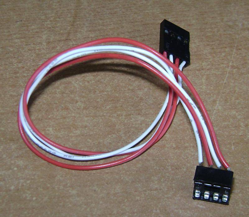

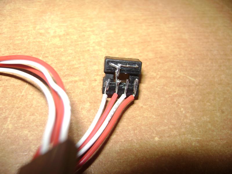

As a temporary solution I soldered 4 short wires to the 8-pin socket with bent legs, and on the other side I mounted a connector. It works like a charm and I can switch it really fast between cores. I think it’s the easiest and quickest solution, that doesn’t involve soldering your chip directly to the pins on the core module.
