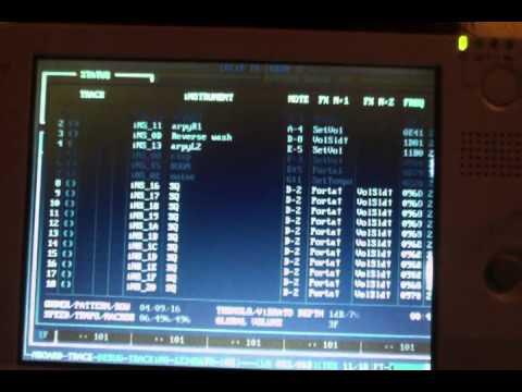

A quick way surely would be to build or buy an oldschool PC and install some DOS software on it. Some musicians are pushing the OPL3 to its limits using that setup, e.g. “Diode Milliampere”:
To simplify things, and have a portable music player, you could just buy e.g. an old Toshiba Libretto laptop :-).
