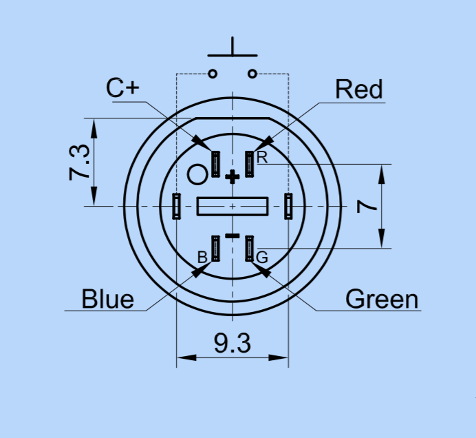

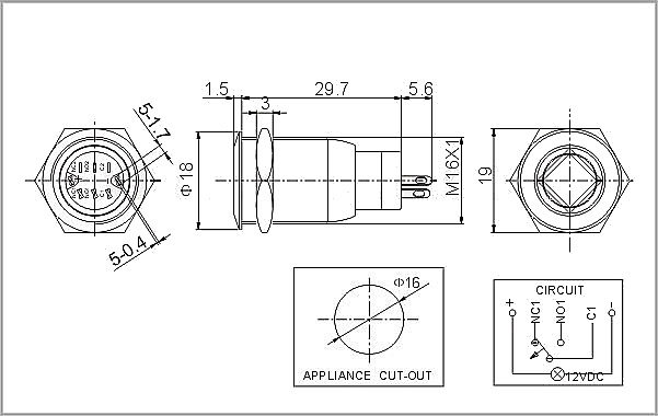

Are you sure you have the pins of the switch correct? Best would be between NO1 (DIN) and C1 (0V). Between NC1 and NO1 will not show a difference. Between NC1 and C1 should give an event with inverted behaviour.  Or is your switch different to that pictured (are individual RGB pins available?)
the switch pins are connected as you wrote: C1=0V NO1 to DIN
the scematic above is indeed an other button, a single color. i test the button behaviour with this one for the moment. The other RGB LED/switch looks like this this:
But anyway  it’s not working either with the RGB button switch…
i think the problem has to be somewhere else…
As shown in the above image, the C+ pin is not connected to the switch and the other two terminals (left and right, between C+/B and R/G respectively). should be used. But try with jumpers directly on the pinheader too.
sorry man, thank you million for your help but you are going into the wrong direction. lets forget the rgb button! i managed to get the leds work, i’m aware about the common anode…
