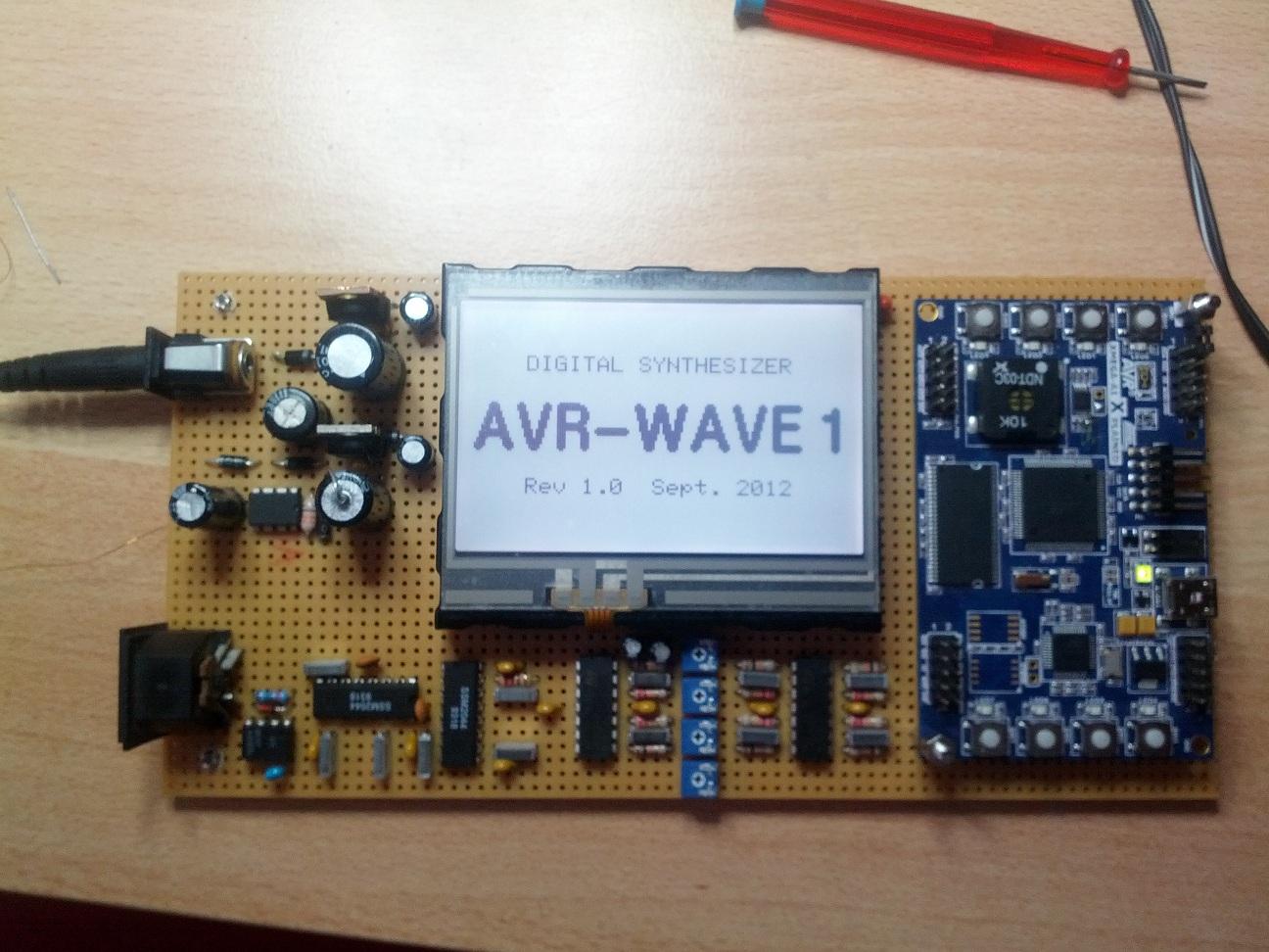

12Bit Stereo Synthesizer with Touch-Panal

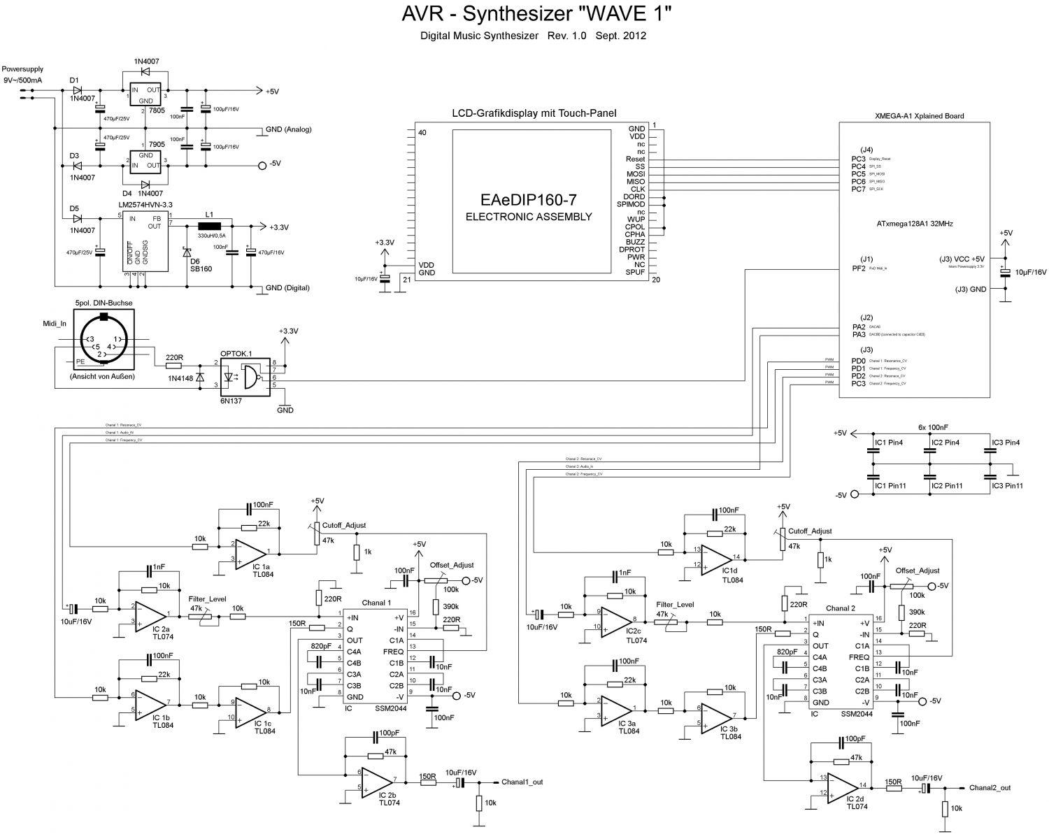

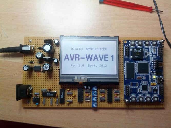

AVR Synthi Hardware
Synthesizer Rev1.0

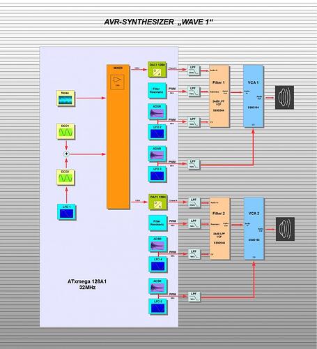

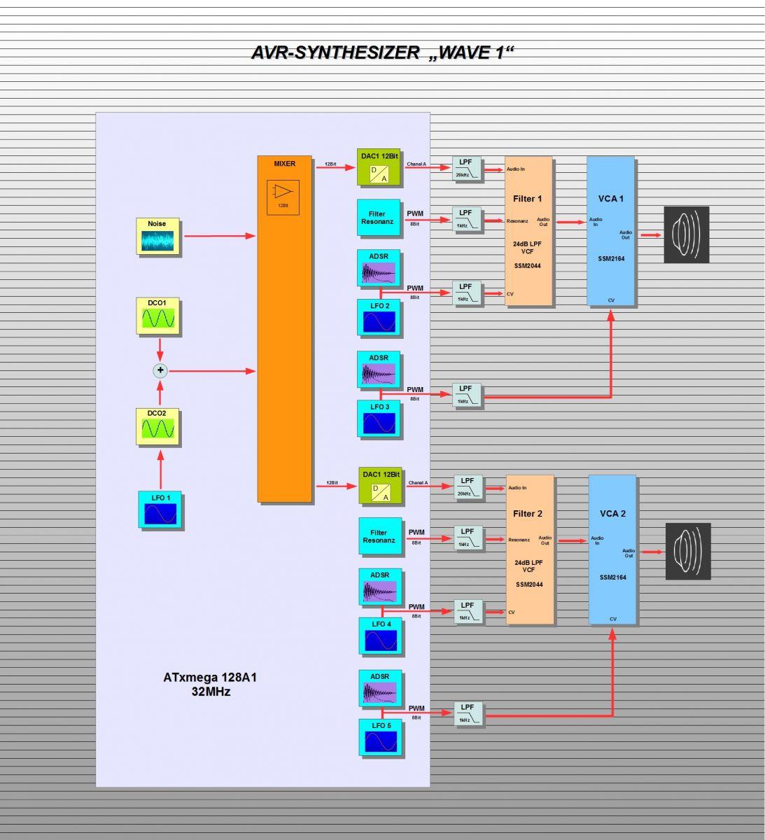

Synthi Block 02[1]
AVR-Synthesizer 2x 12Bit DAC, 2x VCF, 2x VCA, Touch-Screen and Encoder

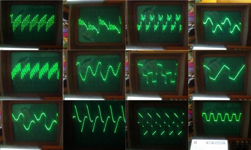

Waves[1]
A lot of wave from my AVR-Synthi

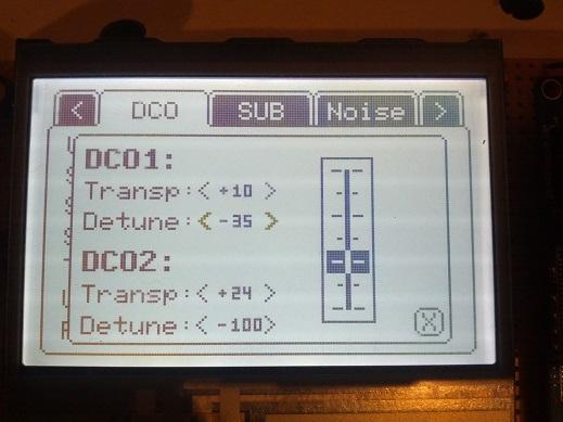

Tune Menu[1]
Re: Waves[1]
sexy !!! :shifty:
Re: Waves[1]
waves , oh, beatiful wa(v)ys..
Re: Waves[1]
Hallo
I have installed the new VCA-Chips SSM2164D on my synth and hope its not noise. Before that i had only VCF-Chips to output and it was noise when silence. The VCA-Funktion was softwarebased in the XMega-Prozessor. Now i controled the output-signal to the VCA-Chips with the pwm-signal from Xmega-Prozessor.
Greetings Rolf
