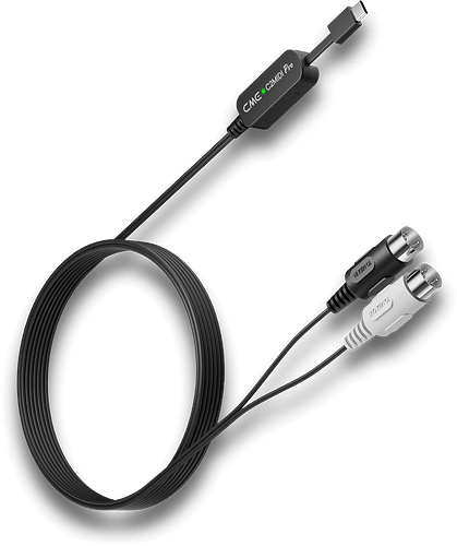

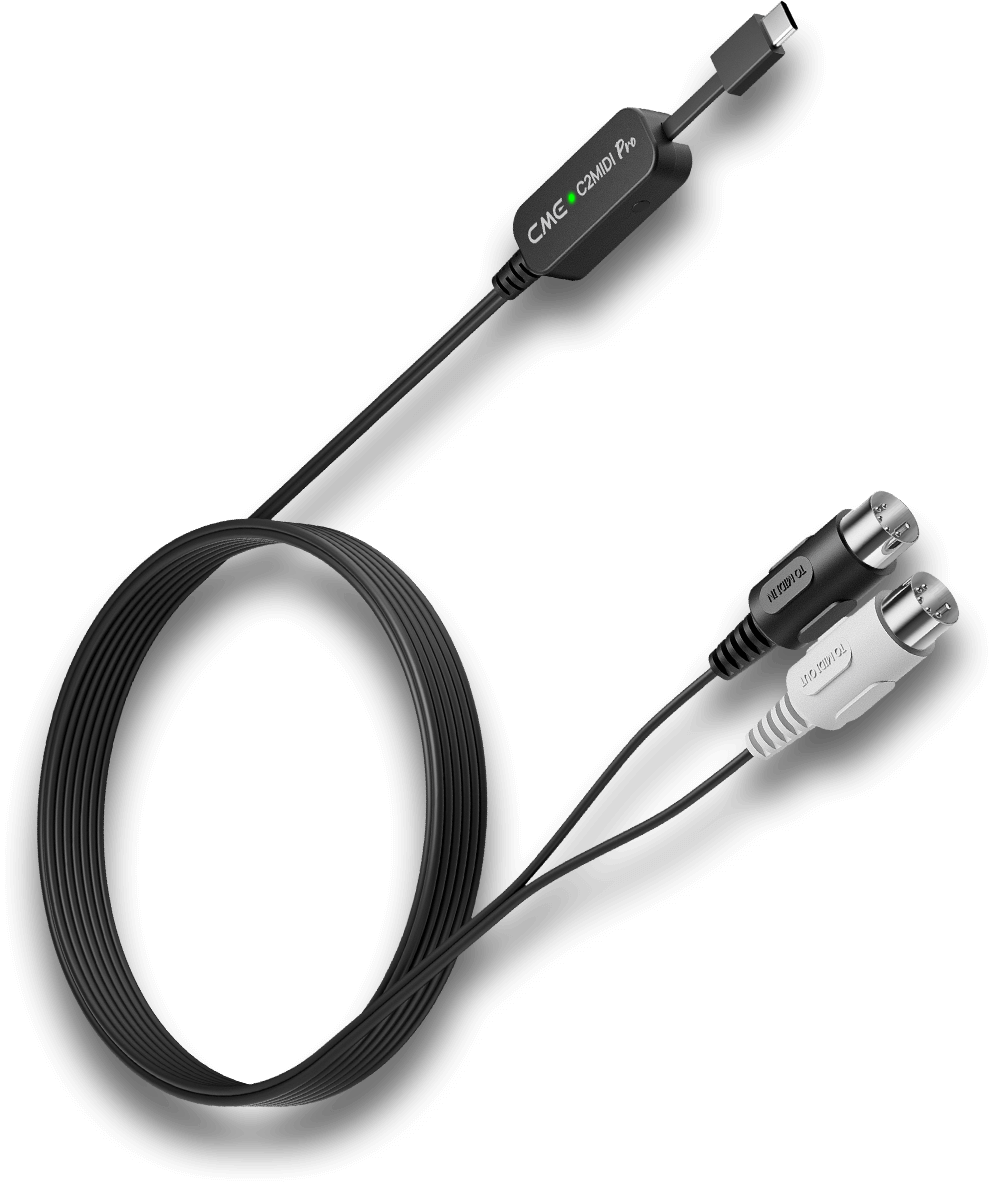

But i like CME as a brand and haven’t tried this one yet:
On paper it should do what you want and it is not overly expensive at below 30€, maybe give it a try and report back?
