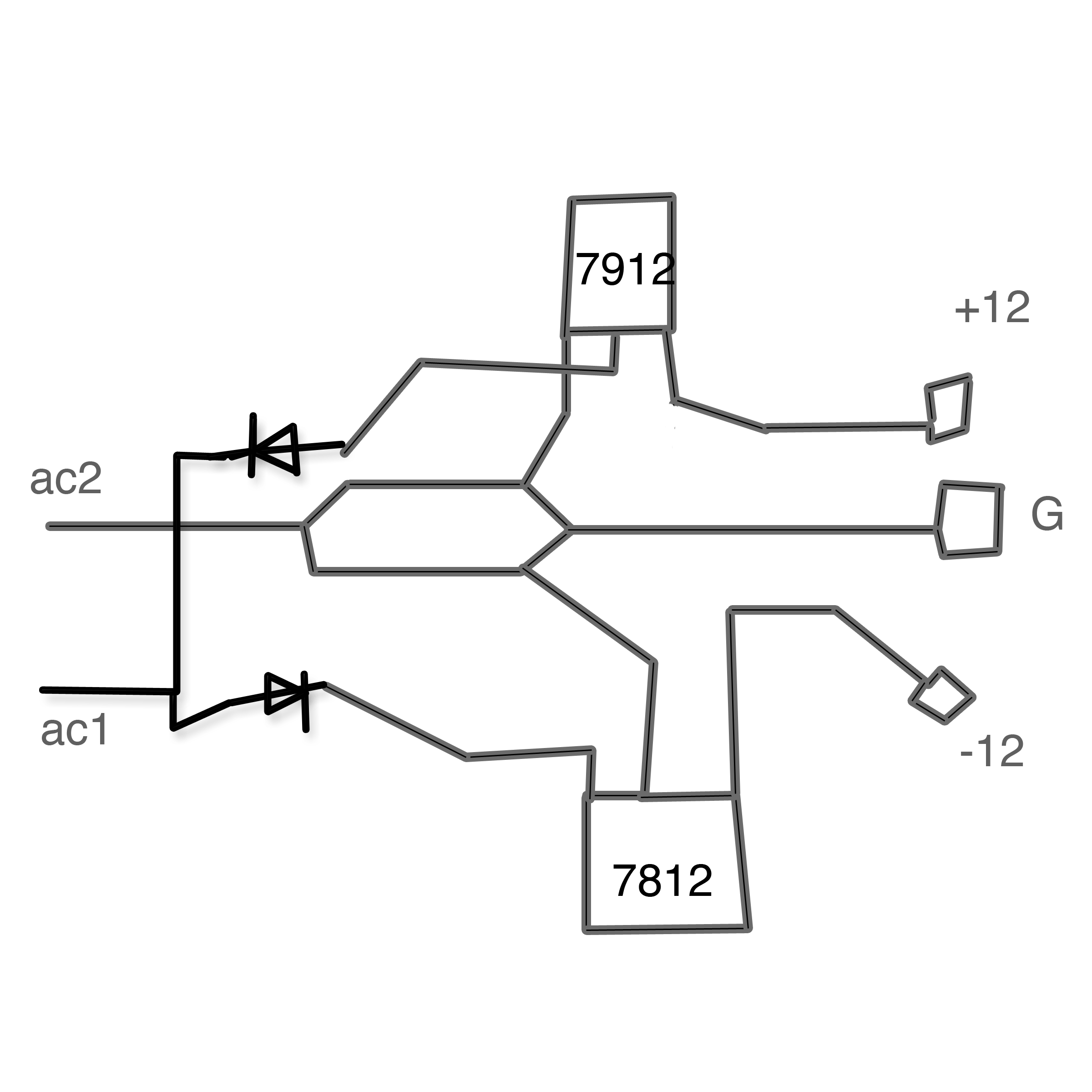

Also I am worried about grounding my ±12v power supply to my case, it’s a Canakit where the middle gnd appears to be one of the AC lines. This does not seem kosher to me, but I have no idea about such a thing.

…it’s a Canakit where the middle gnd appears to be one of the AC lines. …
i have little doubt that this is the source of your troubles. it must be that you have the neutral ac line connected to ground in your circuit, which is in turn connected to the shield on your cables. this is no good in general, and very bad if the outlet wiring has hot and neutral reversed (a common error)
if so, you should be able to break the connection between the ac side and your circuit ground at the psu…
and only the earth ac line (not neutral) should ever be connected to the chassis
Here is the schematic of this particular circuit. It does not include the capacitors to keep it more simple. Though the pointless fork may confuse you, it’s just there for the sake of the capacitors which aren’t included.
So you can see that on AC line is directly taken as GND. Is that kosher?
7912 +12V / 7812 -12V ? Is it wired that way too?

make sure that neutral on the primary side of your transformer is not connected to gnd. if it’s not, then try swapping the ac inputs on the secondary side, i think it might be a phase issue…
Okay, thanks. I will give that try. But I guess I still can’t ground the common to the case?
Also, if anyone does have a schematic for a bipolar circuit using either two transformers or a center-tap, I’m all ears.
…But I guess I still can’t ground the common to the case?..
i wouldn’t, but it might be difficult to avoid if you use metal jacks…
