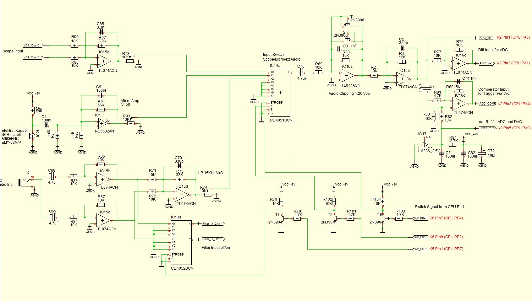

My miniscope circuit with xmega128 MCU. I sample with 12Bit/40KHz one cannel.
Input signal is clipping with IC16a. For best noise reduction i make ADC in Differential Input Mode. The comperator input is for trigger function. For better Ref Voltage i need an LM336 with 2.5 Volt.
Thanks a lot for sharing this Rolf, this is really nice from you !
I download the scheme and give it a deeper analytic review .
