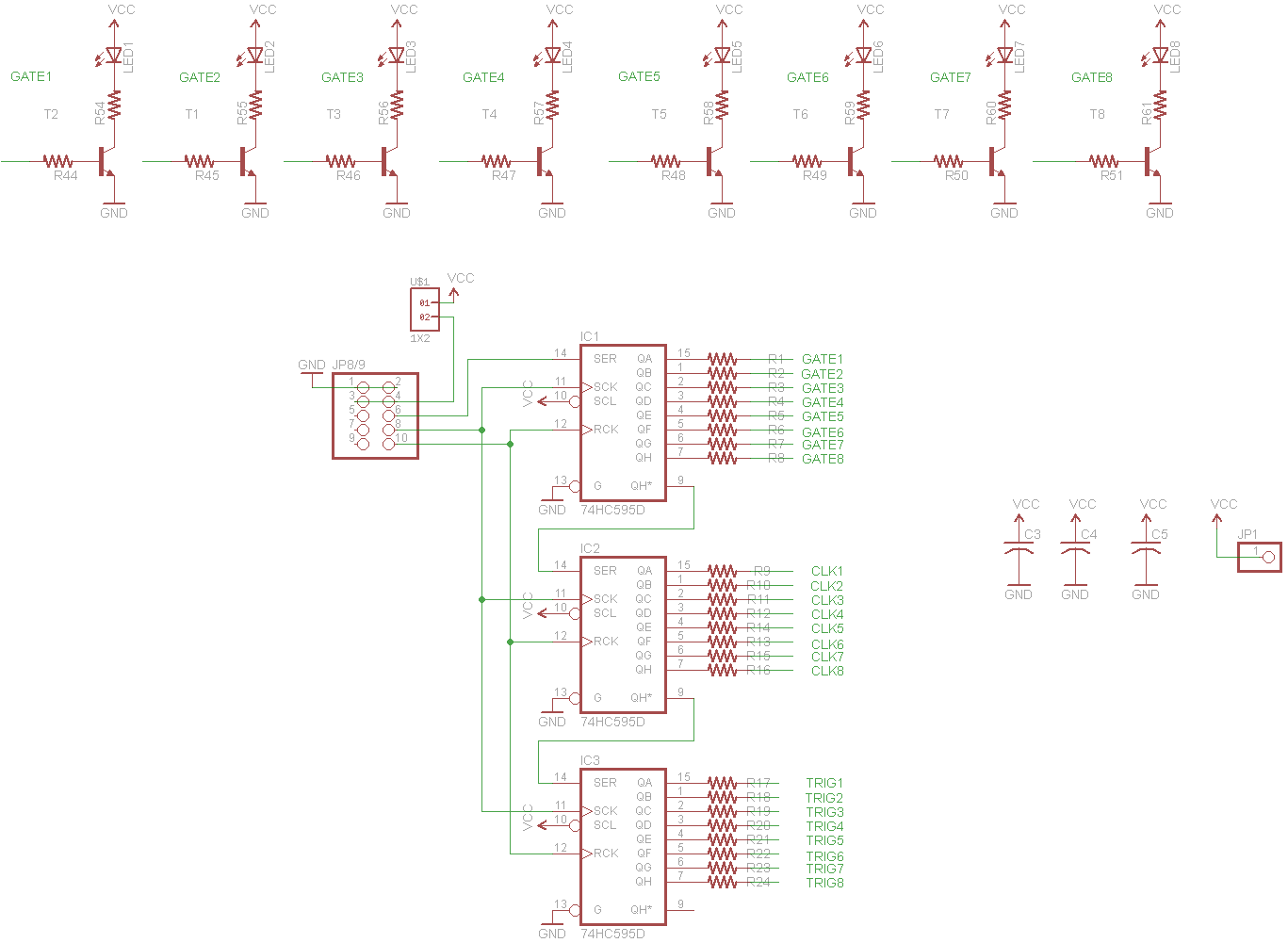

  • More room means more outputs: module  will now have CV/Gate/Clock/triggers
  • LED indicators for the gate

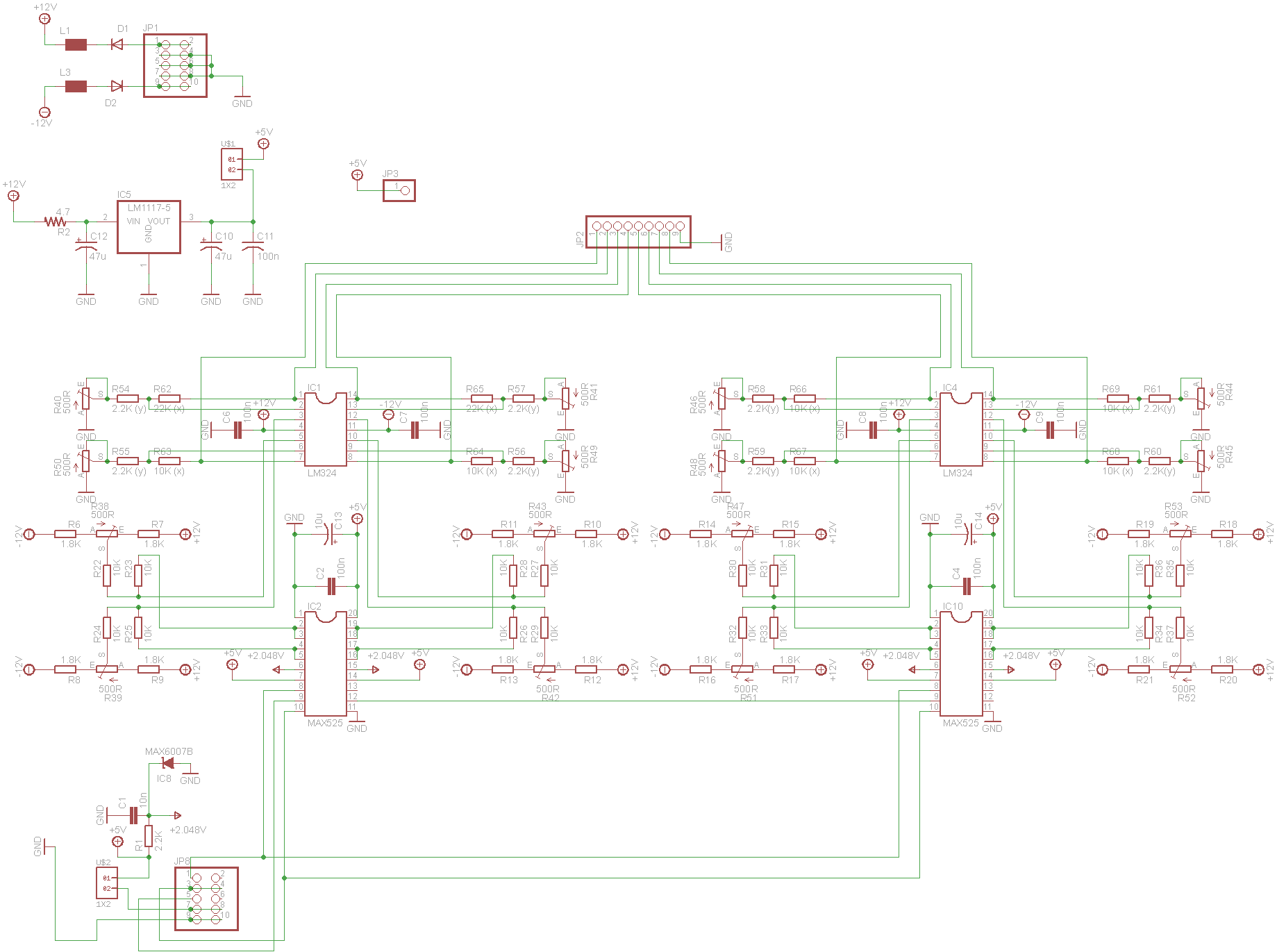

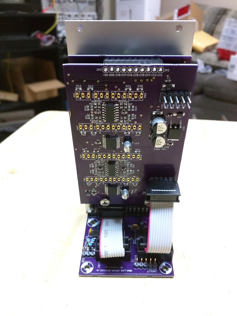

I’ve provisioned the boards for either +5 from the euro power or from the core.  Testing will be needed to see which works better.  This is pretty much done as far as the routing, everything passed DRC and what not but I encourage people to glance at it to see if I made any mistakes.
Jack board.
Schemactic:
The Aout Board
And the 12HP panel.  People will be able to place the line driver wherever they like, it does not have to be mounted to the panel.

I think having a jumper to isolate the 5v remote supply coming from the DB25 cable would be good assuming  the module is powered by a 16 pin header with a 5v line.
I’ve thought about that.  I dont know if I want to use 5V off the euro header, that seems to be frowned on.  If there is room, I’ll add a 5V Reg and have jumpers to power it from the core as well
I already have PCBs for this (as of yet untested):
It’s a dual design board for AIN and AOUT of 100x50 mm and includes my range switching ideas (bipolar +5/-5, 0-5 and 0-10). It lines up with my AIN and AOUT boards which would be panel mounted by their attenuator pots and connected through IDCs.
DOUT comes in from the right, and there’s two channels of MOSFET level shifting. I think the DOUT is mirrored in this case, but as long as you’re in the know it’s easy to adjust one end of the cable :).
There’s a hex Schmitt trigger which will condition a clock for AIN and drives LEDs on the remaining 4 channels.

  • Remaining DOUT ports.  If there is room for four 595s on the IO board (and there should be), i think I would be cool to make an expander (just 2 rows of 8 3.5mm jacks) for the clocks and triggers that are supported.  I considered doing this on the I/O board itself but then that really eats into the real estate.  Thoughts?
Any and all input is welcome..
