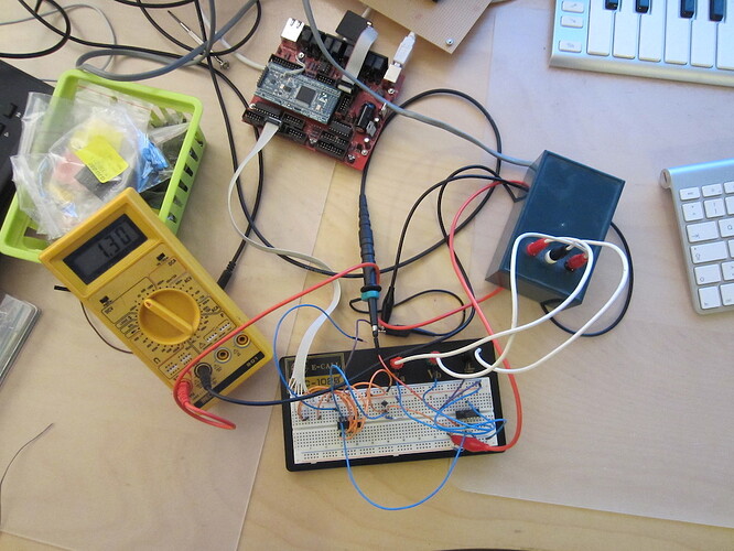

Ok, it works. :smile:
At least on the breadboard:
