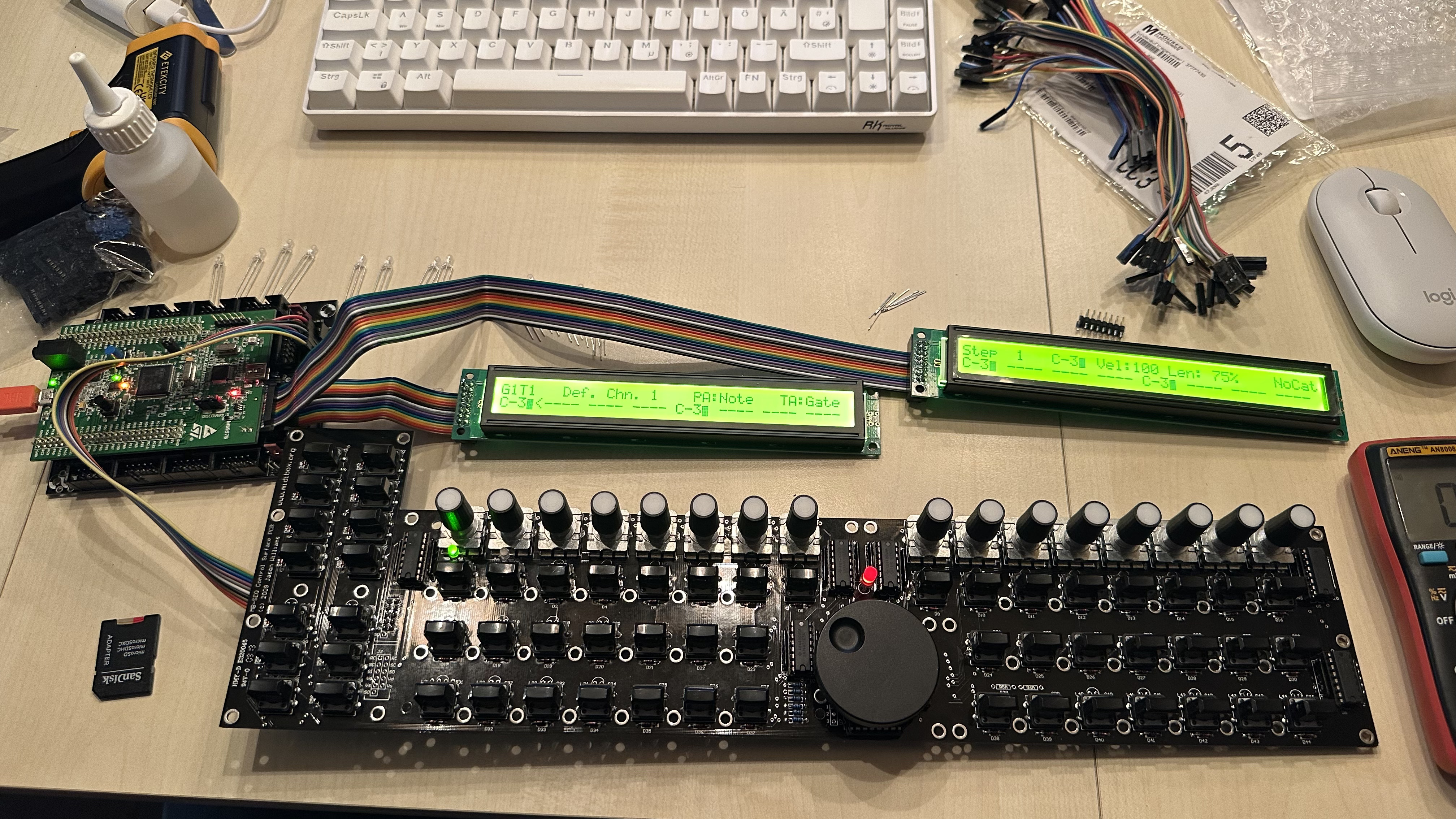

I decided to build a SEQ V4 with Wilba’s front panel. Getting the parts and PCBs was a bit tricky, especially since the front panel PCB can only be sourced from the U. S. which took several weeks.
First light:

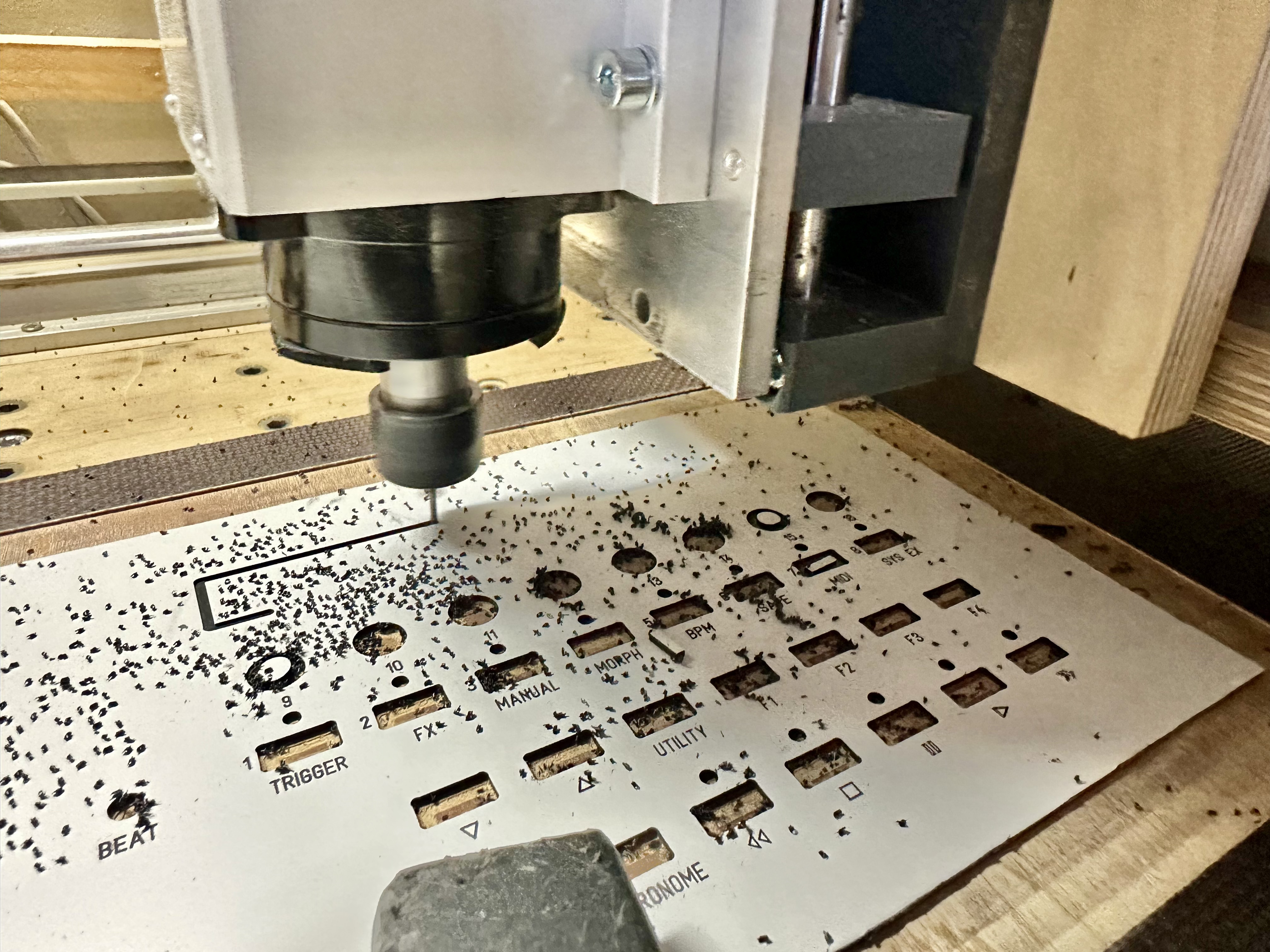

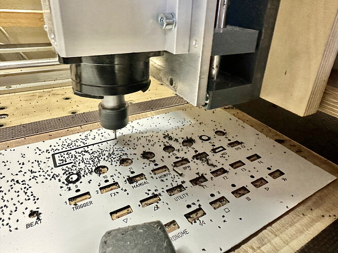

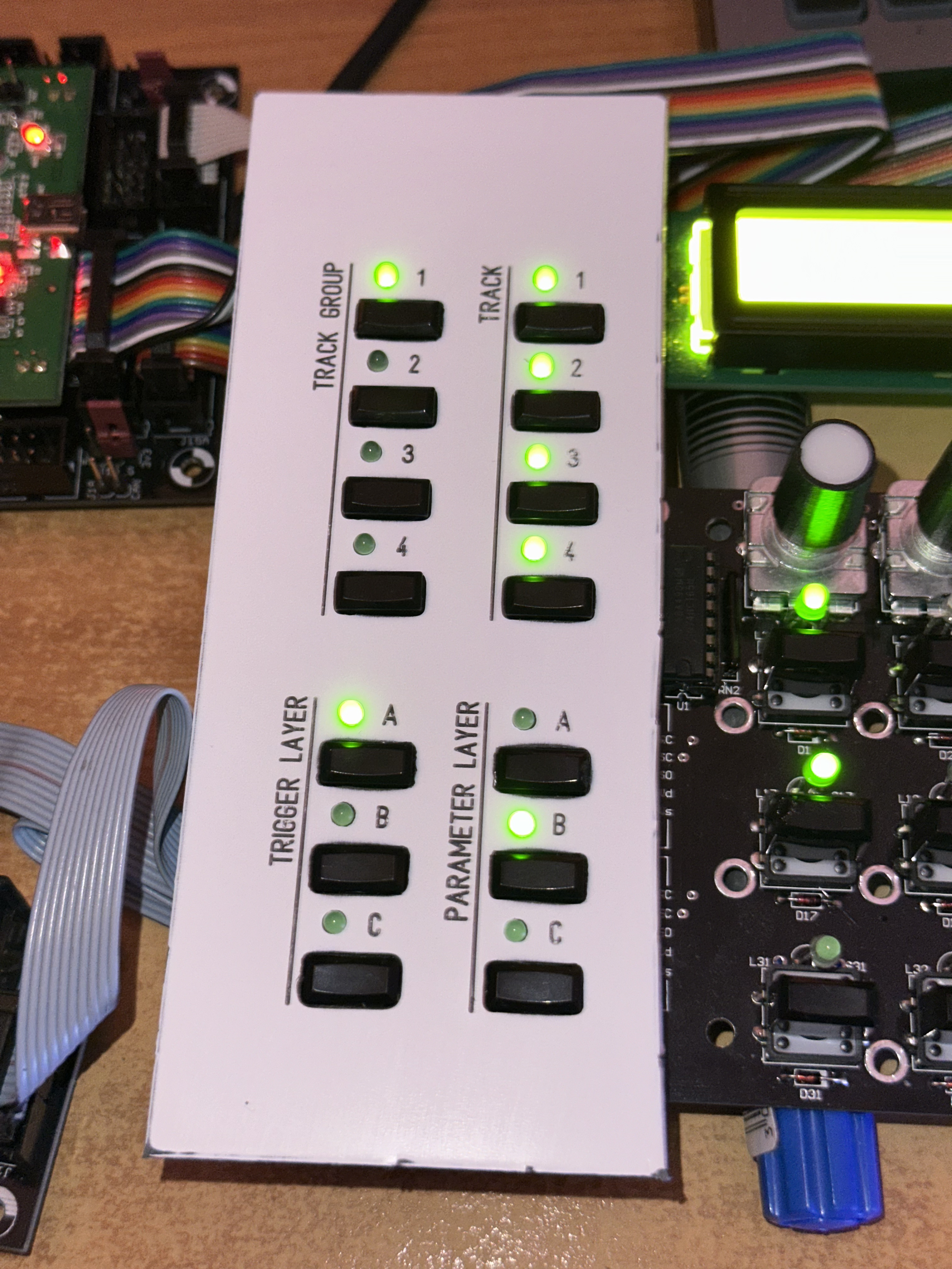

The front panel would be one of the most expensive components - 244 € was simply too much for me, so I opted for a DIY version. I used my CNC mill for engraving the letters and symbols which turned out quite nicely.
Front panel proof of concept:
Milling the front panel:
