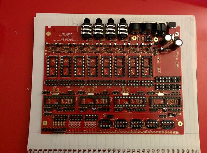

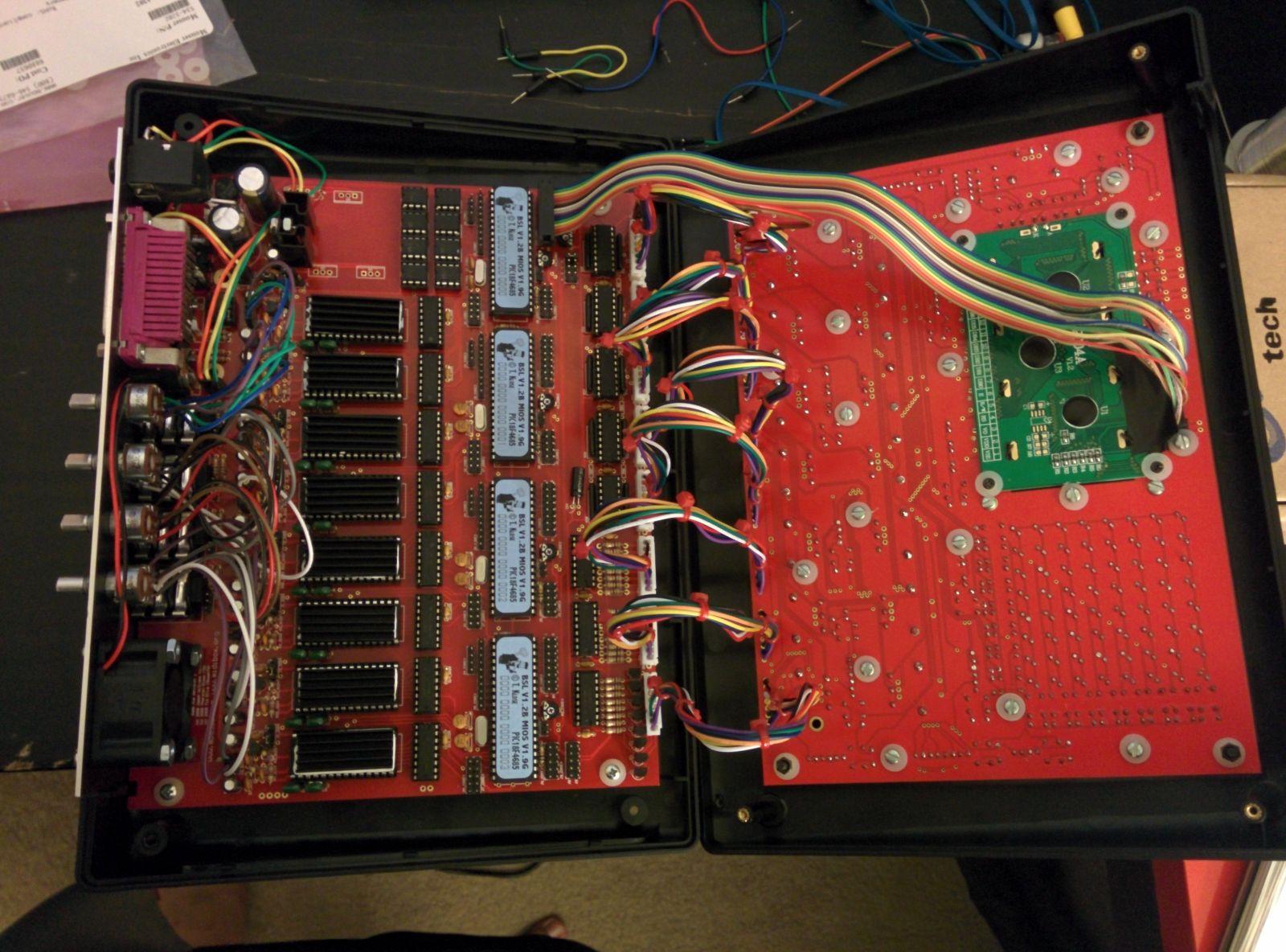

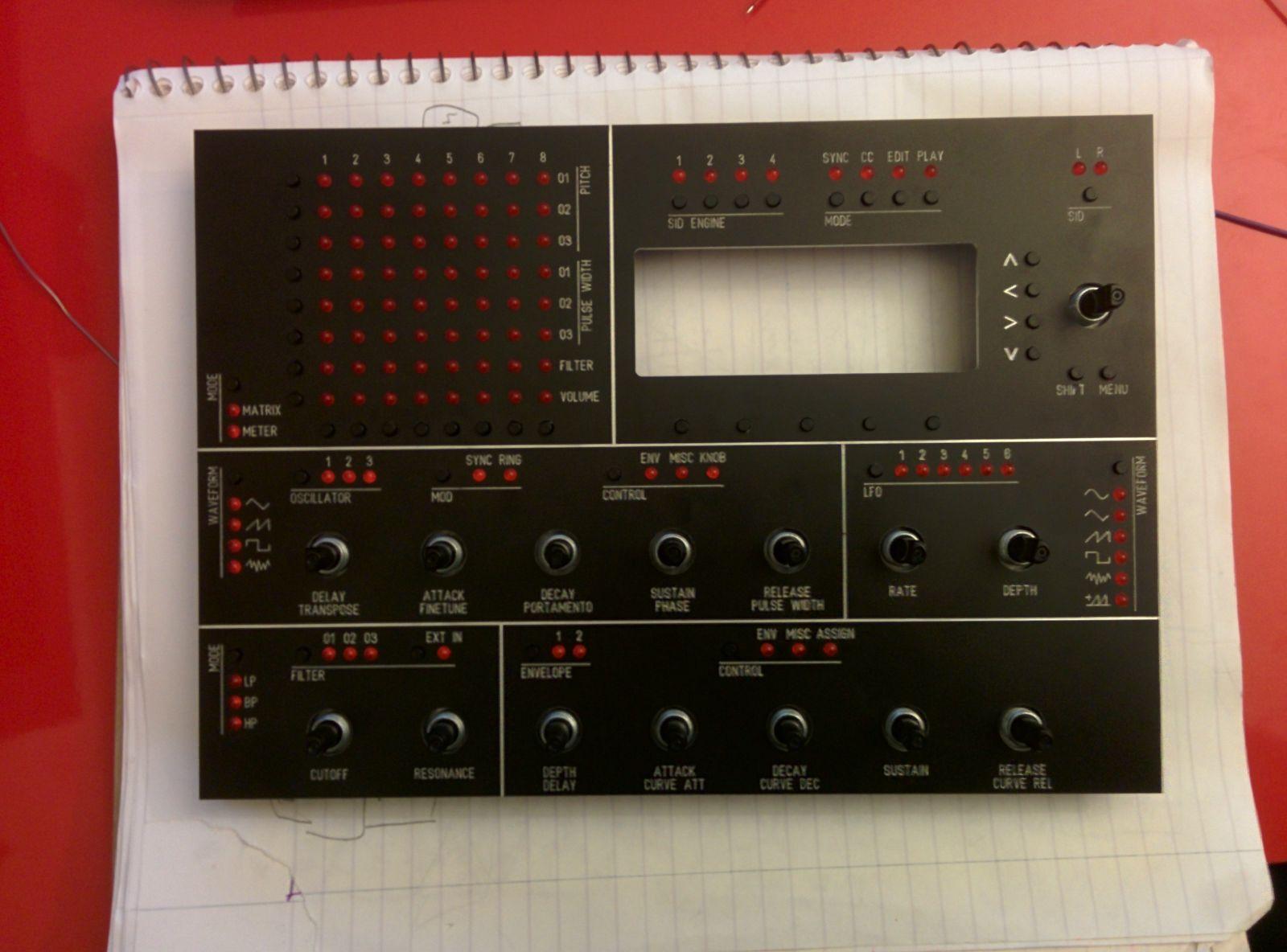

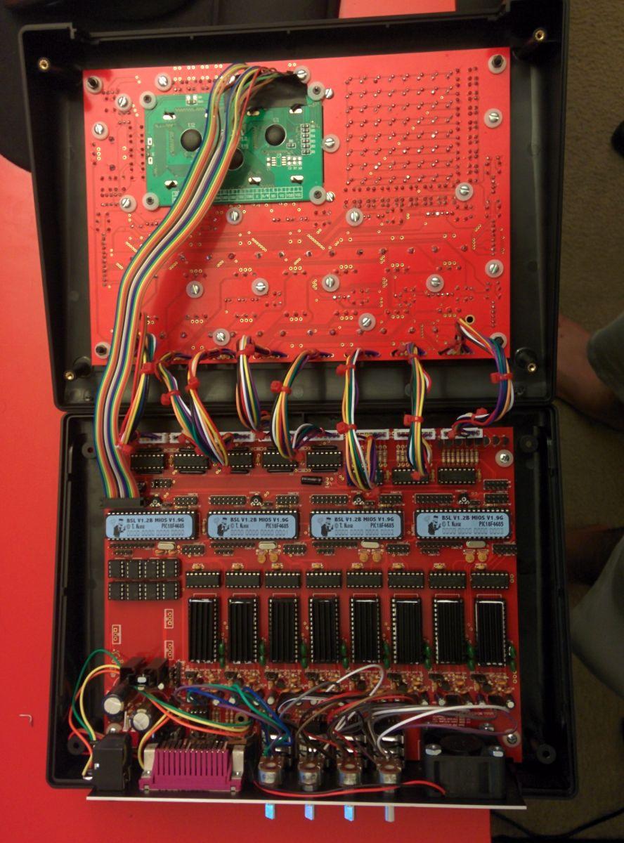

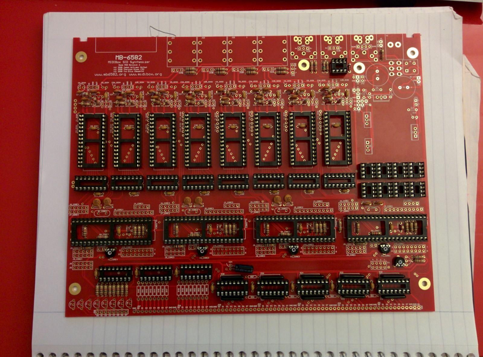

Another MB-6582 enters the world
Album by Magus517707

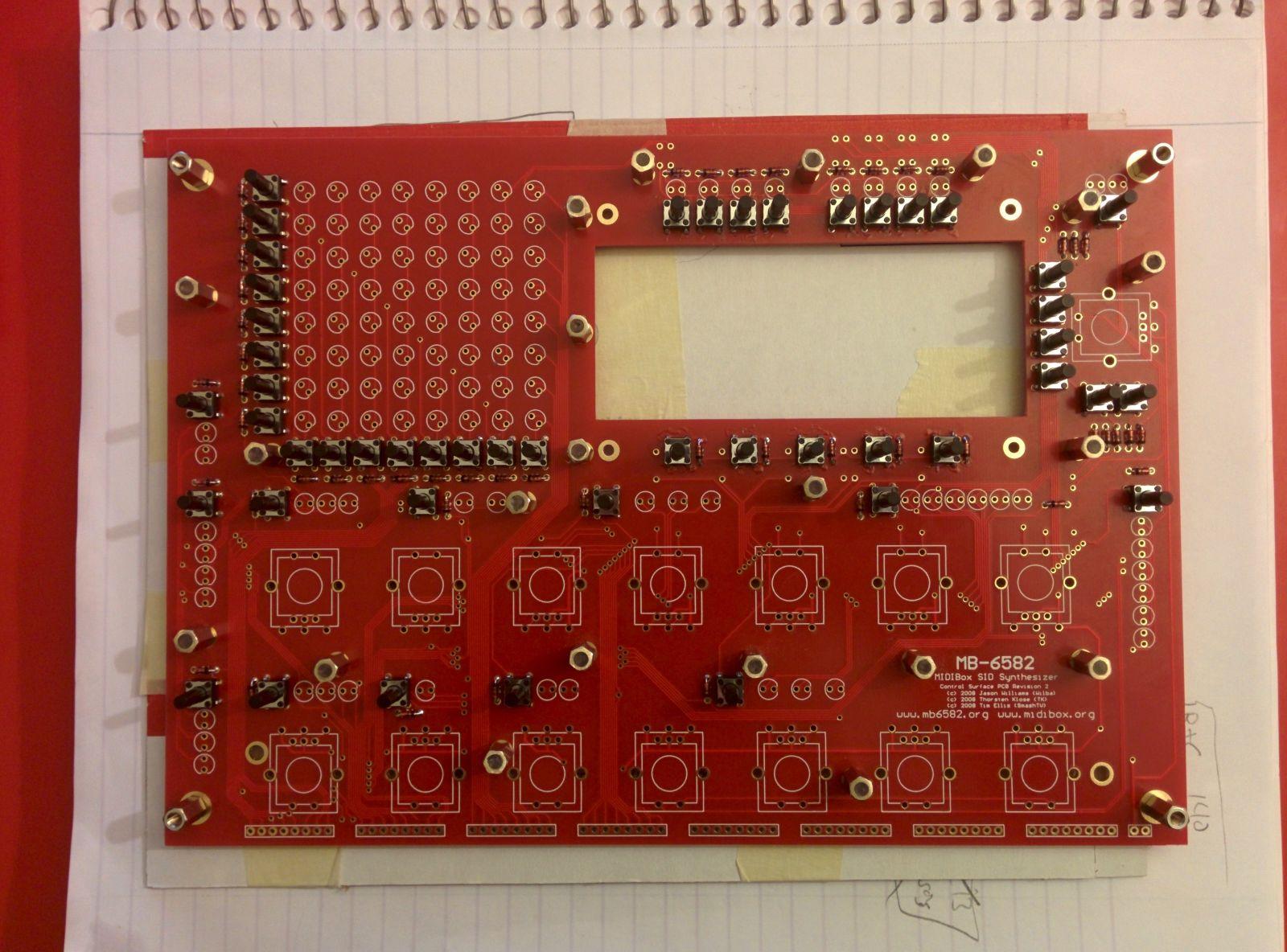

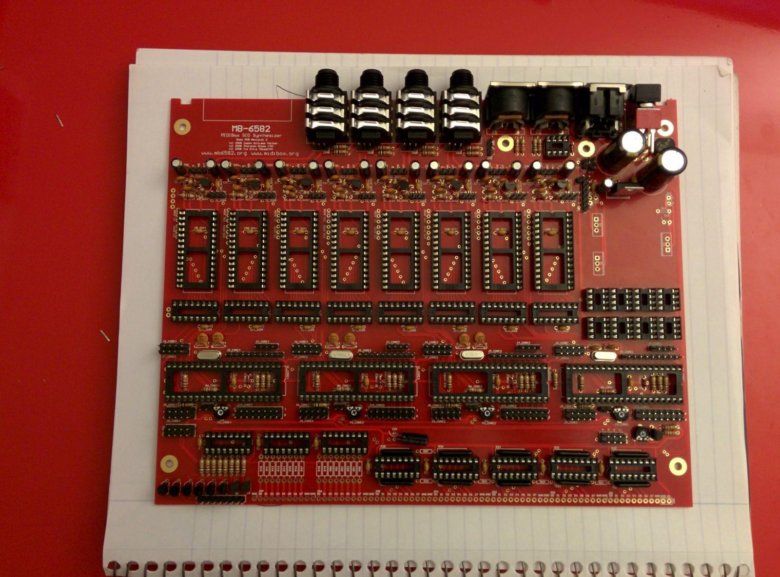

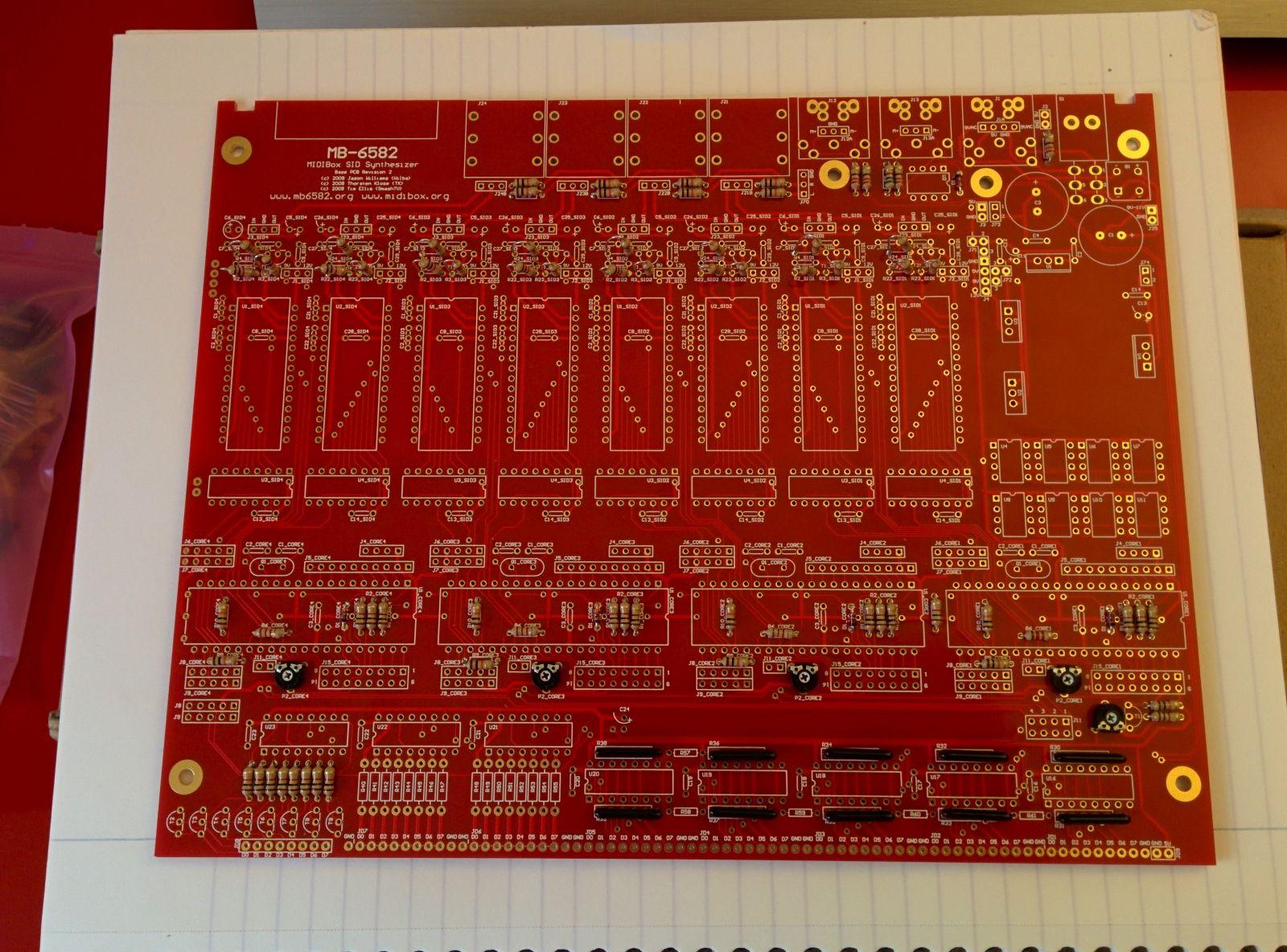

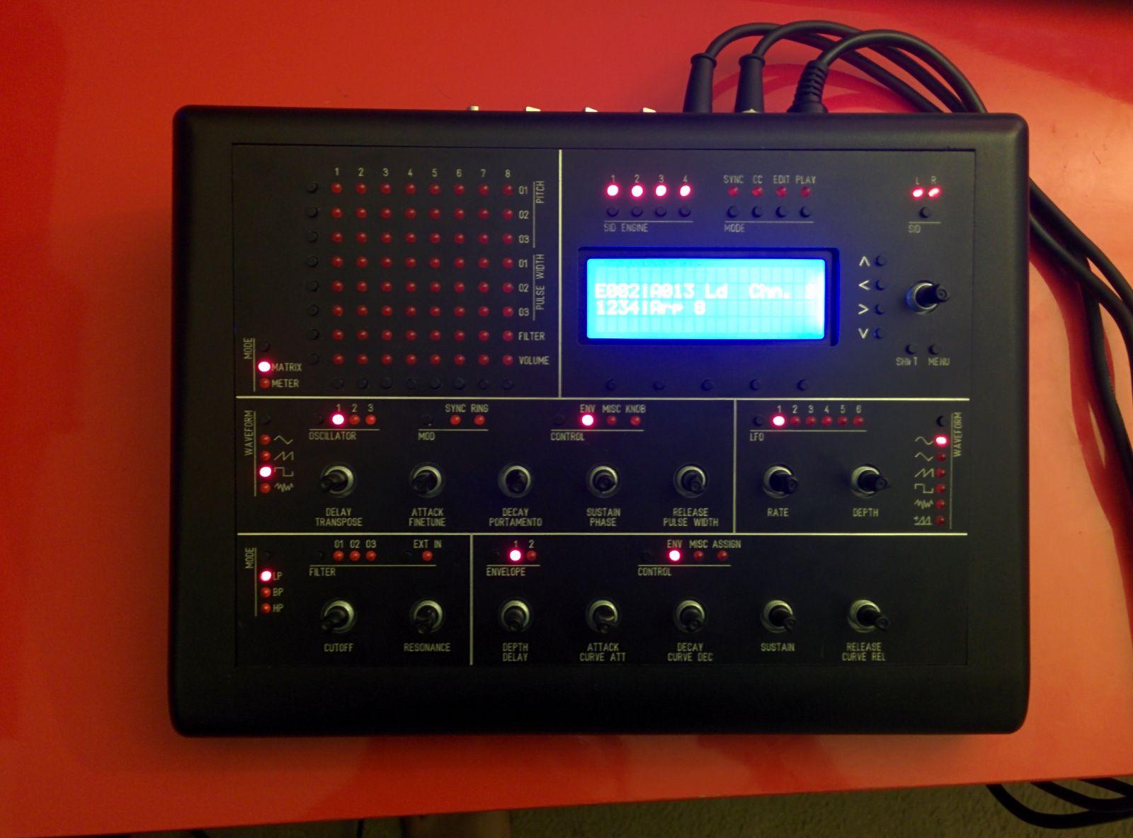

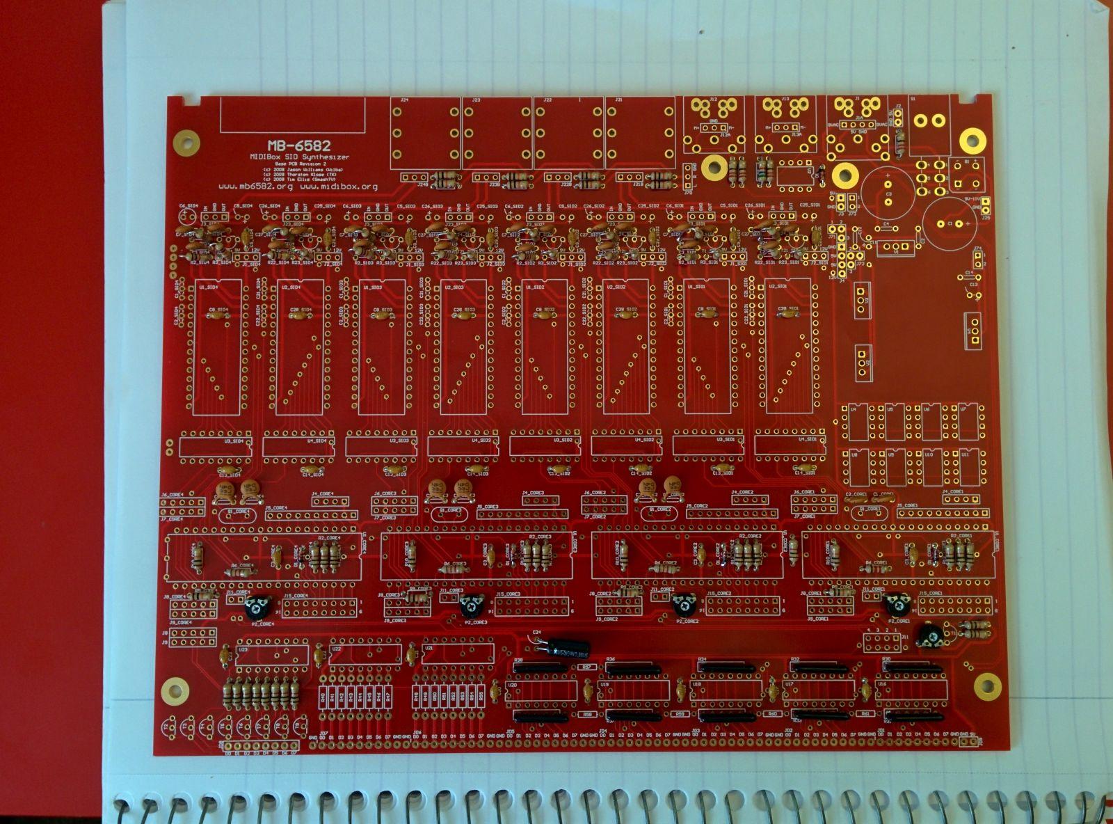

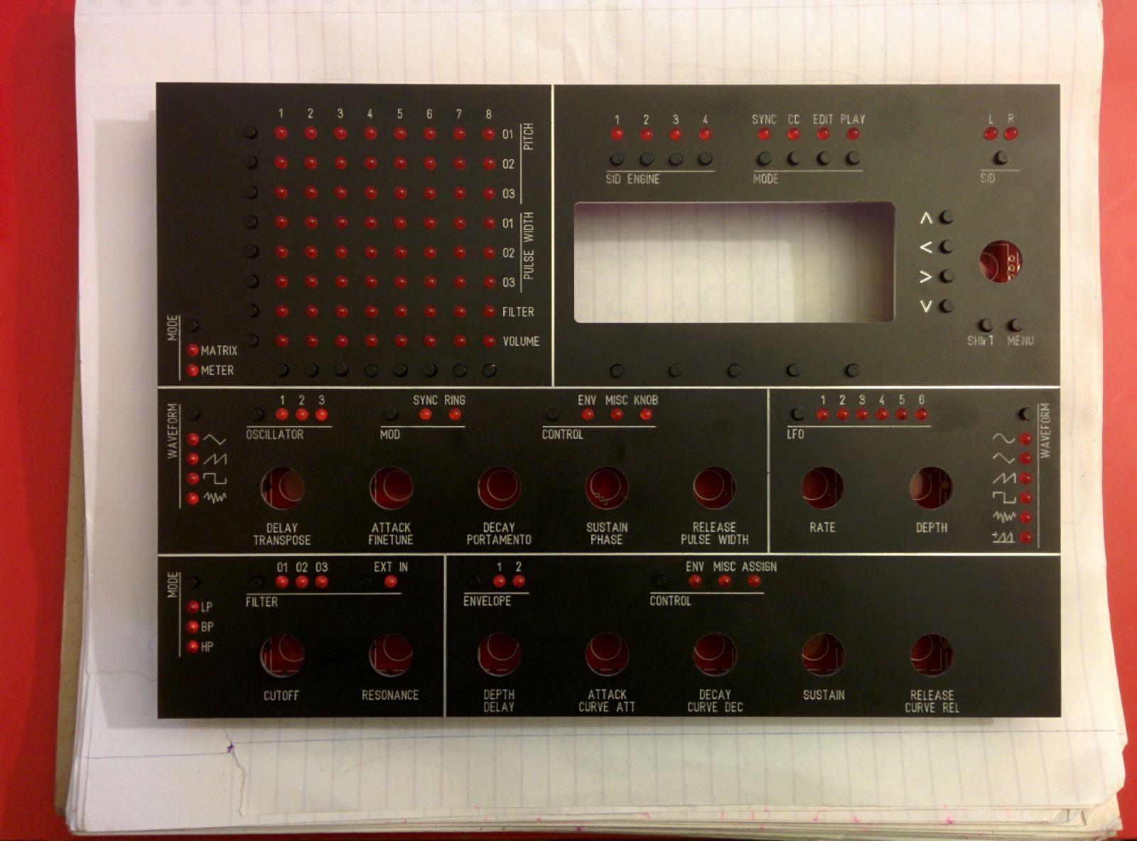

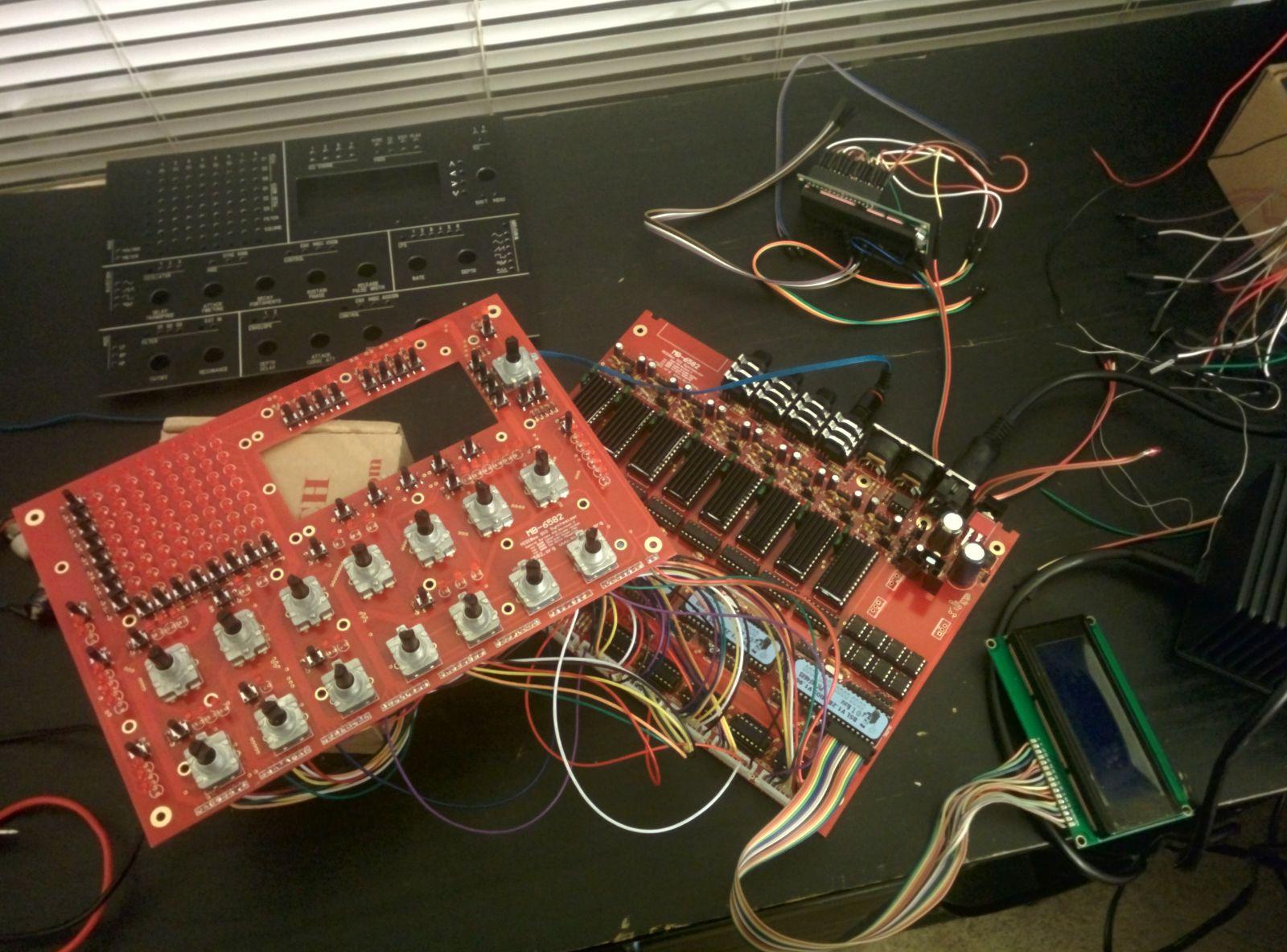

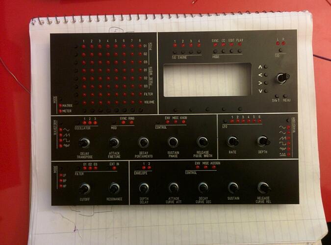

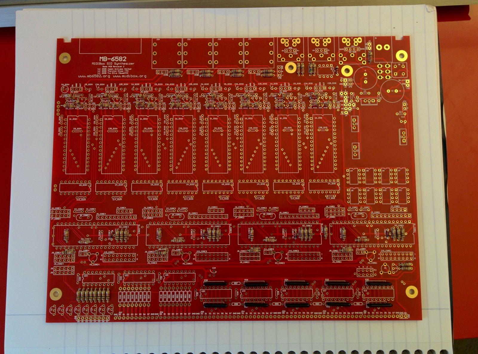

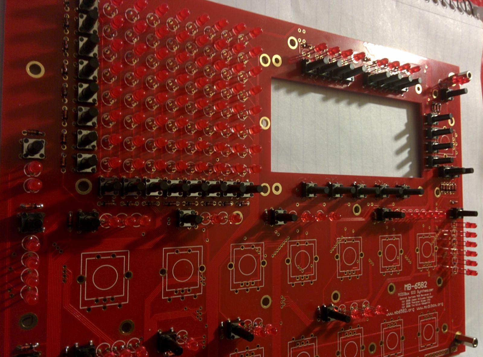

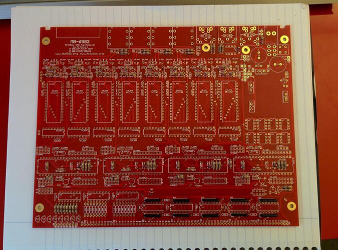

Documentation of my progress during my MB-6582 build.
2014 03 02 08.18.49
2014 03 02 08.24.29
2014 03 02 14.36.56
2014 03 02 20.51.07
2014 03 03 01.49.49
2014 03 03 04.40.01
2014 03 04 21.51.56
2014 03 05 18.56.47
2014 03 05 19.20.40
2014 03 05 20.51.01
2014 03 06 22.56.28
2014 03 13 19.47.09
2014 03 13 19.47.40
2014 03 14 21.37.28
2014 03 18 00.10.20

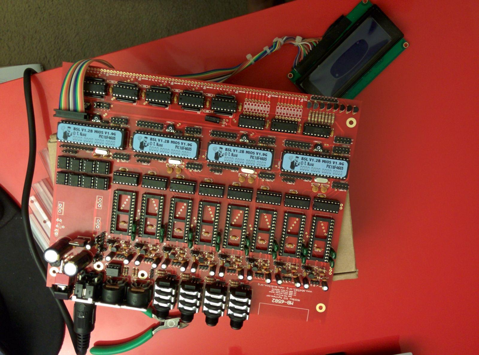

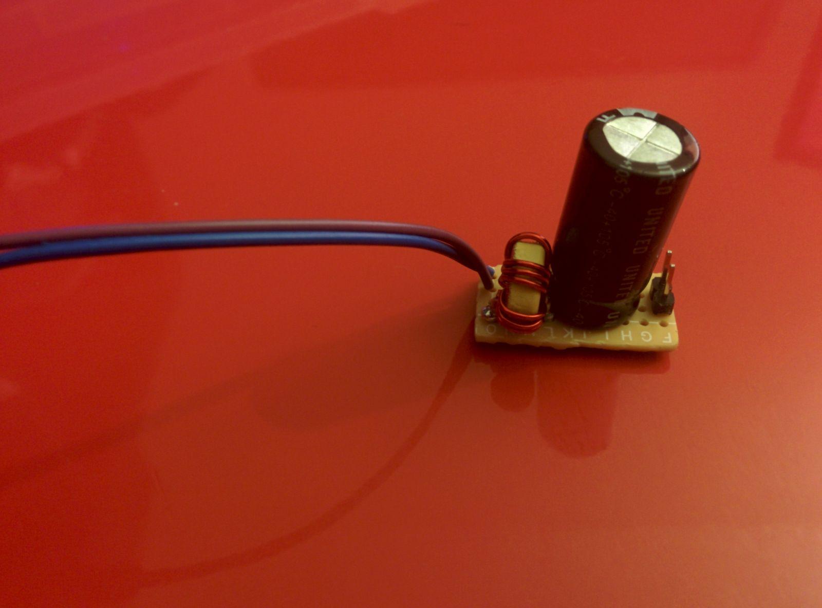

LC filter for cooling fan. This is a must have to reduce noise introduced by the fan along the 5v rail at J3.
I used this /topic/18588-mb6582-fan-noise-on-5v-rail/as?do=embed" frameborder=“0” data-embedcontent=“”> a reference to this issue.
Thanks to Hawkeye for the suggestion in the thread.
