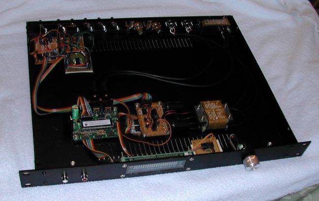

78xx series regulators (the positive ones) have the tab at ground already. So if you have a metal case, you have a great heatsink already there. Just use a bit of thermal grease to help conduct the heat.
DO NOT do this with 79 series (negative) regulators unless you get insulating hardware, as these tabs are NOT grounded.
Have Fun,
LyleHaze
P.S. the board in the middle has the regulators. If you look close, you’ll see 2 of them are bottom-mounted and screwed to the case (paint scraped way for better heat conduction)
